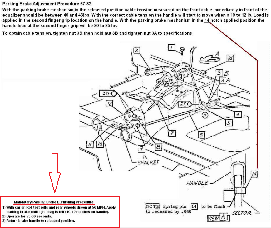

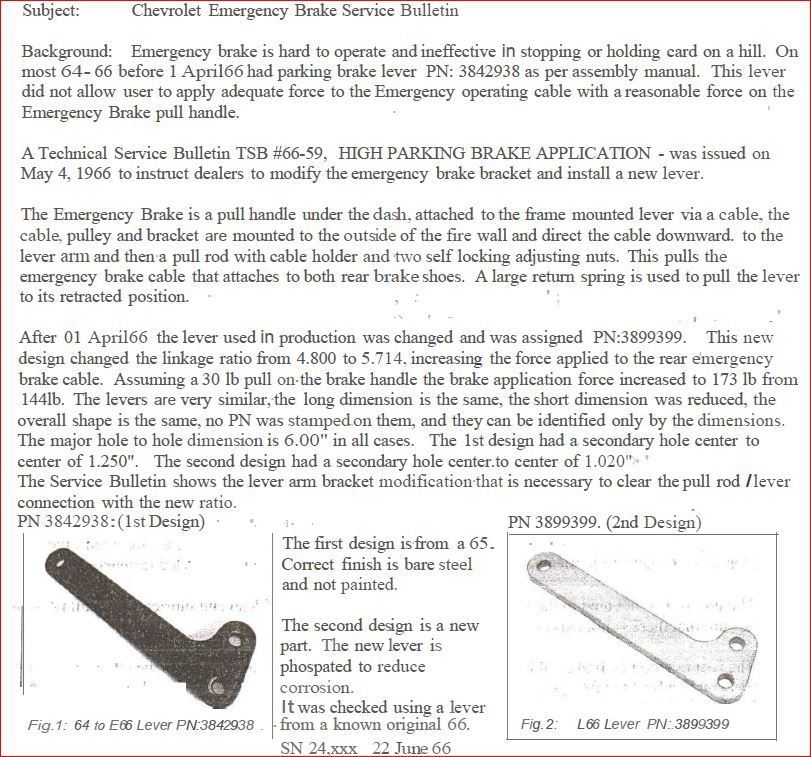

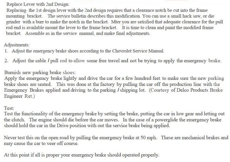

The Service Manual suggests that you tighten the shoes up until the rotor won't turn, then back off 10 notches. I just back them off until there is a slight drag as they will need to be burnished in.
And for '65 and early '66 owners, a way to improve your parking brakes holding power:
