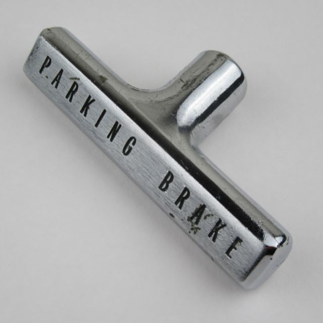

I guess that's why it doesn't say "E-brake" or emergency brake on the handle.
