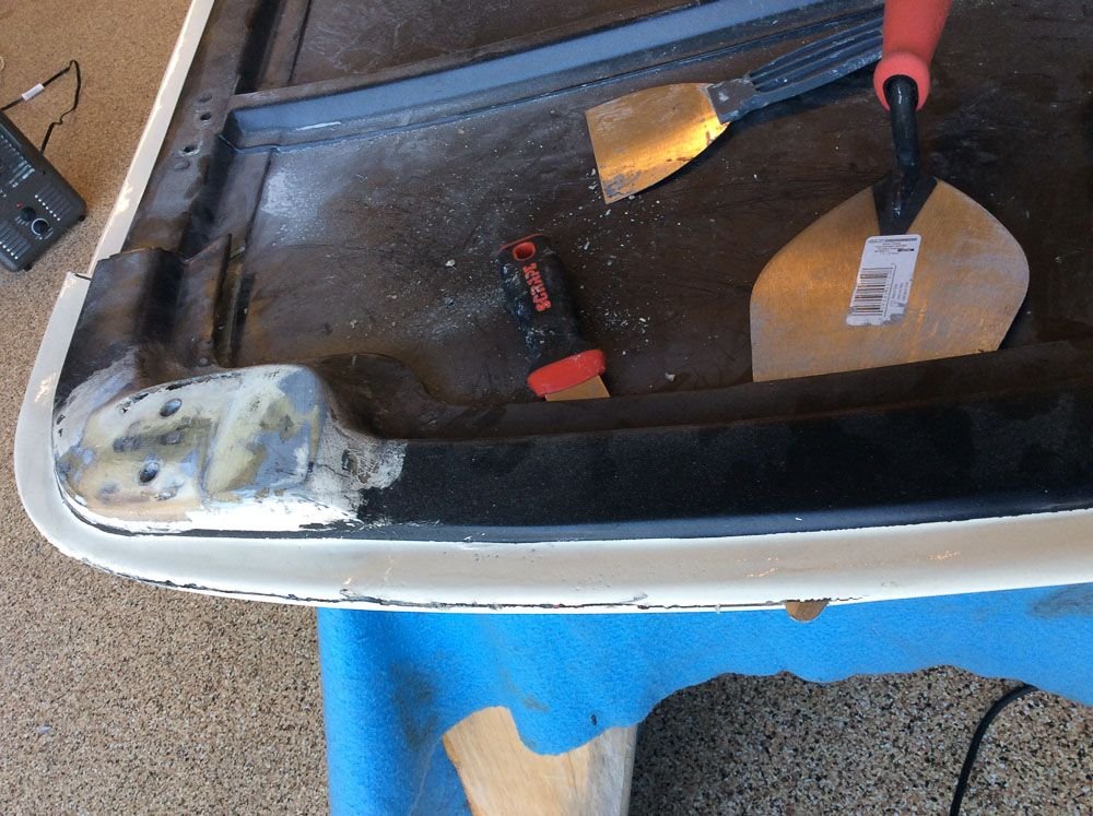

Basically, by carefully using heat and various flat tools, I separated the front of the supporting frame from the hood skin. The key was soften the bonding material with as much heat as possible without blistering the paint on the top surface of the hood. I worked small sections at a time with a heat gun, one hand feeling the temperature on the opposite side while inserting a putty knife between the frame and the outer skin. To monitor the temperature, I would remove the heat as soon as I could not comfortably keep my hand on the surface. I then I tapped the putty knife between the two layers of fiberglass. One of the more useful tools I found was a thin masonry trowel. In just over an hour I used a thin blade Dremel cutter to make end cuts and removed the frame.

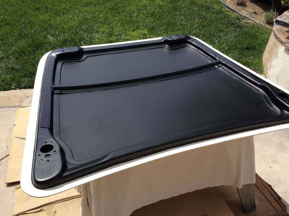

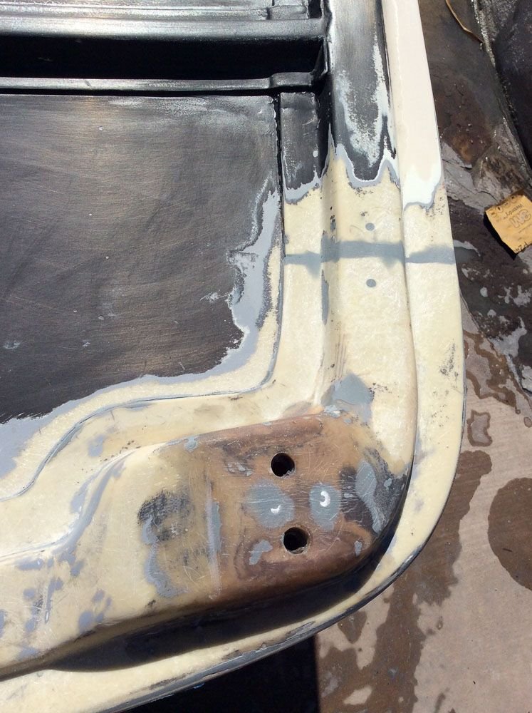

I then removed the nut plate from the inner frame, and laminated 4 layers of fiberglass cloth on the inside and two on the outside of the frame. I sanded the repair areas then riveted the nut plate back in place. I then used Vette Panel Adhesive to bond the frame back to the skin using a bonding strip at the frame joints and filling the cracks and holes with VPA.

Carefully separating the frame from the skin.
A masonry trowel worked well.
Final cut to separate the frame to be repaired.
Bonding strips were used to reinforce the joints.
Bonding the frame back in place.
Final repair before paint.
Primed.
Final result.
