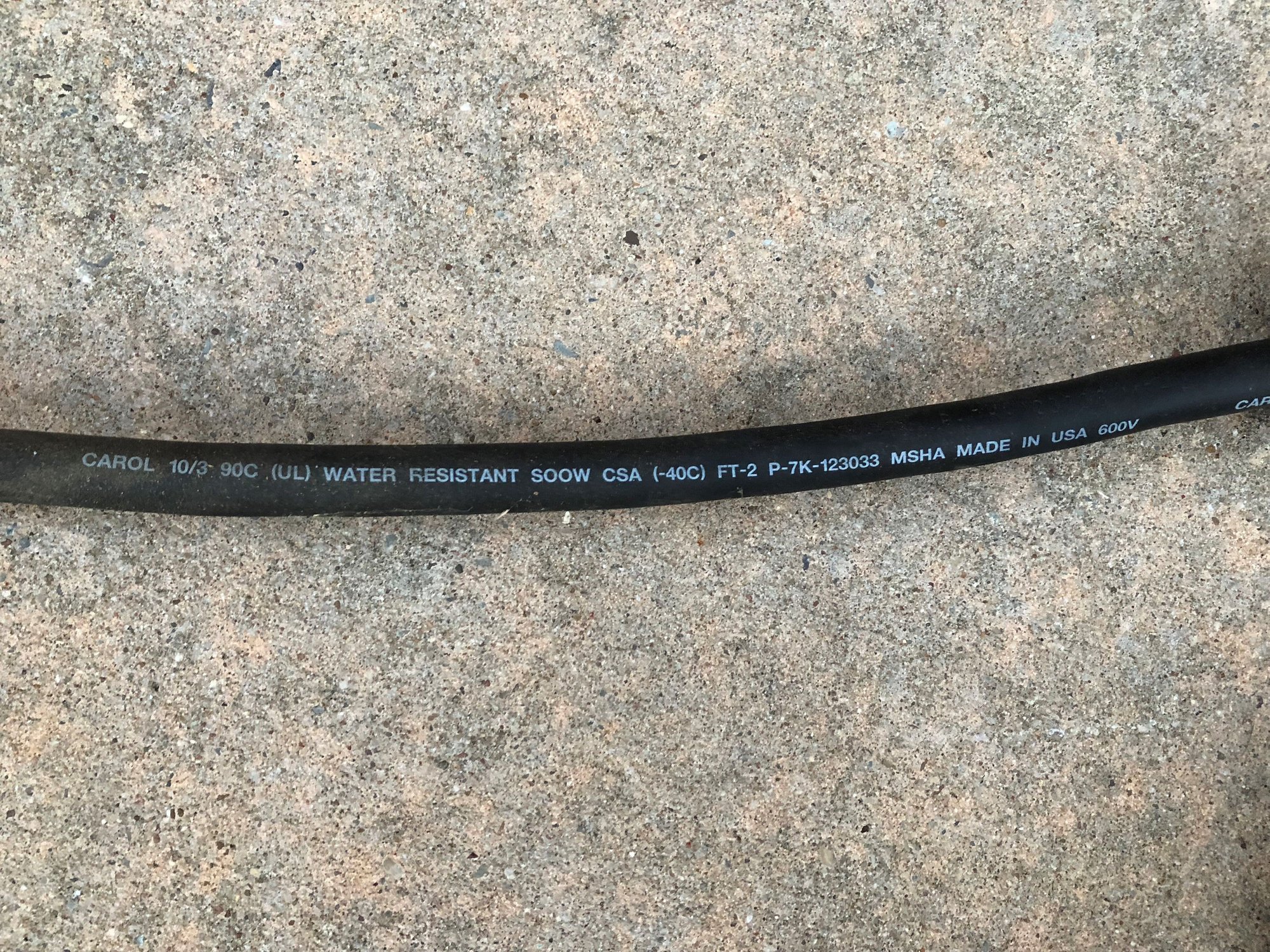

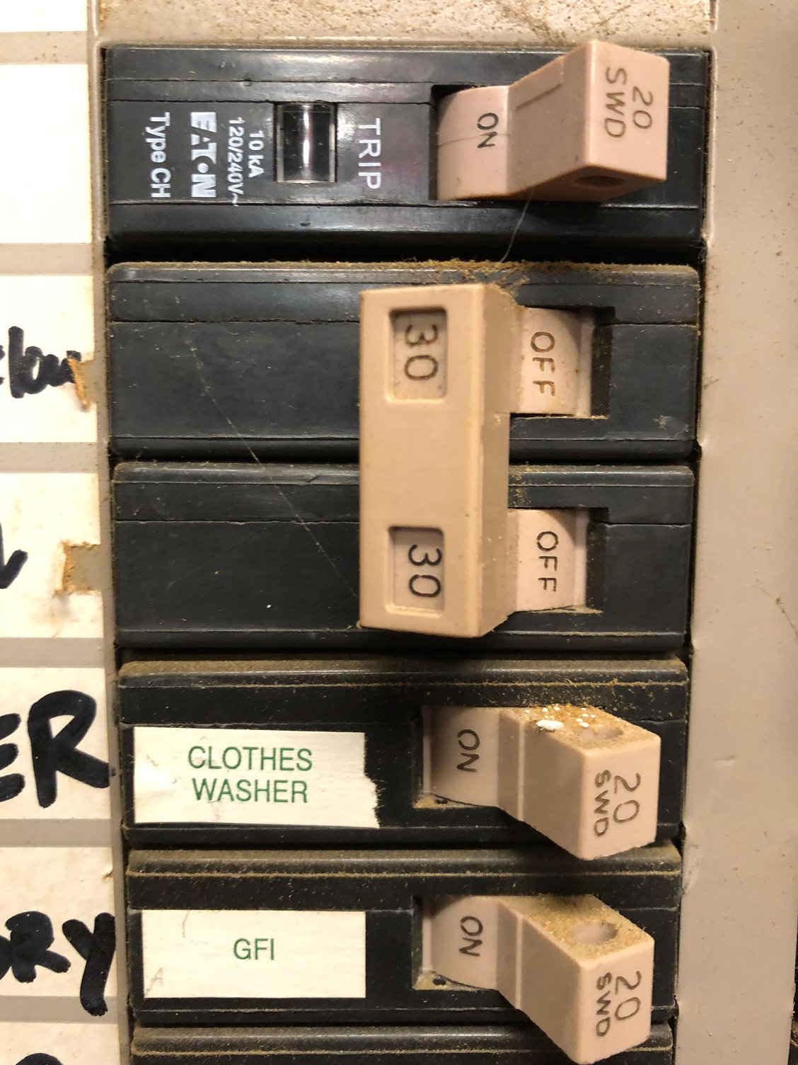

I'm looking to upgrade my air compressor as I don't think the 12 gallon will work very well for this upcoming rebuild project. I found these two at tractor supply and they are both Ingersoll Rand. The 80 gallon is made just for tractor supply according to IR's website. Is the 80 gallon worth the $200 difference. Now the most important question. Since I have to move everything around in my garage I was going to put this on a rolling stand and use my 220 connection that I had for my old Delta Unisaw. I have a 14' twist lock 10/3 extension cord I made. Can I safely run either compressor off of this chord or do I need to hardwire? Here is a pic of the breaker and cord as well as the links to the compressors. The breaker is the double 30 that is off. This would be for home use by the way.

I have a twin stage 80 gal compressor like the IR. It draws 22 amps running. The 30 amp breaker should be fine for the big twin stage 220v compressor. Keep in mind that the breaker should be sized to protect the equipment and wiring. A 25 amp would probably be better to protect the motor, but your compressor motor will come with a thermal overload to protect it and your wire is good for the 30 amp. Never put in a breaker larger than the capacity of the wire, especially for the house wiring in the wall.
Your wire is 3 conductor #10 awg SO cord. It should be good for 30 amps depending on the length. See http://www.usawire-cable.com/pdfs/nec%20ampacities.pdf for NEC capacities. The 3 conductor cord should have 4 wires, red, white, and black with a smaller green wire for the equipment ground. You need to check the wiring diagram for the compressor to see if you need the equipment ground, I recommend it as a safety concern.
The cord caps, ends on the cord are only 20 amp and should not be used with a 22 amp draw. You have to look at the wiring diagram to see what you need. I ran 10/3 with ground to my compressor, but I cannot remember if the safety ground was needed.

As R66 says the wire is ok but your plugs are too small. And you need to know what size wire is in the wall. As he told you the breaker is only to protect the wiring. If you have too small of wire and too big a breaker your wire just becomes a fuseable link, not good. If you look at your dryer plug it more than likely is a 3 prong plug. For years everything 220 has had 3 prongs. I just wired in a heater at my buddies shop over the winter and it had a 4 prong connector. I called the electrician that wired his shop to see why. I used the 2 hot legs and the neutral and went on. If you have 8 wire in the wall I would use a 40 amp breaker. All of this is JMO.
