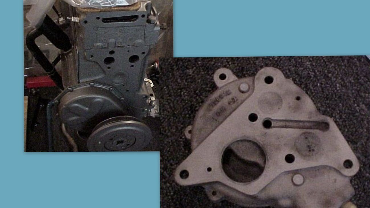

Old Jun 19, 2018 | 07:33 PM
1955 copper's Avatar
1955 copper
Joined: Jul 2006
Posts: 4,606
Likes: 210
From: Nevada City Ca.
2015 C1 of Year
Pic on right Corvette pump spacer large hole is open , engine on left Corvette engine has to remove that freeze plug or engine will get hot . So take the freeze plug out if a Corvette engine
Removing the water pump only you can see if it's in or out of the engine

I was looking at old posts and I think I have a car in the shop with this same issue. ( I didnt restore it )
Funny - this photo is from my engine in my 54 - this is an engine I built in my fathers barn
Just a helpful hint
The big plug MUST be removed for 53 54 Corvette - If not - the car will NEVER cool - NEVER
