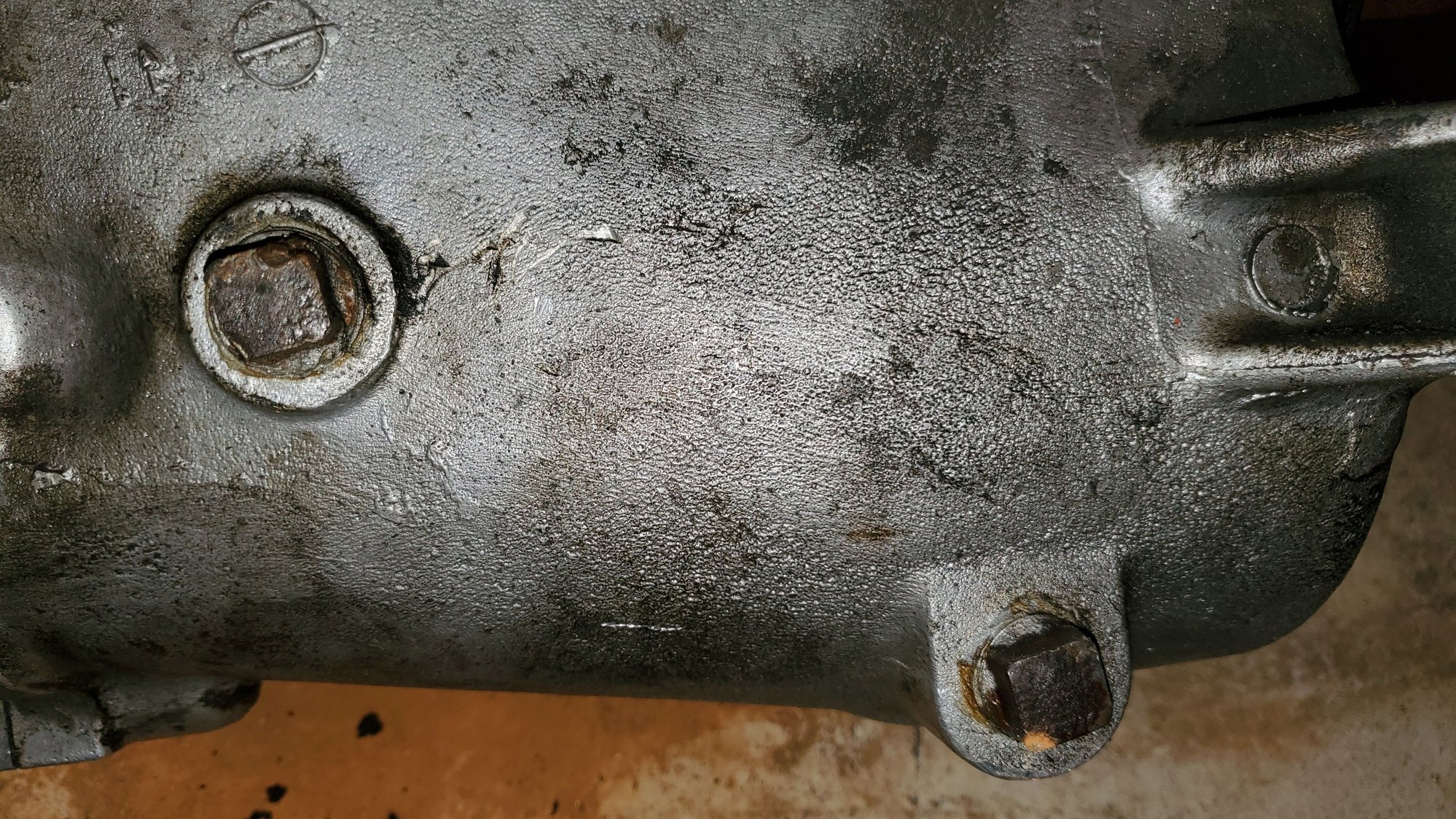

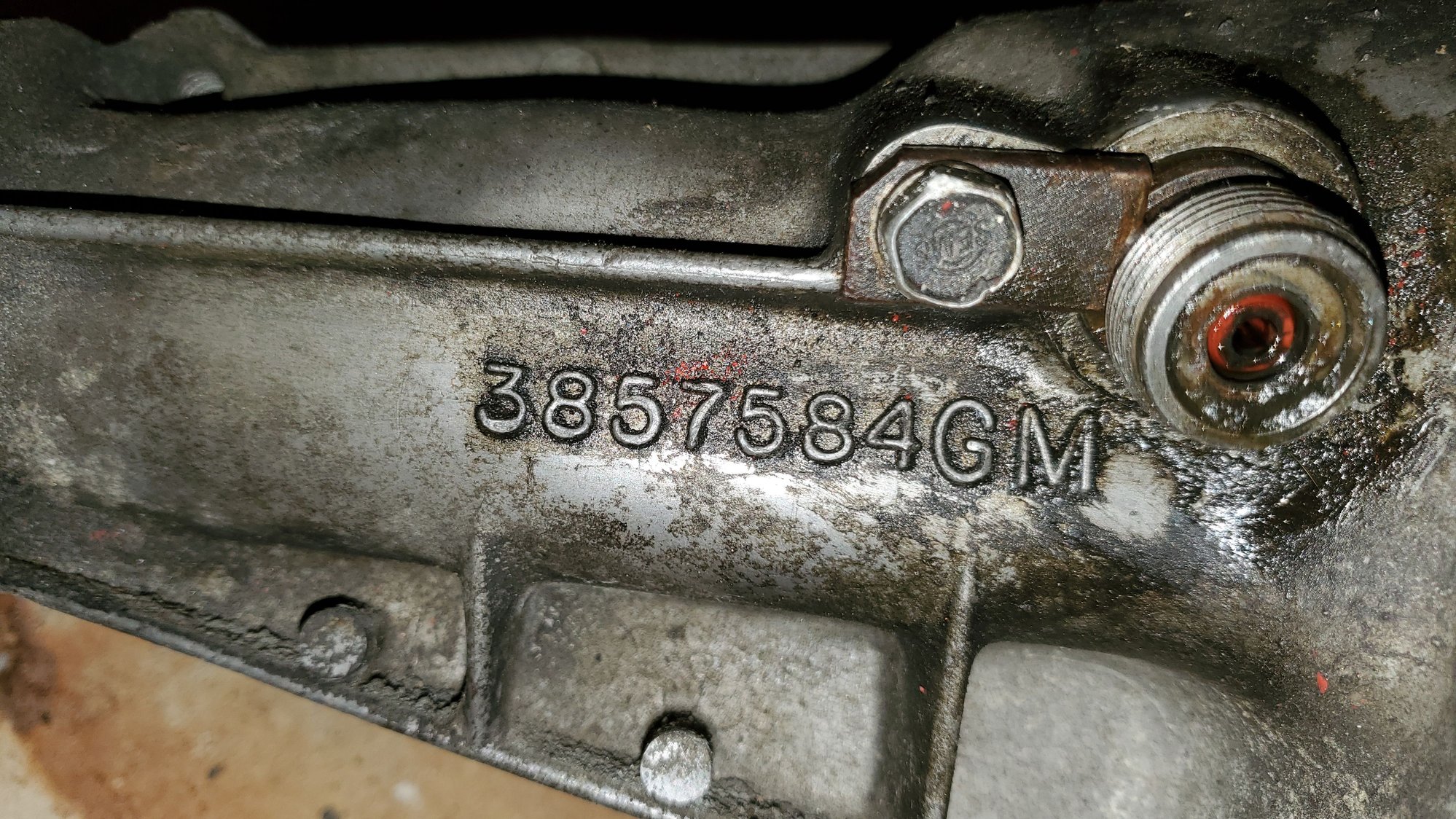

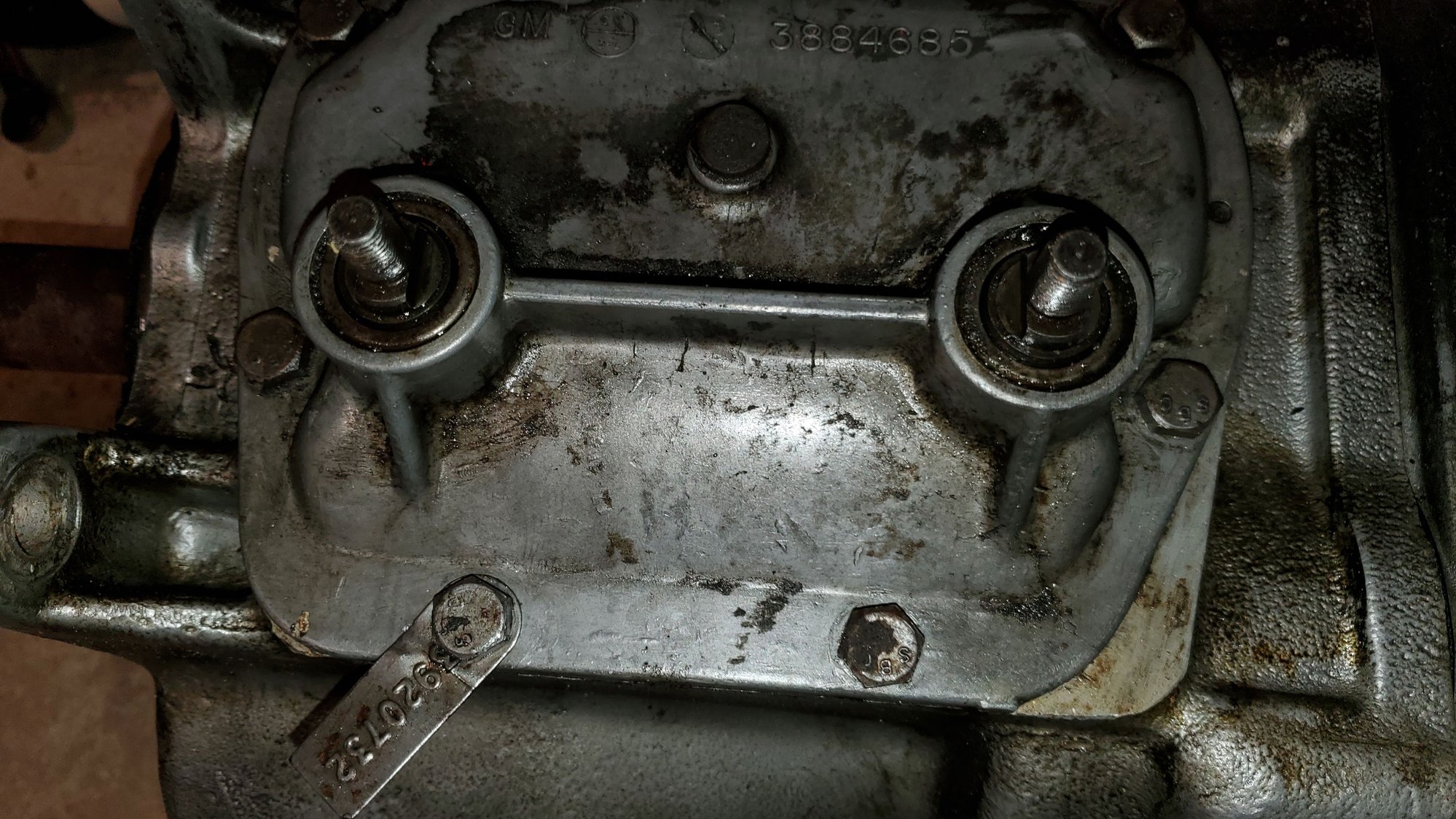

When I bought my 1967 Corvette it had a Muncie transmission and 411/410 gears. Replaced with a TKO 500 and 3.55 gears.
This Muncie has been in my basement for several years, and have decided to try and sell. Please excuse the oil mess, plan to clean asap.
Info:

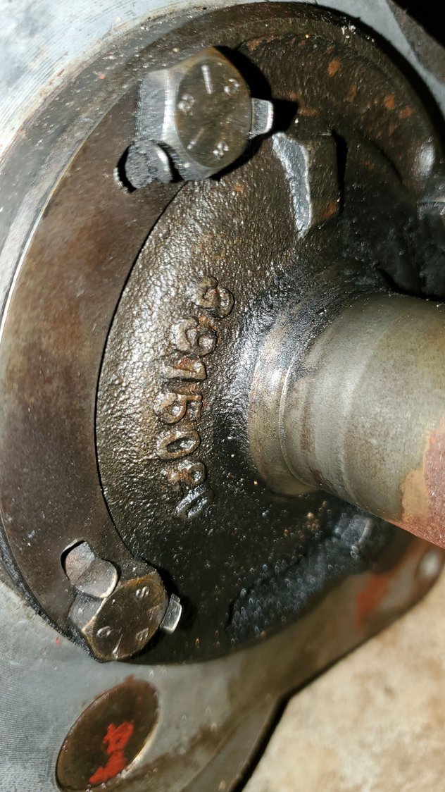

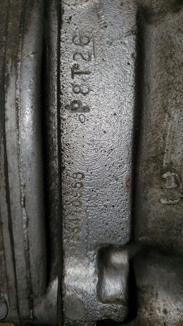

P8T26 12/26/67
Side cover: 3884685
Tail shaft housing: 3857584
Input bearing retainer: 3915020
Patent: 3088336
GM casting 3925660
Metal tag 3920732

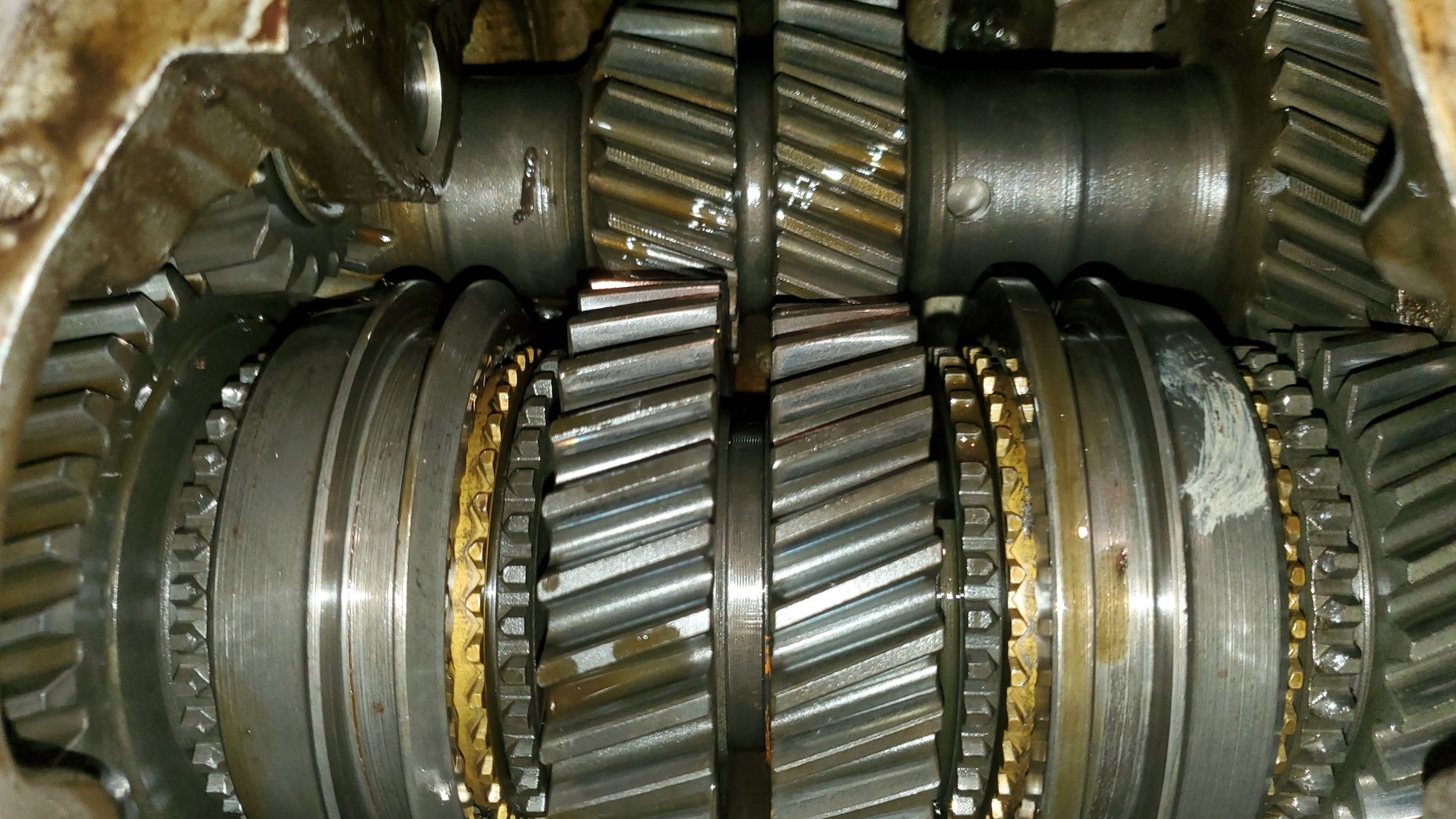

Removed cover and inspected gears and they are M22's
Next to the P8T26 is a vin# 18S40958
Looked at Vin decoding websites, and cant figure out the second digit.
Don't know if it is appropriate to ask about a selling price...if possible would like some opinions
Thanks in advance for your replies.

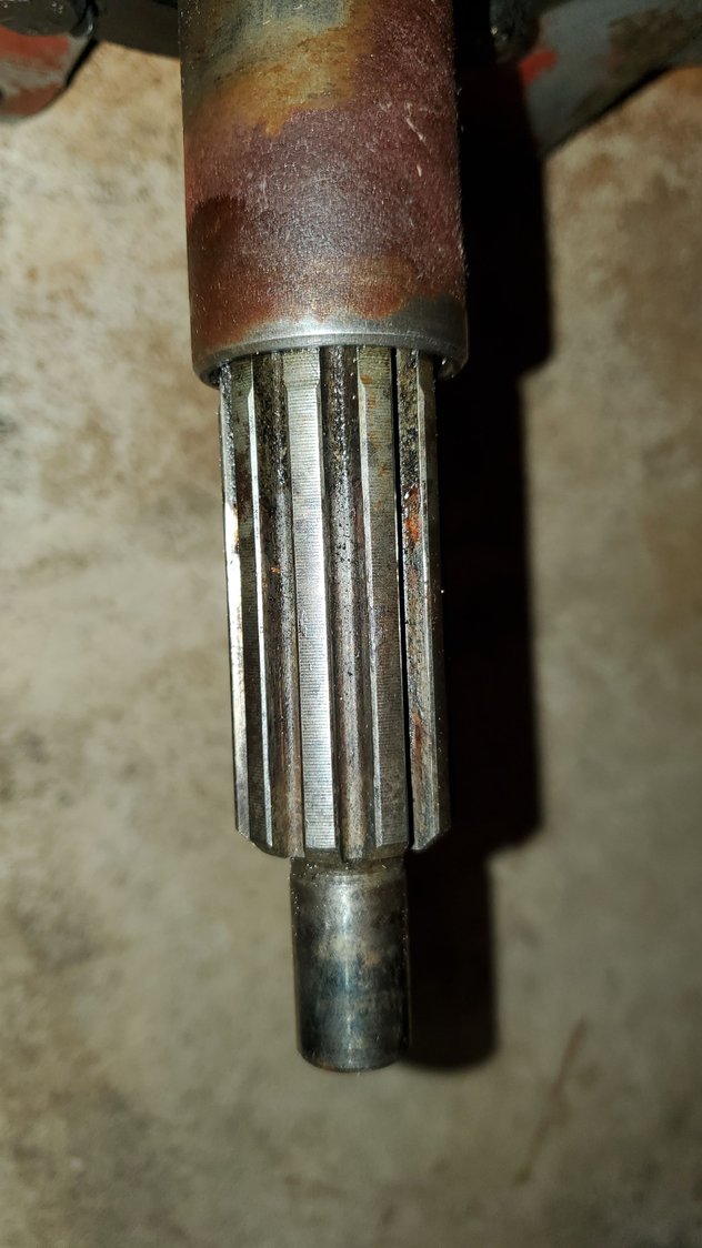

IF THAT IS AN ORIGINAL, UNTOUCHED, VIRGIN Muncie, The presence of a drain plug and NO grooves on the input shaft, are indicators of an M22.

Take the side cover off and take a picture of the gears. If it's an M22 the price goes way up.

The second digit? The 8 is for the model year in both stampings if that’s what you’re asking. So would be model year 1968.Like stated already you gotta pull the cover to see the angle on the gears to tell for sure, there are a lot of input shafts out there without the rings for M20/21.

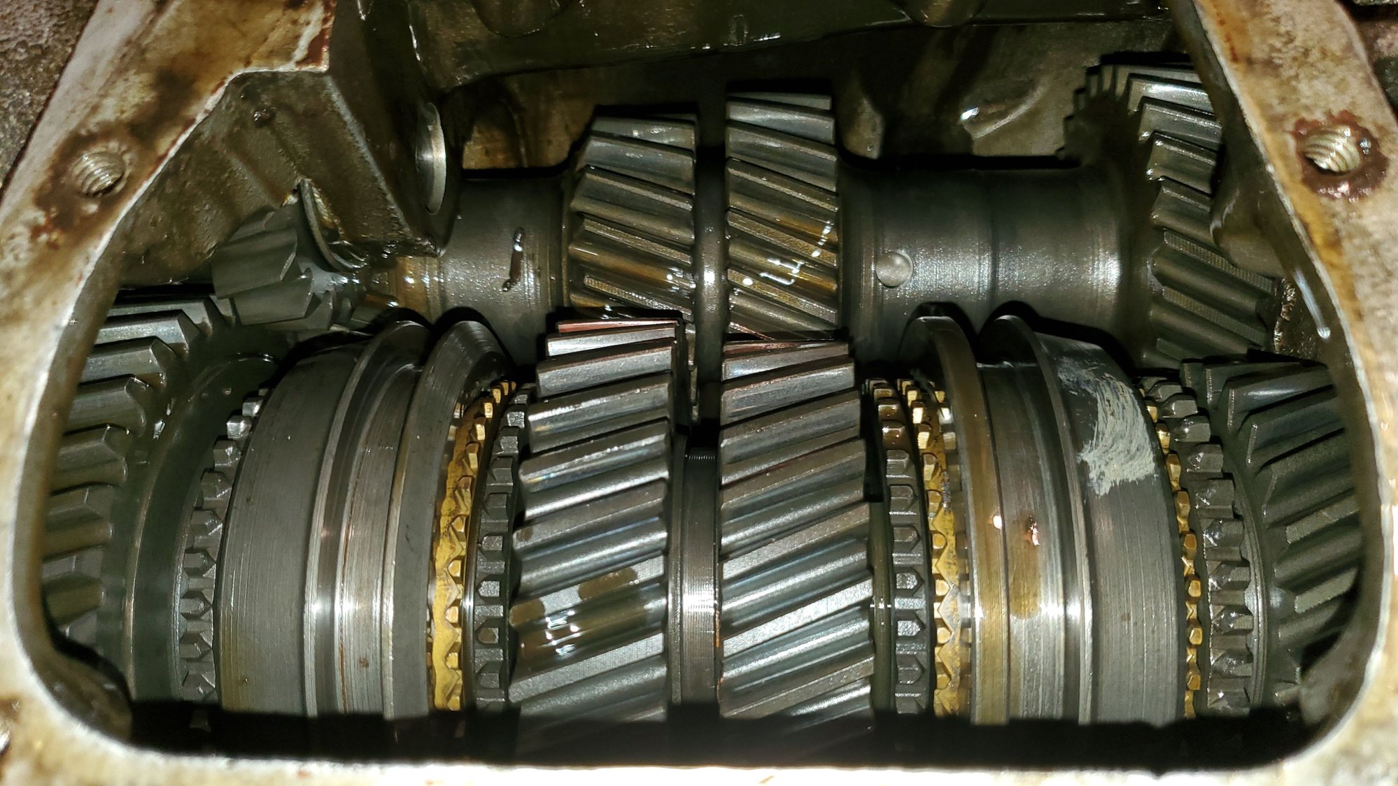

I took the cover off and compared to pictures on this forum. They are not as slanted as the M20/21. Will post picture after cleanup and cover comes off again

Originally Posted by I'minheaven67
That's like hearing the bells and sirens when you hit the Jackpot........
Doubt if it's untouched...Opps looking the wrong way... Sorry. Second and third gear look pretty new from the angle of the picture... Input looks like a worn original

12 67 would be from a 1968, as said.

I would say that 3rd gear looks the best with the exception of 1st. The engagement teeth are pretty nice with the "tent" pretty much intact. 4th looks pretty chewed up.

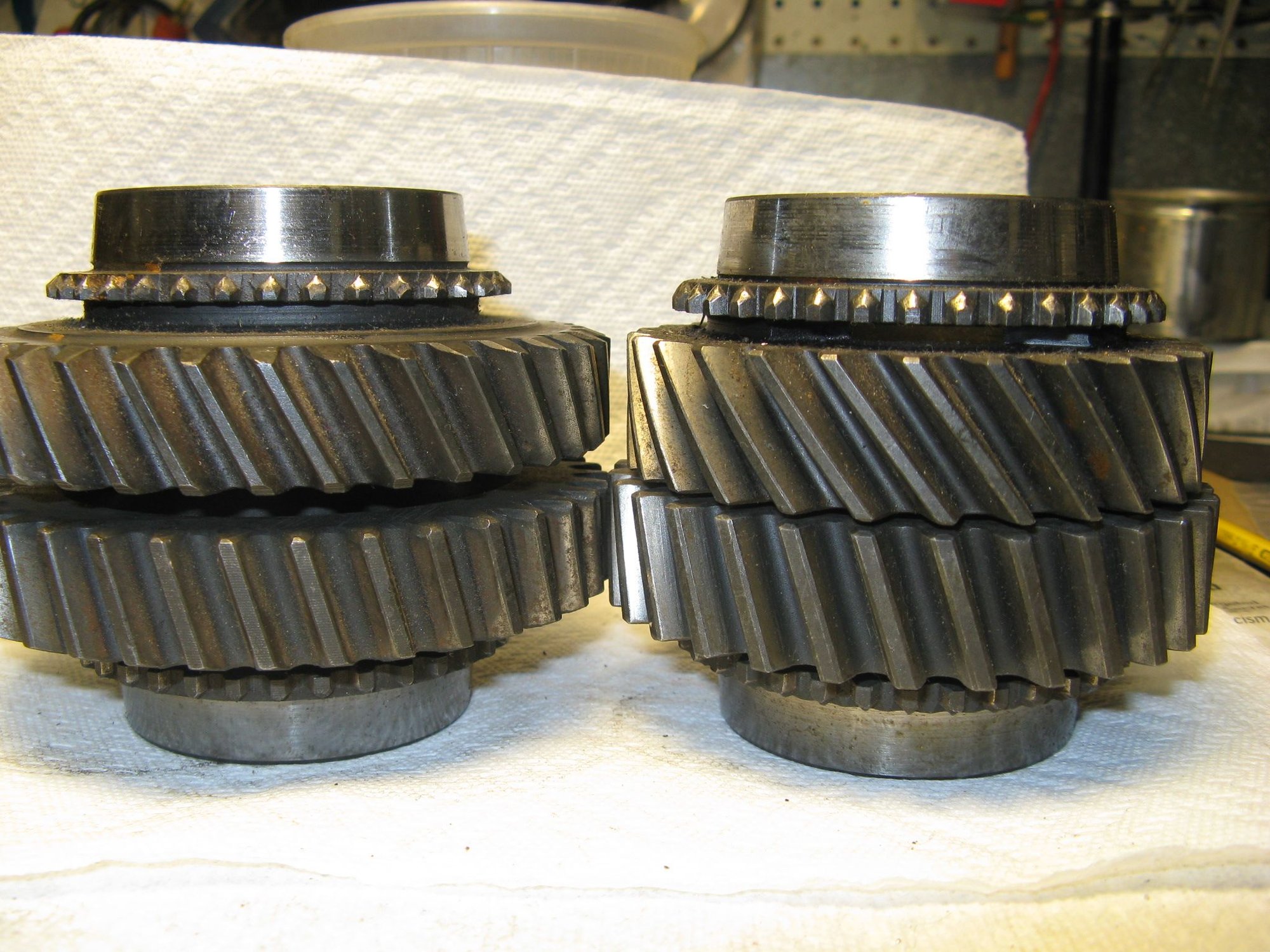

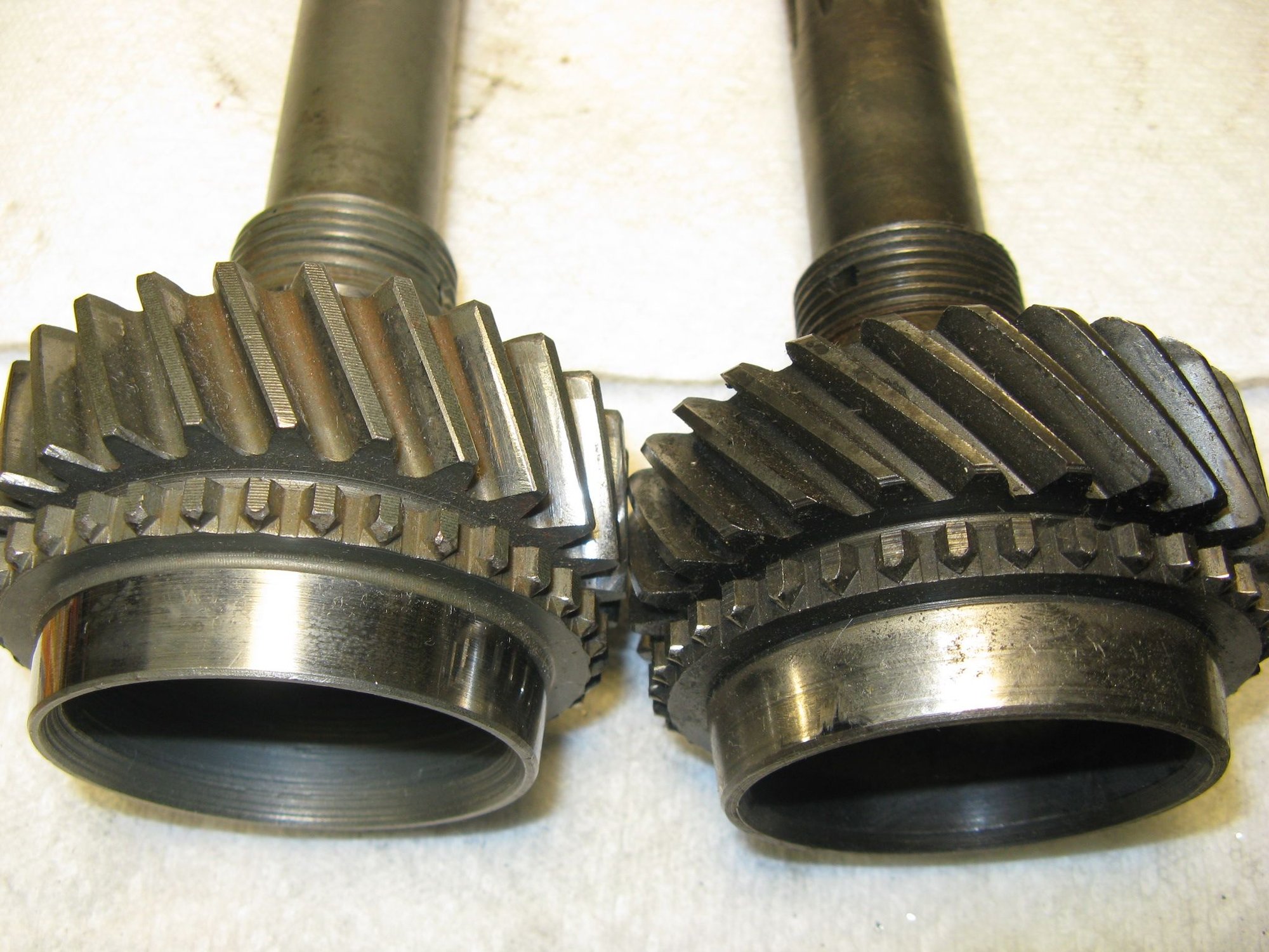

Here are comparisons of an M20/21 and a M22 gears.
The M22 gears are on the bottom.
Joe
The M22 is on the left:

A 21 degree helix on the M22?
Old Oct 1, 2021 | 05:26 AM
Russco's Avatar
Russco
Joined: Sep 2021
Posts: 32
Likes: 15
Helix angle should be 20* for M22. They don’t seem to be bringing as much as they used to since the popularity of the TKO’s and other newer better trannys. (In my circles anyway) I think right now Autogear is out of the gears and parts they normally sell to replace the bad ones with. And
many people that were paying the big money for them can buy a new auto gear super case M22.

If it is a real 68 corvette M 22 try to find the car it came from by using the Vin number on the trans. All m 22’s had drain plugs. $$$
