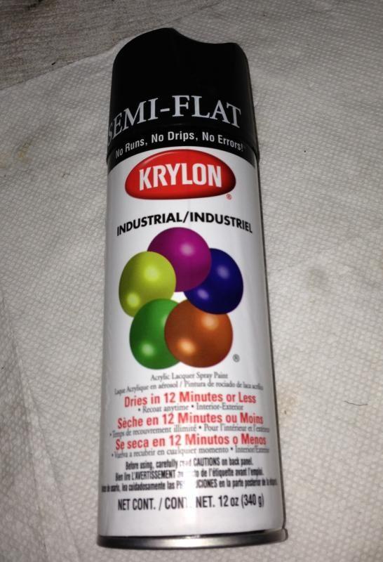

I have had good results using Krylon #1613 semi-flat black "Industrial/Industriel" marked on can. You will need to buy from an on-line supplier such as Amazon or an industrial equipment supplier. It is a lacquer base paint that you can apply in multi coats. Don't be fooled by the Krylon #51613 satin black "Indoor/Outdoor" readily available at the big box stores, it is not the same product as #1613! The 51613 will "alligator" with multi coats.

You DON'T want semi-gloss black - you want a semi-flat black that dries to an "eggshell" surface, and you don't want the ENAMEL you're using. You want a lacquer like SEM Trim Black or Krylon #1513 Industrial 5-Ball Semi-Flat.

wow. Never knew there was a difference in semi gloss and semi flat. Learn something every day. So, you are saying the krylon semi flat is a lacquer paint, not an enamel? Thanks.
