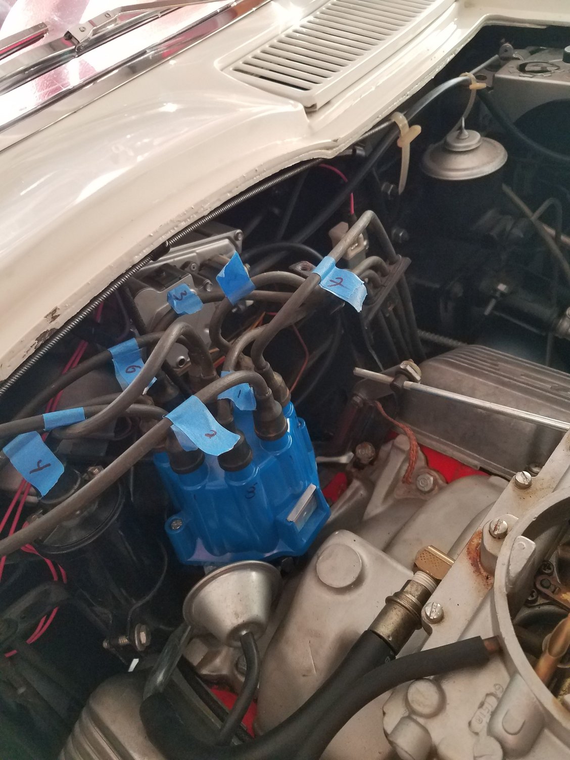

Quote: Your distributor isn't installed correctly. Is the engine timed correctly? Vacuum advance aside?
All the bench racing rhetoric aside, I don’t understand this comment?
How is it not installed correctly? It looks fine to me and I don’t see how you can tell from this simple picture. I also have heard a couple of people on other threads say their distributor was installed “off a tooth”, yet they have a carb and distributor controlled ignition. There is no such thing. If you fully meshed the distributor gear to the cam gear and then turned the distributor body to set base timing you are done. Yes, you might want to install it in a way that allows the vacuum canister to clear the carb etc. to give yourself plenty of room for tuning, but there is no such thing s being off a tooth in a non-computer controlled engine.
To the OPs question, engine timing and the advance curve are comprised of three components: base timing, mechanical advance, and vacuum advance. The interaction of these three components at every rpm and engine load determines your engine timing at that point. By the way, the more radical your cam in terms of duration and overlap the more concerned you have to be about these factors. Some people remove vacuum advance thinking a “race” engine doesn’t need it. The reality is that full race engines typically don’t use it simply because it is one more thing to break and often the radical nature of the engine provides little vacuum at idle and wot where the engine spends most of its time. Assuming a cam that is not too radical for the street, your carb can be tuned. While I prefer a Holley, my C1 has two Edelbrocks on a built 350 that perform well. You can tune out that stumble, but you need to ensure that all engine components are working correctly.
...... but there is no such thing s being off a tooth in a non-computer controlled engine.
Wanna' bet? How about a half tooth off?

Quote: I'm getting some slight hesitation off the line and some popping thru the exhaust. I've been told by 2 different mechanics that my '64 327-300, manual trans should be receiving vacuum from the manifold, not the carb (as I have it). Is this true? If so, is this where the vacuum connects? (see pic below). Thanks for the input and have a safe and happy 4th.
I have a hole like this also...does that go through to the manifold as a hole, or is it a mounting post? Because I do not have a plug in it...but never thought it would lead all the way through.

Quote: I have a hole like this also...does that go through to the manifold as a hole, or is it a mounting post? Because I do not have a plug in it...but never thought it would lead all the way through.
Yes, that hole for the vacuum fitting goes right into the runner in the intake manifold; if it isn't plugged or the fitting in it isn't plugged or capped, you'll have a MASSIVE vacuum leak - I'd be surprised if it ran at all.
Is this a picture of your engine you posted in another thread?

Quote: Is this a picture of your engine you posted in another thread?
Yup, that is me. Let me take a look at that hole again. The car runs, just not 100%. I would be shocked in the distributor was in wrong, but I am a little knew to this.

Quote: Yup, that is me. Let me take a look at that hole again. The car runs, just not 100%. I would be shocked in the distributor was in wrong, but I am a little new
to this.
I just picked up on this. That was the old picture. Indeed the distributor was in wrong. Here is the updated picture with the distributor fixed.
