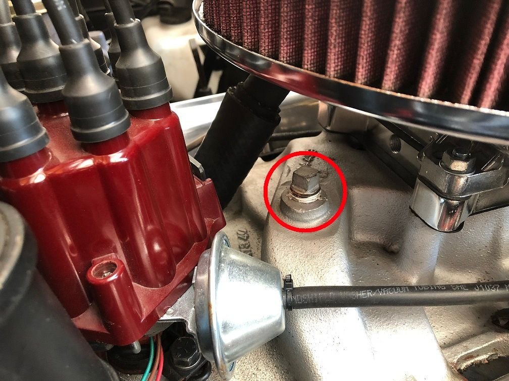

I'm getting some slight hesitation off the line and some popping thru the exhaust. I've been told by 2 different mechanics that my '64 327-300, manual trans should be receiving vacuum from the manifold, not the carb (as I have it). Is this true? If so, is this where the vacuum connects? (see pic below). Thanks for the input and have a safe and happy 4th.

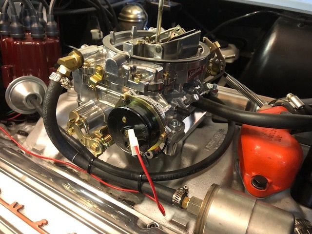

If you're drawing vacuum from below the carb's throttle plates (e.g. the carb's base) that IS full manifold vacuum...you don't show a picture of the carb...
There are 1/2 dozen reasons for your symptoms. Vacuum advance's chief benefit is at cruise - you can plug the vacuum source and drive the car and see if you get the same symptoms...

I have a general question. Is the tapped hole in your carb spacer plugged? It appears from the photo it is open which would be one hell of a vacuum leak.
I saw that but I assumed the car would run so damn bad with that hole wide open to the atmosphere it'd be obvious -- maybe I shouldn't have...

interesting hose clamp on the vac can.
It's closed inside, you just can't see it. Thanks.

Full manifold vacuum is the same weather the connection is where you have circled or from below the carburetor throttle blades. Frank's suggestion to show a picture of the distributor vacuum advance hose connection at the carburetor should help clear things up.
If it's not hard to do try it without the spacer under the carburetor first, if it needs more fuel post the carburetor model number and someone may have the specs.

even if you take vacuum from the carb, it could be full vacuum (as opposed to ported vacuum) depending on where you hook it up. I always use full vacuum, and most would recommend that for good idle.
On my Holley 4160 it required many parameters to be aligned for smooth performance: timing, distributor springs, vacuum can type, idle screws, accelerator pump cam, nozzle, jets...
In my (modest) experience, solving a problem is not a 'one thing solves all' type of process. It requires many tweaks to gradually move forward. Where I live there is little knowledge about these carbs so I had to learn it myself. In the US there is plenty, but still worth trying to find a really experienced and knowledgeable mechanic. The fact that your's recommend to hook it up to the manifold rather than simply to the full vacuum nipple on the carb (if available) makes me wonder though...The plastic tie wrap on the vacuum line is not a good idea neither, the interior of the 'wrap' is not a circle and may cause leaks rather than avoid them....
A picture and type of carb could help.

In brief -- PORTED vacuum is ABOVE the throttle plates so there is NO vacuum assisting the idle since the throttle plates are closed - this is a throwback to emissions days and a contrivance to reduce harmful effects to the atmosphere -- not needed now with all fuel injection motors and it "detuned" engines. Once the throttle plates open up by depressing the gas pedal full manifold vacuum is available.
FULL manifold vacuum gives maximum benefit at idle and cruise and is taken off below the throttle plates -- it results in cooler running/idle, smoother performance, better mileage, etc..

If you put a vacuum gauge on that fitting and have 18"-21" vacuum at curb idle its full vacuum - and what you want...
If you don't have a vacuum gauge a dirty check is to disconnect the vacuum hose and if the idle drops its full vacuum - but the gauge is better...
Not a fan of rubber fuel lines over that hot aluminum manifold -- my friend...

The vacuum advance is connected to the full manifold vacuum port on that Edelbrock.

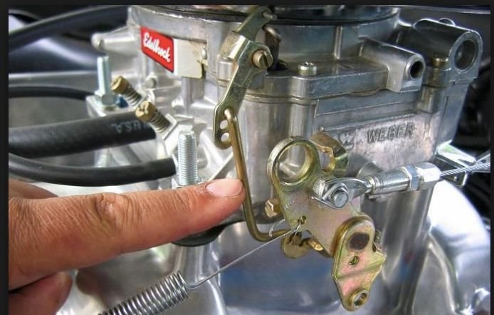

Mikey, there is a good article about the operation&tuning of an edelbrock here http://www.telusplanet.net/public/gi...delbrock_1.htm.
The 1406 is jetted/rodded very lean (compared to a 1405, marketed as 'identical' to the 1406 but without choke). I remember I had to set jets and rods like for a 1405 to have my crate 350 run fine. But that may just be my configuration.
If you want to try out something easier first, having the acceleration pump inject more fuel is easy to do yourself. A stumble can mean a lean condition, so this could help. Put the lever as in this picture for maximum fuel. and see how it goes. It's where I had put mine. But again, that 's more trial and error than wisdom. I do carb tuning using a Air/Fuel ratio sensor. Those things don't lie and cover up for my lack of 'gut feel seat in the pants' experience By the way, the smaller hose just above his finger is the manifold vacuum where your distributor advance is supposed to go.
