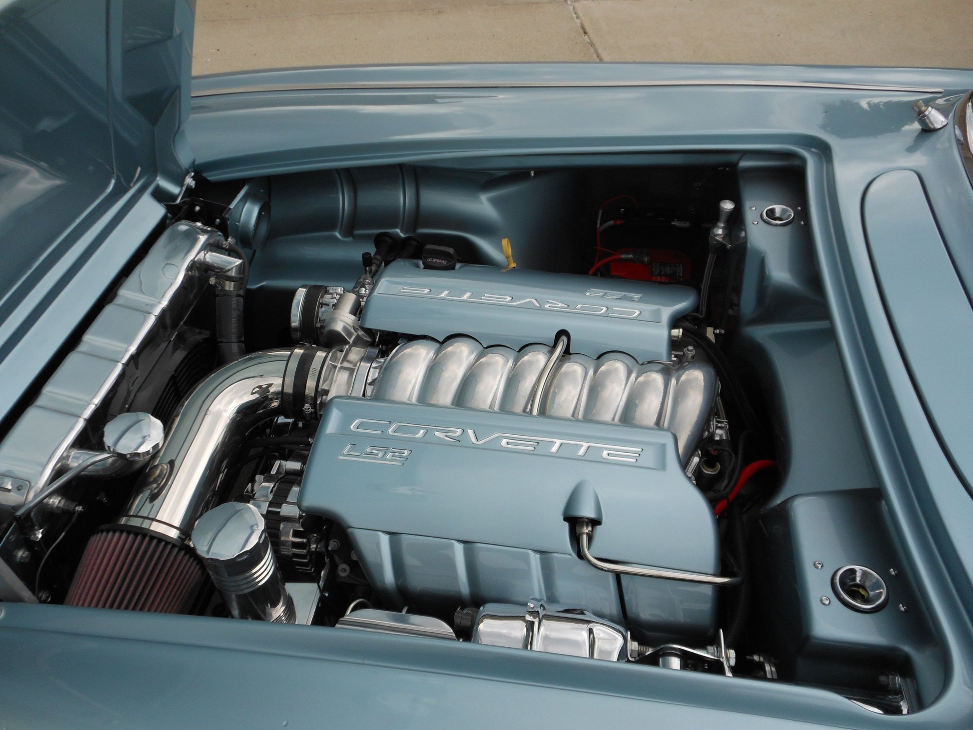

I used Billy Dawson's frame on my 1960. I mated up 1996 Corvette suspension. Unfortunately, I don't have any chassis photos on this laptop. Call Billy. He is supposed to be at Carlisle. I hope all is well with him.
LS2 with 4L70E My favorite car I ve done. Talk to Mike Colletta. I believe he's done over 25 to date.
