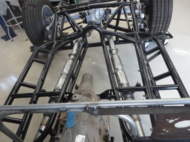

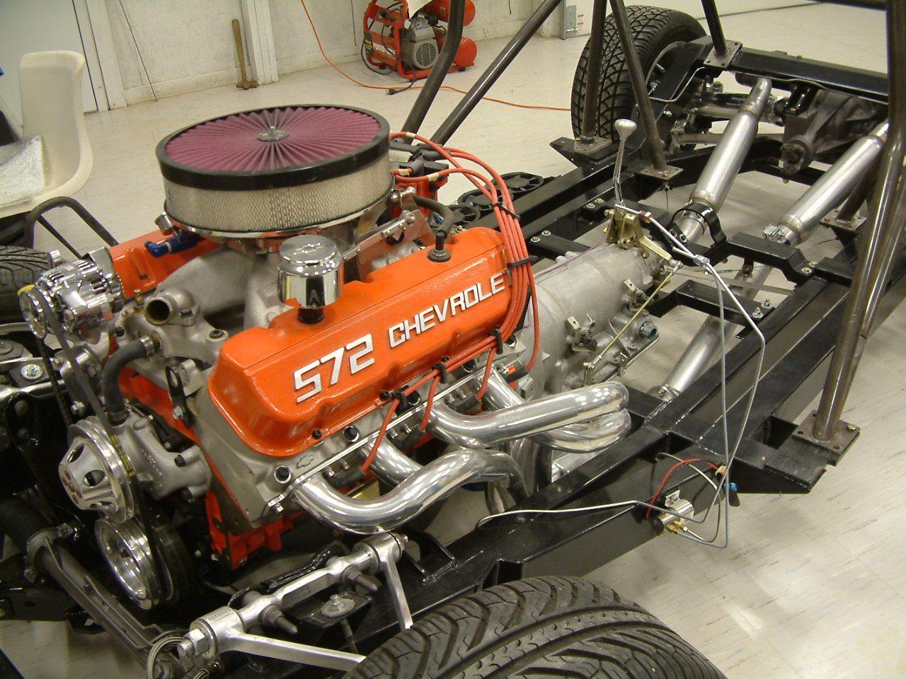

First pic is body mounted on Billy's frame/chassis before the engine install...and second pic is the beginning of the project.
The Correction Correction frame is a class act in every way...my favorite choice for sure. Unbeatable customer support..on top of that Billy Dawson is an extraordinary guy.
