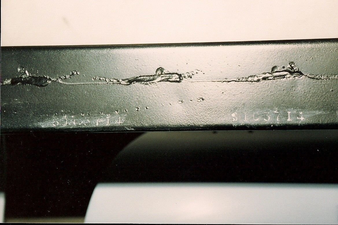

The VIN is stamped on the top of the frame approx. where your left hip would be while sitting in the car.

Original VIN numbers for 59s are in the following configuration
J59S10 with 6 sequential numbers starting at 000001. J= Corvette, 59 model year, S = St Louis
OR20xxx could be a state issued VIN.
If your car has the original frame the factory VIN was stamped on the upper driver side rail at approximately where your back pants pocket is located when seated.

I am on my second 61 bought out of state and had to expose the VIN on the frame so the Highway Patrol could verify it for a Missouri title. The first 61' I pulled out the driver seat and cut a 4" x 12" hole in floor right under left pants pocket location and it was there. The 61' I have this time , done the same thing , same location - NOT THERE ! I tried cleaning chassis forward and rear of that location with wire wheel on angle grinder , could not locate . Pulled body off and found it next to left front driver seat mounting bolt . Guess it depends on the individual stamping the chassis.

On my ‘58, after some bodily gymnastics, I was able to place a small mirror in various places along the inside of the frame rail, flood the area with light and take a bunch of pictures of the mirror image. I actually wound up with a few very nice photos verifying the VIN. It was almost dead center under the drivers seat area. You’re right, it likely depends on what kind of day the worker was having.

get a small adjustable dental mirror, lil flashlight, lots of rags and cleaning stuff. If that area is clean, it will be easier to see..
