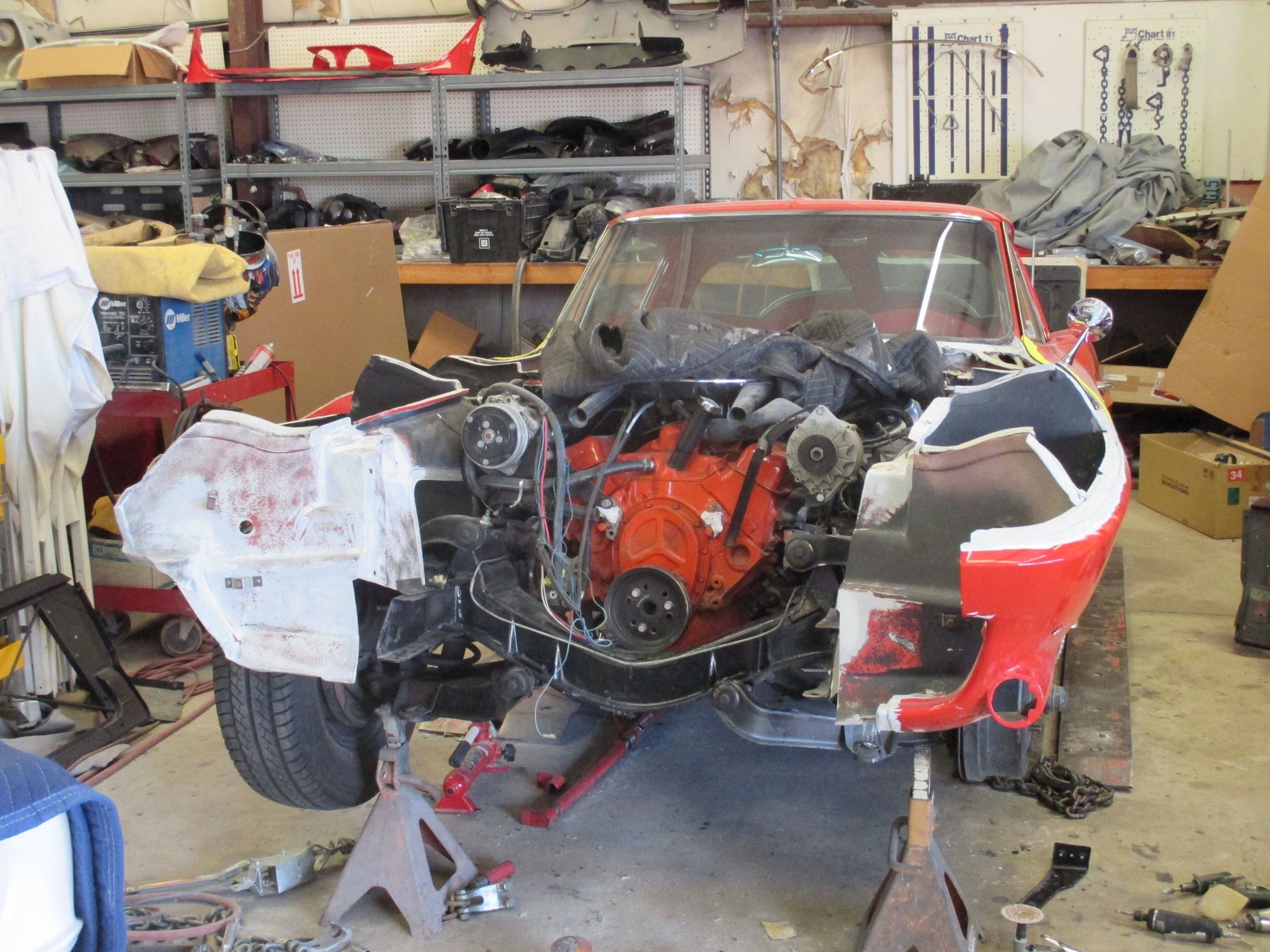

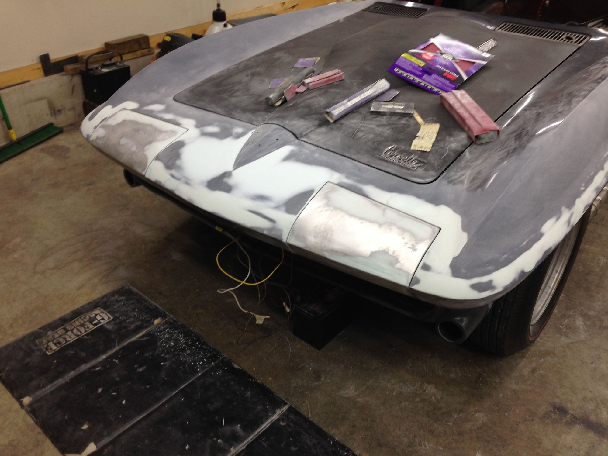

First off - the original post belied how this looks; the pics show that its worse IMO than first described.
I know jack squat about body work, I know 0 x jack squat about paint....let's get that out of the way right off.
I DO know that some have cut a hood hinge down and rewelded it to bring the front edge down; then adjusted the male pin at the rear to get things even along the fender....there is no front pic here so I can't say if that would make the front hood - to surround gap unsightly or the hood-to-cowl gap in the rear unacceptable. That would leave the headlight bucket...I also know that some have glassed around that opening to make the gaps more acceptable...this was done when my car was repaired.
Even with all that done, you might step back and look at the car and see a visible "twist" to the front from these efforts.
Fully acknowledge I'm punching above my weight here and yeah, forking over 1/2 a year's salary for some would prob be the "correct" fix - not all of us can do that... There is no better place than this forum for spending other peoples' money.
I would be tempted to try to remove the PS front hood hinge and rear male pin and use shims to set the hood to match the fender line and step back and see how it looked....but that's how I roll. It will prob not be good but its 45 minutes work to find out.
I'll wait now to have my head kicked in...

As Frankie suggested, check the hinges first. That may solve part of it.
If I am correct the body panel line edging the headlight bucket has a lower angle 'inboard' towards the midline of the body versus 'outboard' the passenger side line. So, whatever you do with the buckets, it will be impossible to line them up both sides. That is an indication that the whole front clip and fender assembly was messed up , or that the frame was twisted. Looks as if the passenger side fender is drooping. Check height of a reference point on the front passenger versus driver side.

I would like to see a straight on shot of the fender from the side and a straight on shot from the front from a little above waist level that includes the bumpers and lower valence....that would reveal more, I think, than these angled photos...
Putting a front clip on a car is not trivial - its a combination of the right parts, the right materials and talent. To wit, a new front clip put on the OP's car, missing any of the listed components, could be nearly as bad as what he has...

I am short on experience here as I've only put one top surround on a mid year but I've seen plenty of poorly repaired cars that had a droppy nose on one corner, sectioned hood hinge, cockeyed front bumper to align with a cockeyed body, hood standing proud on one or both sides of the headlight panel, uneven gaps at the headlight buckets, seams showing through at a panel splice instead of using a full length panel. And the list of nightmares goes on.
Now, I know you being a frugal type (as I am) would be tempted to take a cheaper way out rather than a full front end. I might/probably would tend to go with a full front end replacement. But it wouldn't be a $25,000 job.

The eye and brain are funny things...often, if you can get something to "fool the eye" with bodywork (and woodworking and many other things) the brain will fill in the rest. To wit, something that may not be precise to Six Sigma in actual measurements may look perfectly OK to a spectator... I would play with things as i stated above just to satisfy myself before plunking down $25K -- and, oh by the way, NOTHING gets done for the original estimate!
I've lived through the front clip thing - its no fun..

It’s pretty ironic how some folks who have insisted in other threads that it is necessary to spend big bucks on any paint job for a C2 now advocate short cut fixes for body work in this thread. Good luck with getting this car to look right with that approach.
In the pics it looks to me like the curve of the hood doesn’t match the curve of the surround/fender top. Hinge tweaks will not get those to conform.
And does anyone remember that the OPs original question was about the body panel finish/fiberglass/paint? Hinge adjustments ain’t gonna fix that.
Both problems - panel fit and finish - are the result of a bad job of repairing previous damage. The only way to truly fix both problems is to remove, replace, and repaint.
Short of that I agree with those who suggest either leaving it alone and driving it as is, or selling it and just passing the problem along to someone else.
