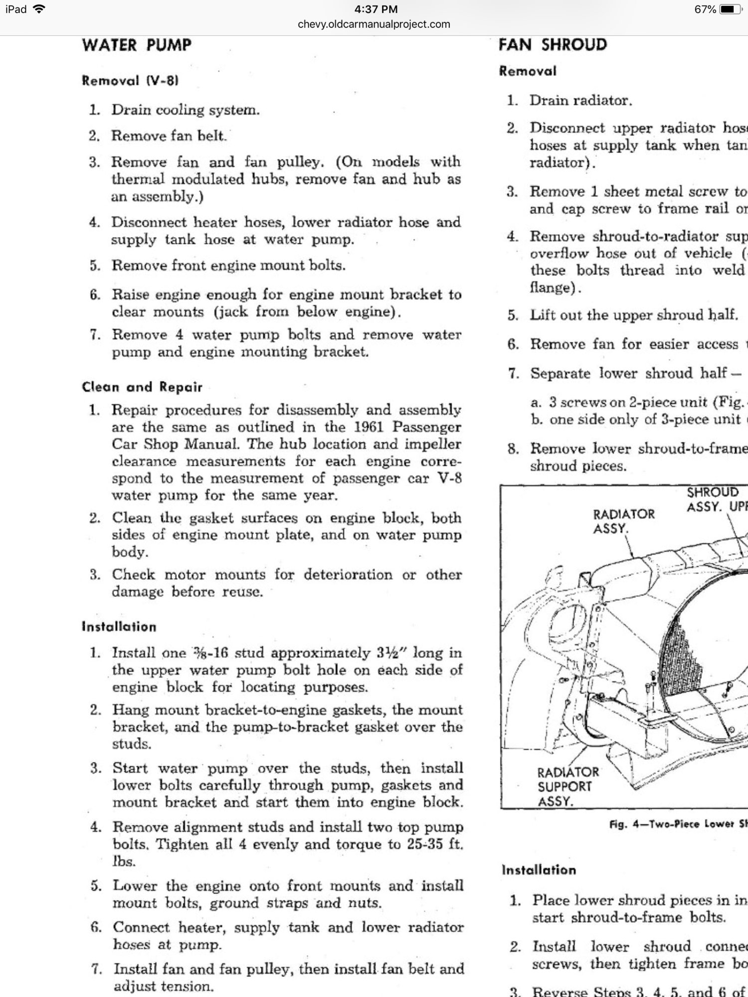

What is the torque for C-1 water pump bolts?

25-35 ft. lbs. per ST-12

The trick is to use Permatex #2 non hardening sealer on all gaskets. It will hold up under slight movement and not tear the gaskets. BTDT.....
