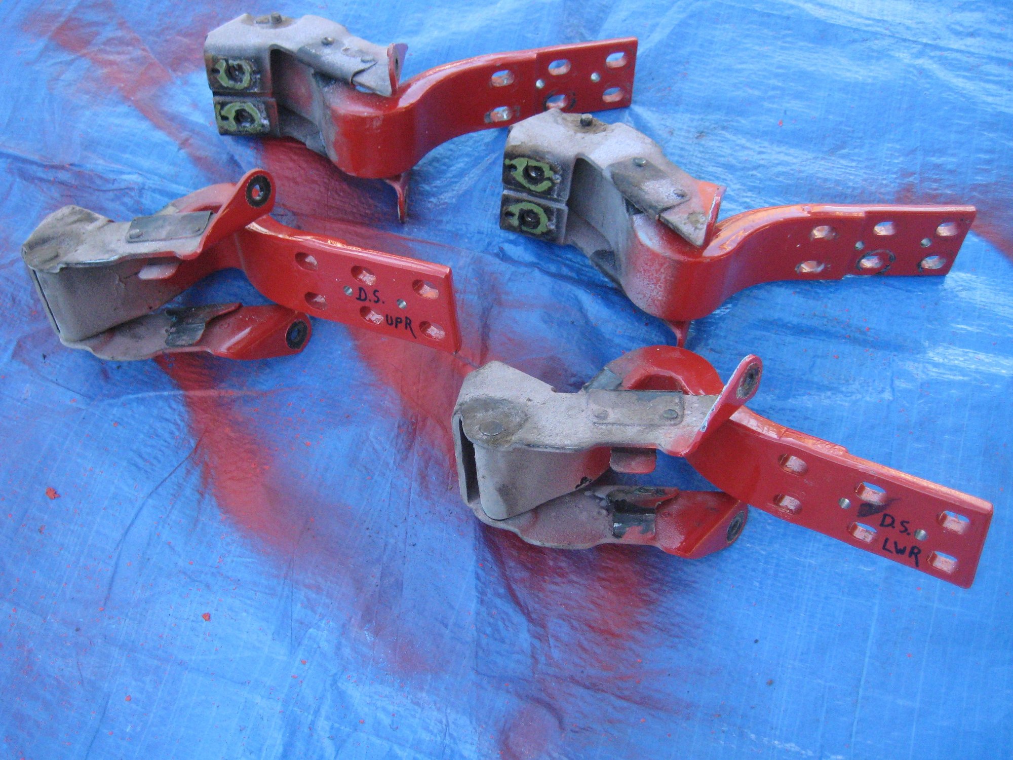

The answer is, yes, the four hinge bolts have to come out including the two behind the kick panel...you can see in this picture the door bolt holes in the hinge in the door jamb and "around the corner" behind the kick panels. You can also see the two holes in each hinge drilled for alignment pins before removing the door....with the door remounted the pins are put in the holes and the bolts tightened and final adjustments made. You'll want to mark where each hinge was installed and the number of shims (if any) at each hinge...
Some "double bush" the hinges by cutting/grinding the flange off one set of bushings and driving them into the hinge pin hole followed by the usual bushings with a flange...this prob does make the attachment stronger but not entirely necessary...
The hinge pin/bushing set I got from the repro Corvette vendor seemed sloppy to me so I went with a Dorman set instead (I'd have to look up the part number).
