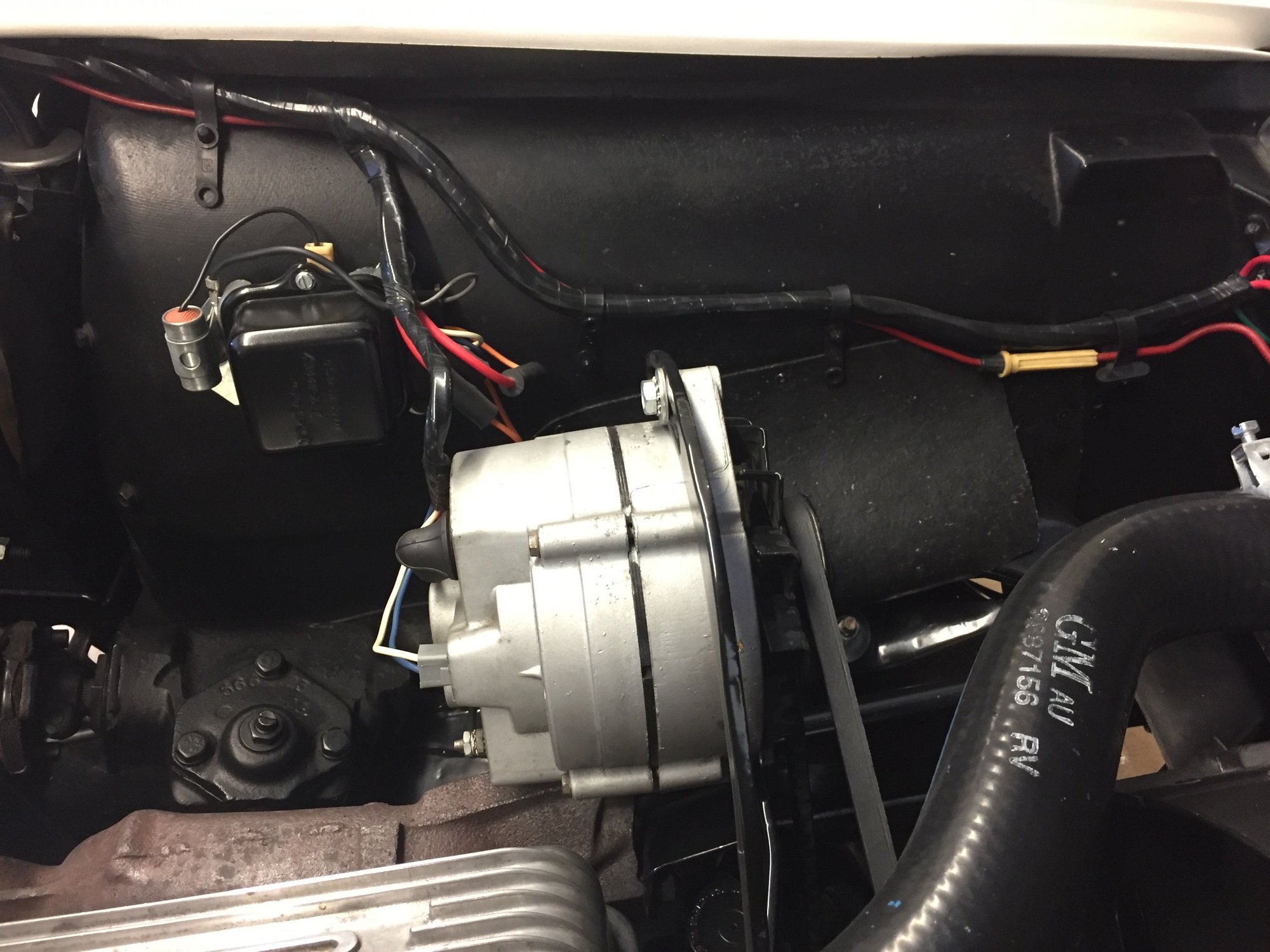

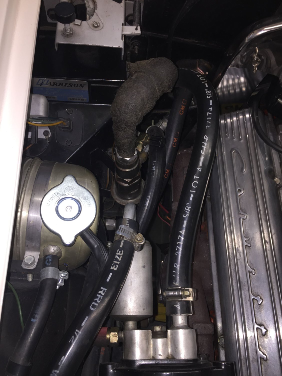

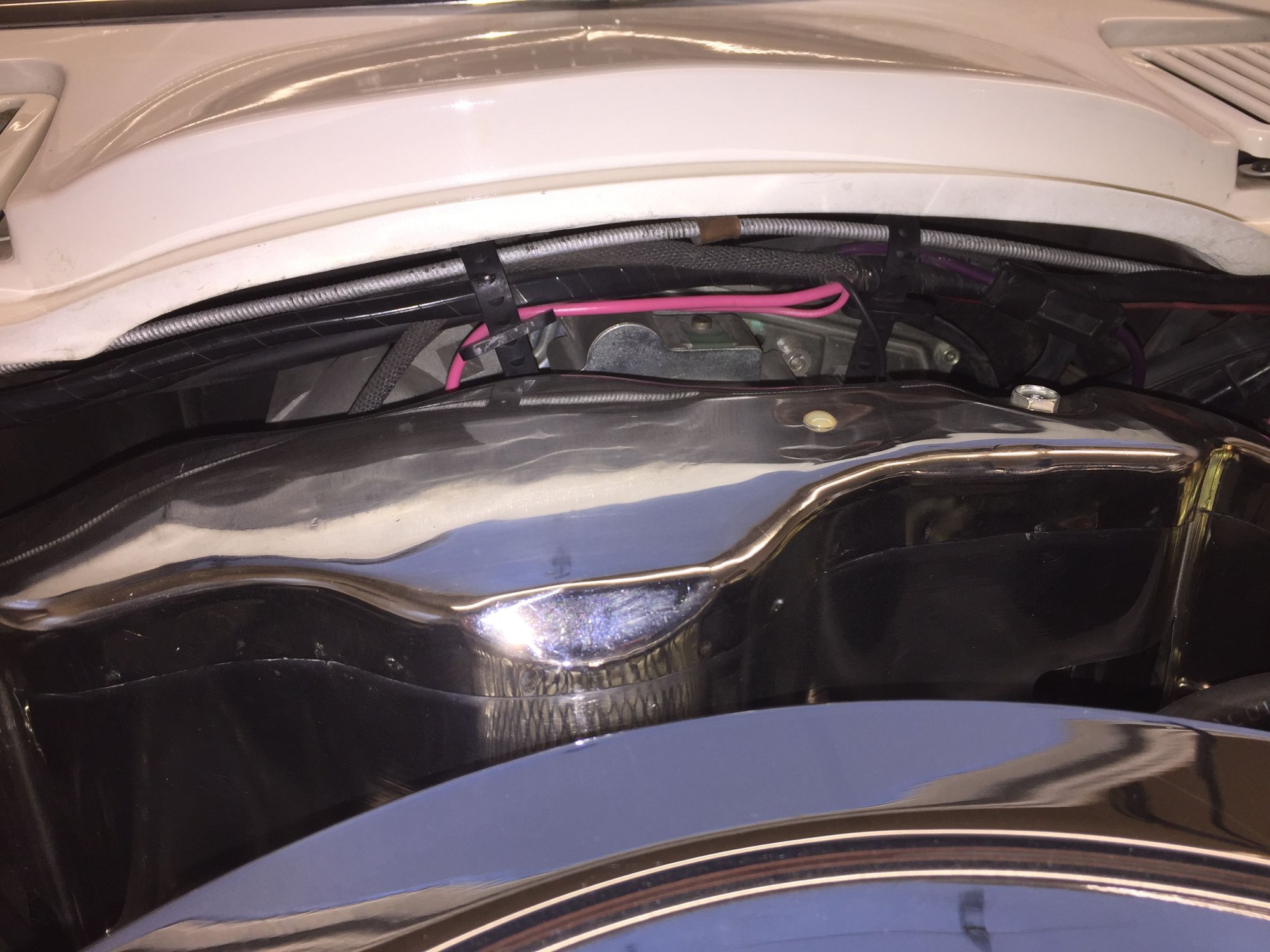

Just a shot in the dark here, but does anyone have any detailed pics of the engine compartment? I have a basket case 67 and I would like to see the routing of everything under the hood. The catch is it is an A/C small block. I realize there aren't many out there but just taking a chance. I looked at the assembly manual and didn't get much help. I am interested in the routing for the wiring harness and A/C lines especially

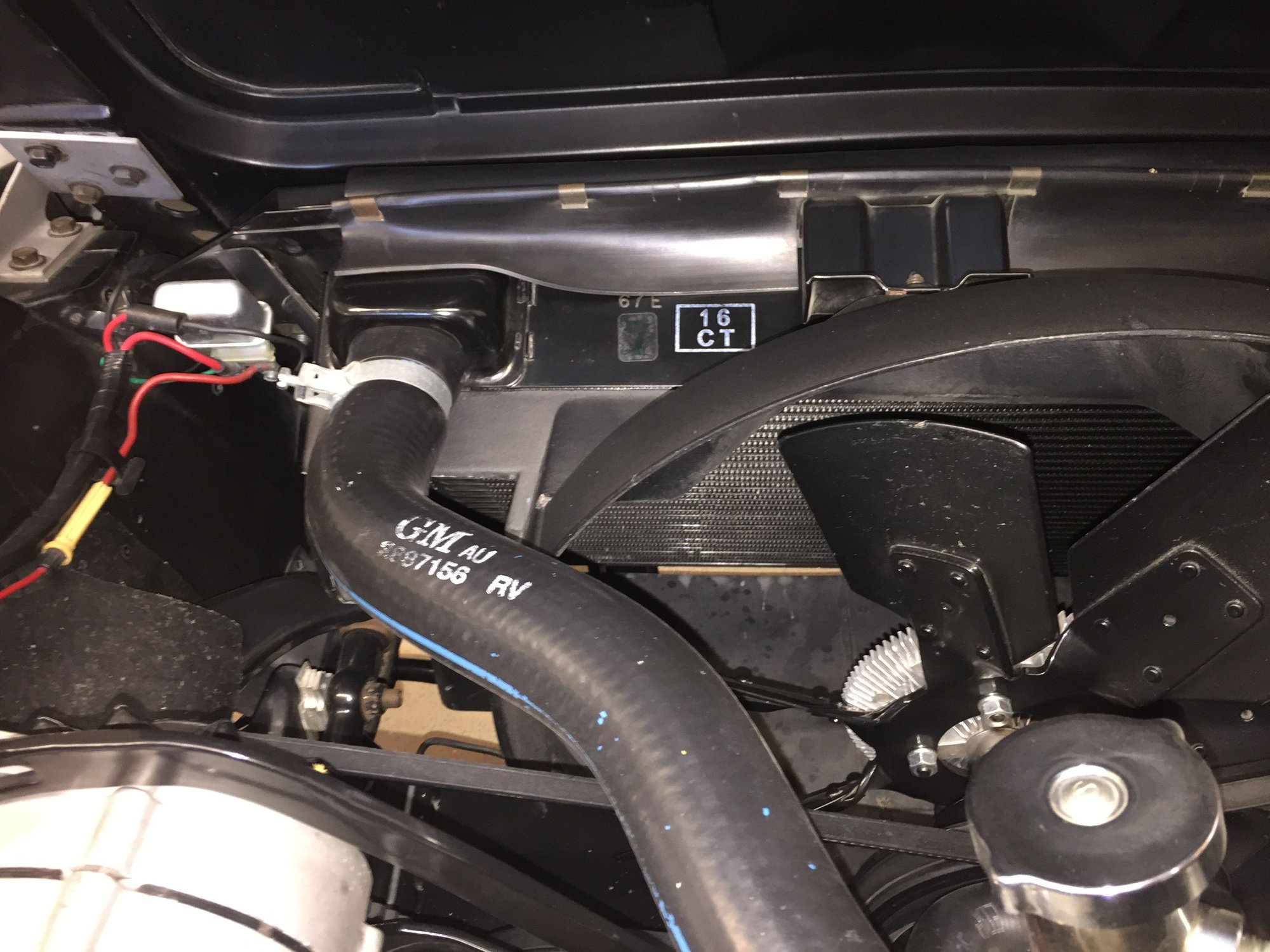

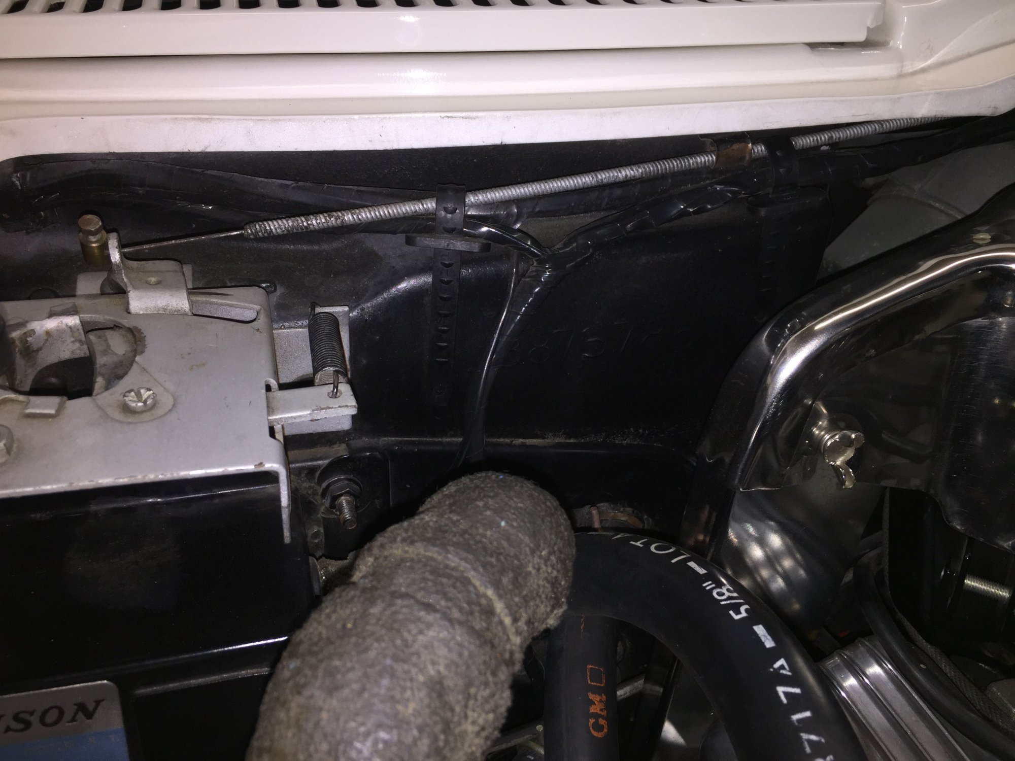

Fred,
These are some pictures of my '67 L79, factory A/C, power steering, power brakes and M21. The factory A/C compressor has been replaced with a Pro6ten unit, but all the connections and routing are factory. If you need any additional pictures, let me know. Also, if you haven't already done so, may I suggest that you purchase the 7th edition of the Technical Information Manual and Judging Guide (TIM&JG) from the NCRS store. Plenty of terrific, color pictures of the engine compartment.

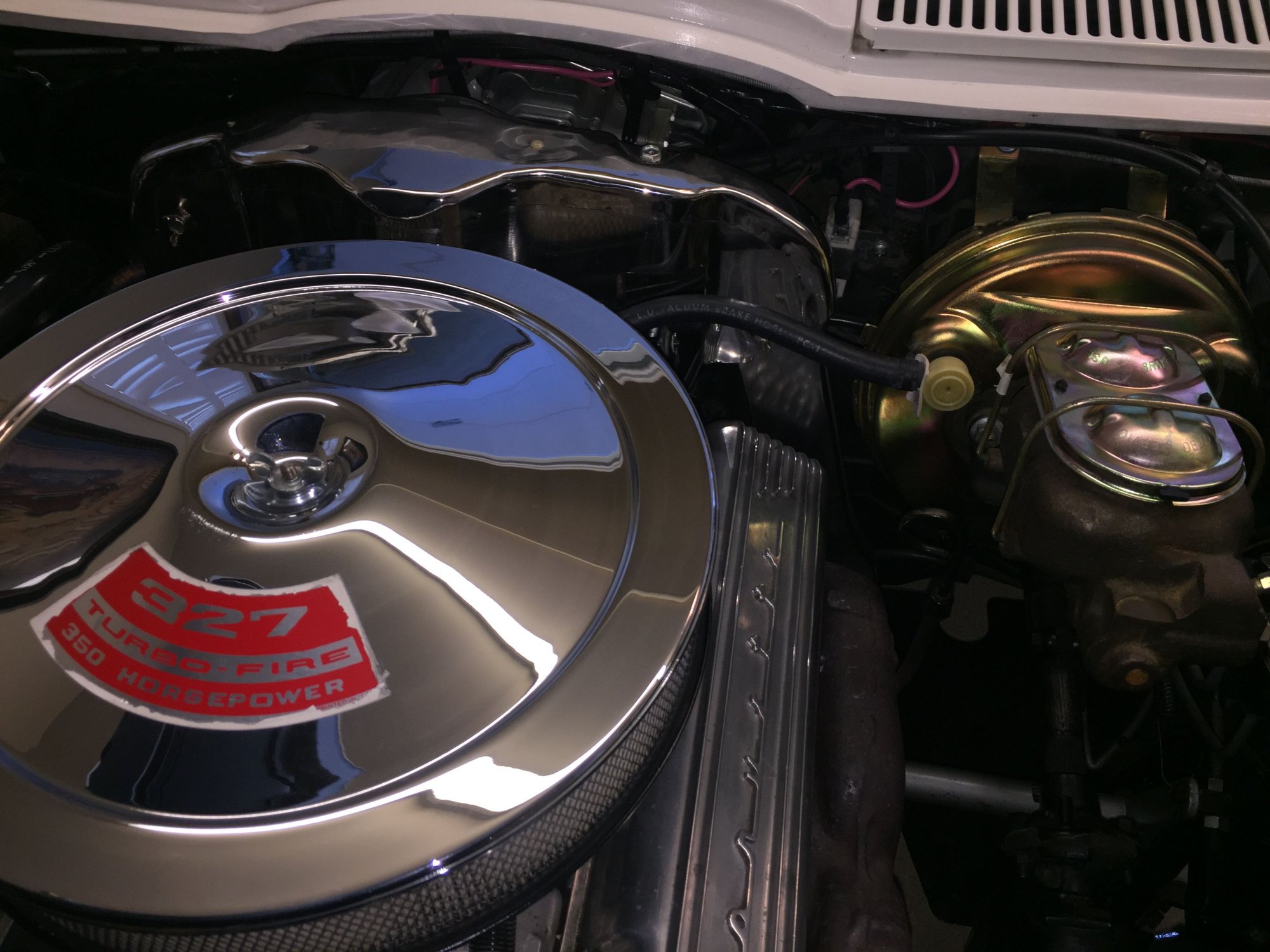

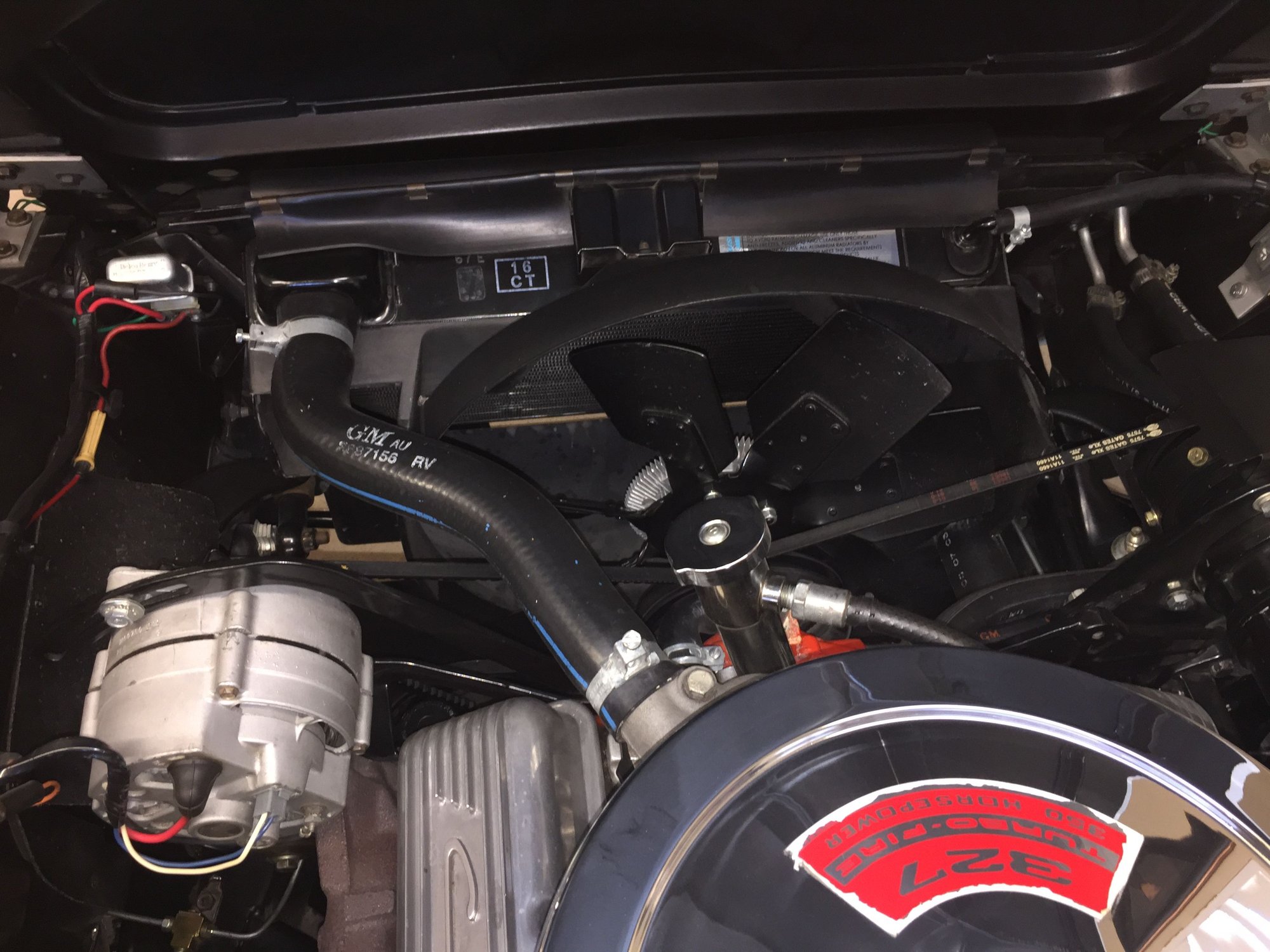

From: Richardson Texas
A few more...

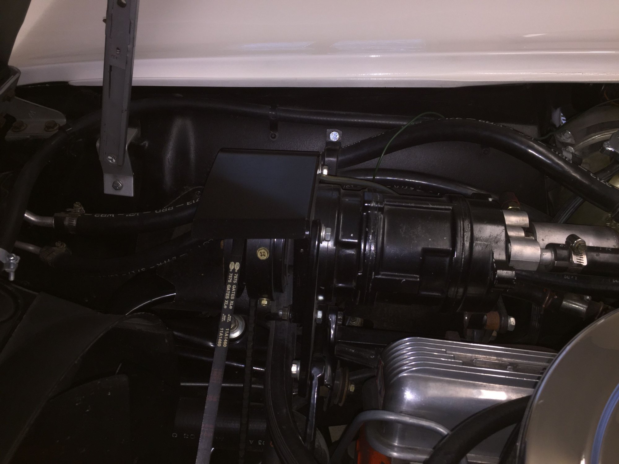

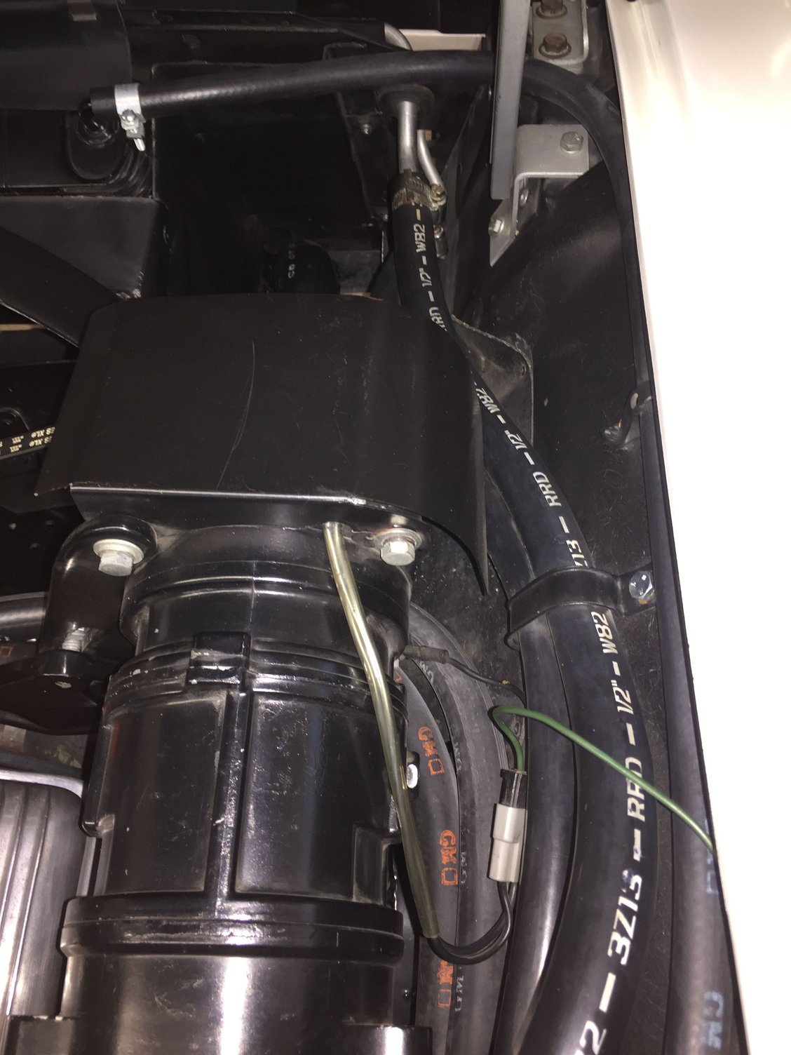

And, a few more...
