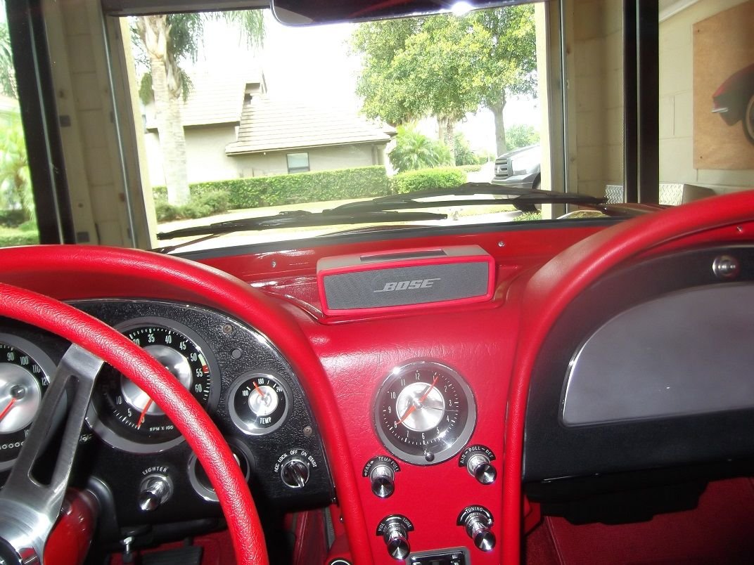

It's such a handy place to put stuff but remember, once it's done and installed in your car, don't place anything metal on the grill like keys or sunglasses. Better yet, never put anything on the grill. That will keep it looking like new for years and years.

Thanks, it looks like OReillys has the paint, will pickup today. Yours looks really nice!

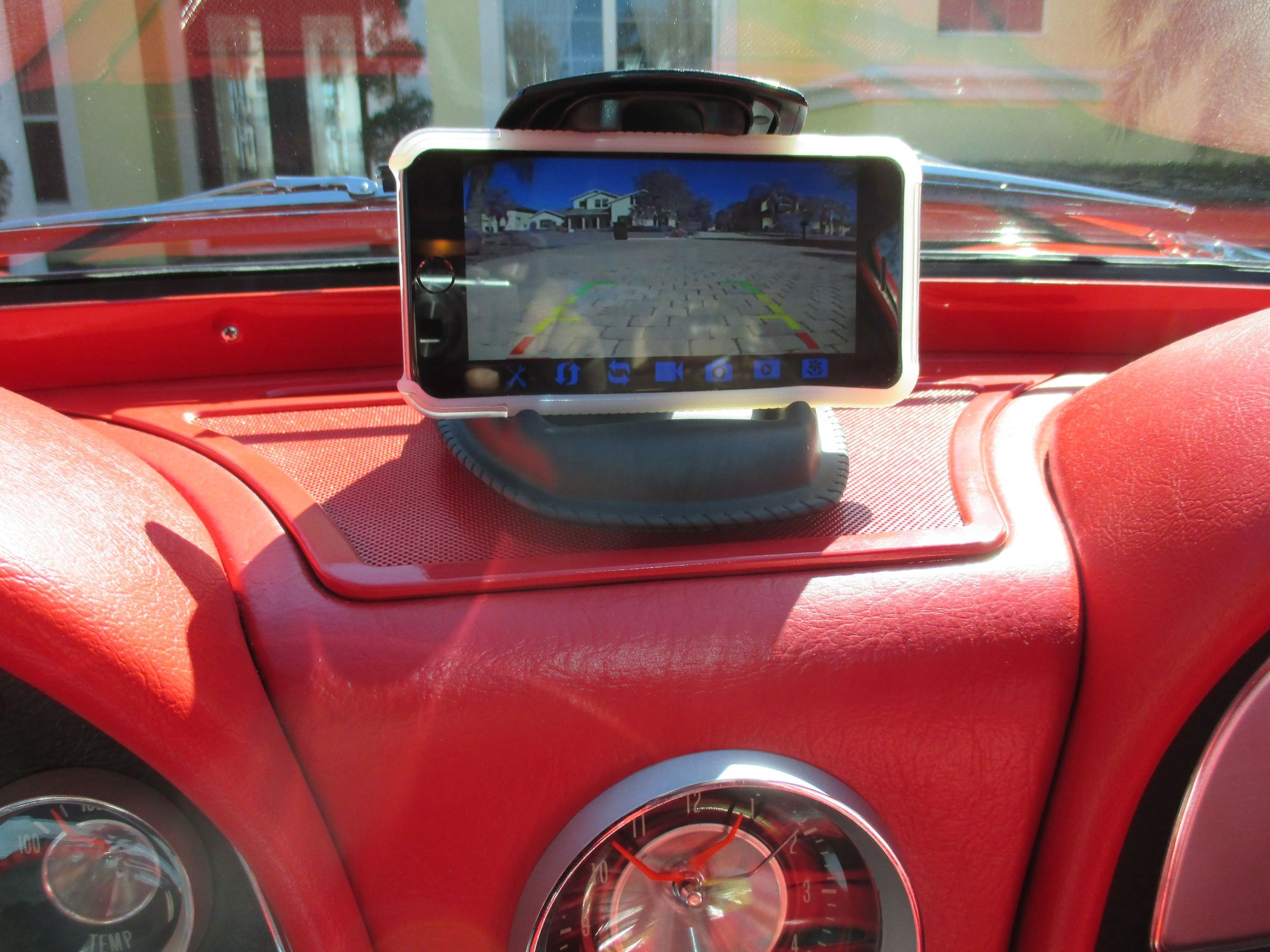

Wow.....like the back up camera!
