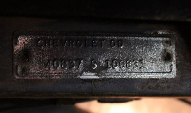

Greetings! I'm trying to sift through multiple online Guides on a '64 Engine stamp and wondering if I can get your help? The VIN matches, but then the character placement is off from what I'm reading online. It is supposed to be a "numbers matching", though there is ZERO documentation / paperwork. I thought the "engine" type was to be in the 9th & 10th position? It ends in RE (or RF), and it is supposed to be an 365hp engine. The trim plate seems to match up to year, coupe, black interior, silver exterior, etc. It has been restored, and is in nice condition....though again, actual miles (pre-restoration) is unknown. Anything else you can tell me would be greatly appreciated.

I'm certainly no authority, but the whole thing looks correct/original etc. I referenced a couple of sources and RE should be correct as you have described the engine. Dennis

Yep, looks all good, RE is '64 L76, and VIN aligns with engine assembly date too.

What happened to the trim tag - did someone shoot it or drill it?

Interesting question. I don't know. I know the car was a full frame off restoration within the last 5-10 years. No documentation...so not sure how or why those holes would occur in the process.

4 - 1964, Vin-106831 (The 6,831 first car off the line)
F-Flint, I2-December, 06-Sixth
RE- 327 CUBIC INCH, 365 HORSEPOWER, MANUAL TRANSMISSION
Phil

Thanks for the confirmation everyone. I get that the first part 7 numbers are a partial VIN, and that the 8th position designates "Flint, MI". The Suffix "RE" references the 365hp L76 engine, but what do the I206 refer to in the middle?
1206= Dec 6

The letter I (capital i) was used for a 1 in engine stamps.

I would say sometime in it's life someone has added a bracket there for a tape player, radar detector, etc

So December 6, 1963 is the date that the engine was assembled.
The engine's casting date is not a stamp but is cast into the block itself. It is on the right side of the back of the block, just down the back of the engine from the distributor. It's visible from the top, though you may have to remove shielding (if you have it) and get the plug wires out of the way.

mine had a couple holes with one in the trim tag for a fire ext bracket. i remember a lot of guys adding the fire ext under the glove box..
