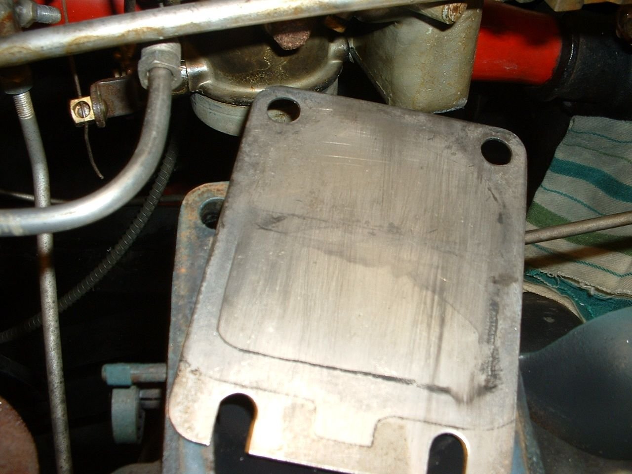

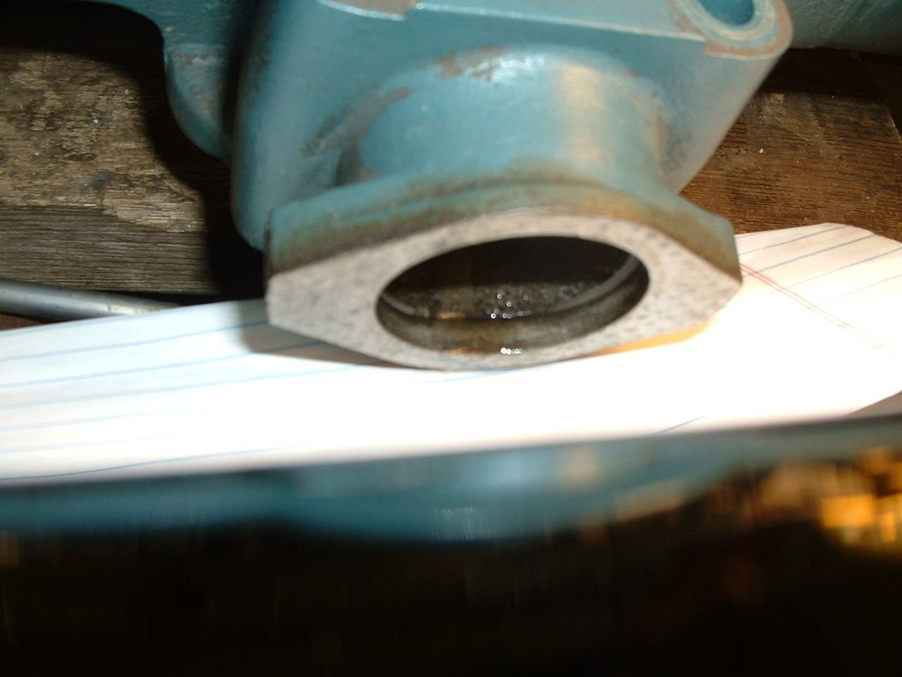

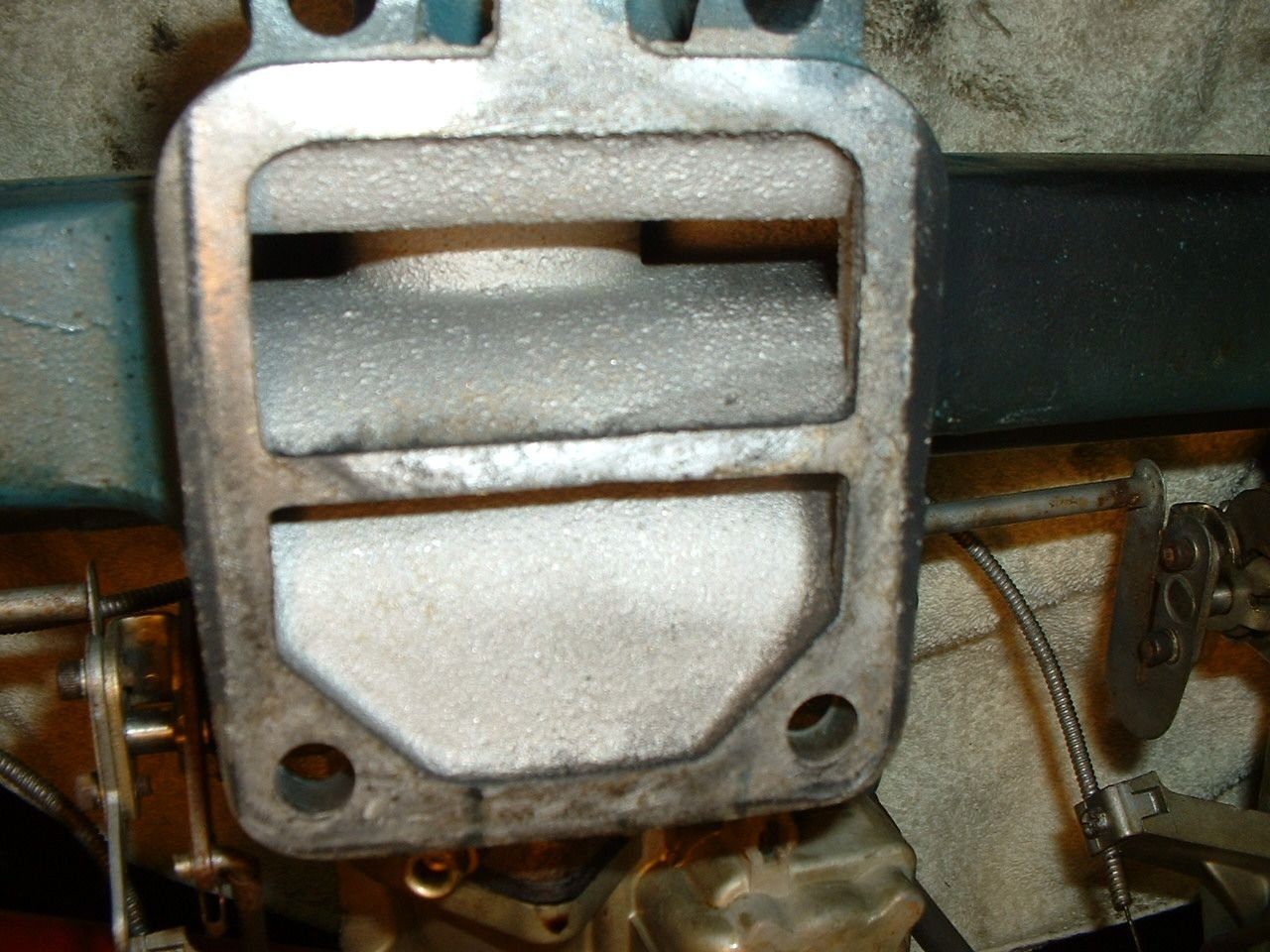

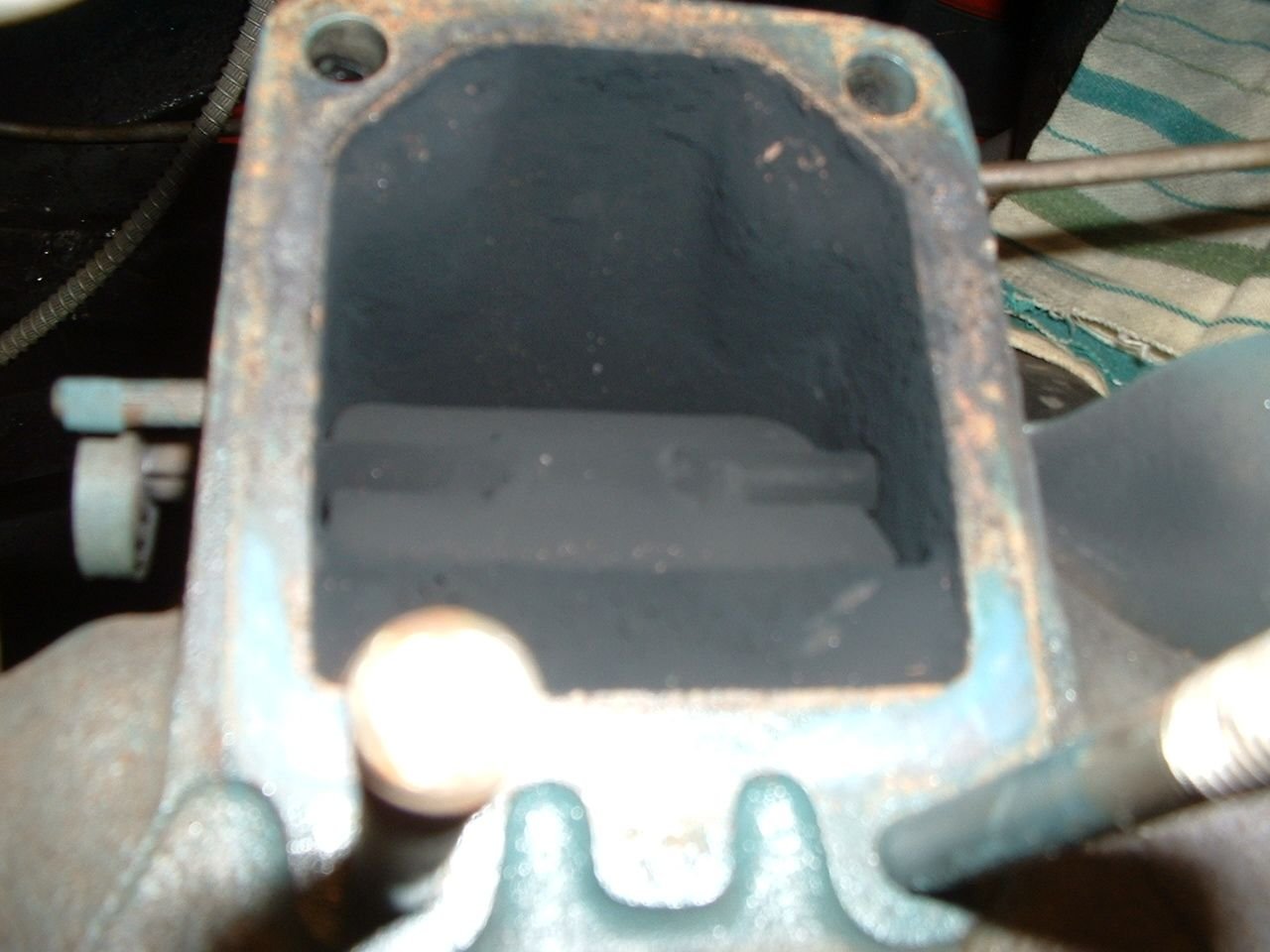

I got back to working on the 54 today. I removed the intake from the head and left the fuel line from the elect. pump hooked up. I turned on the pump
and saw no fuel leaking from either end of the carburetors. (very minor seepage on center carb after 5 minutes with pump on. I examined the area where
the intake bolts to the exhaust and saw no cracks at the stainless blockoff plate. Does this plate require a gasket? None was present. The heat riser
worked fine. No cracks were visible at the intake or exhaust. I can't figure out when the gas was leaking last week why the gas leaking from the LH
exhaust pipe and not the Rh pipe. Logic tells me that if the gas was leaking straight down from the intake to the exhaust, the most direct route would
be the RH pipe. Working on the car today didn't tell me a damned thing. What the heck am I missing?
Photos attached, I hope.
Dave
