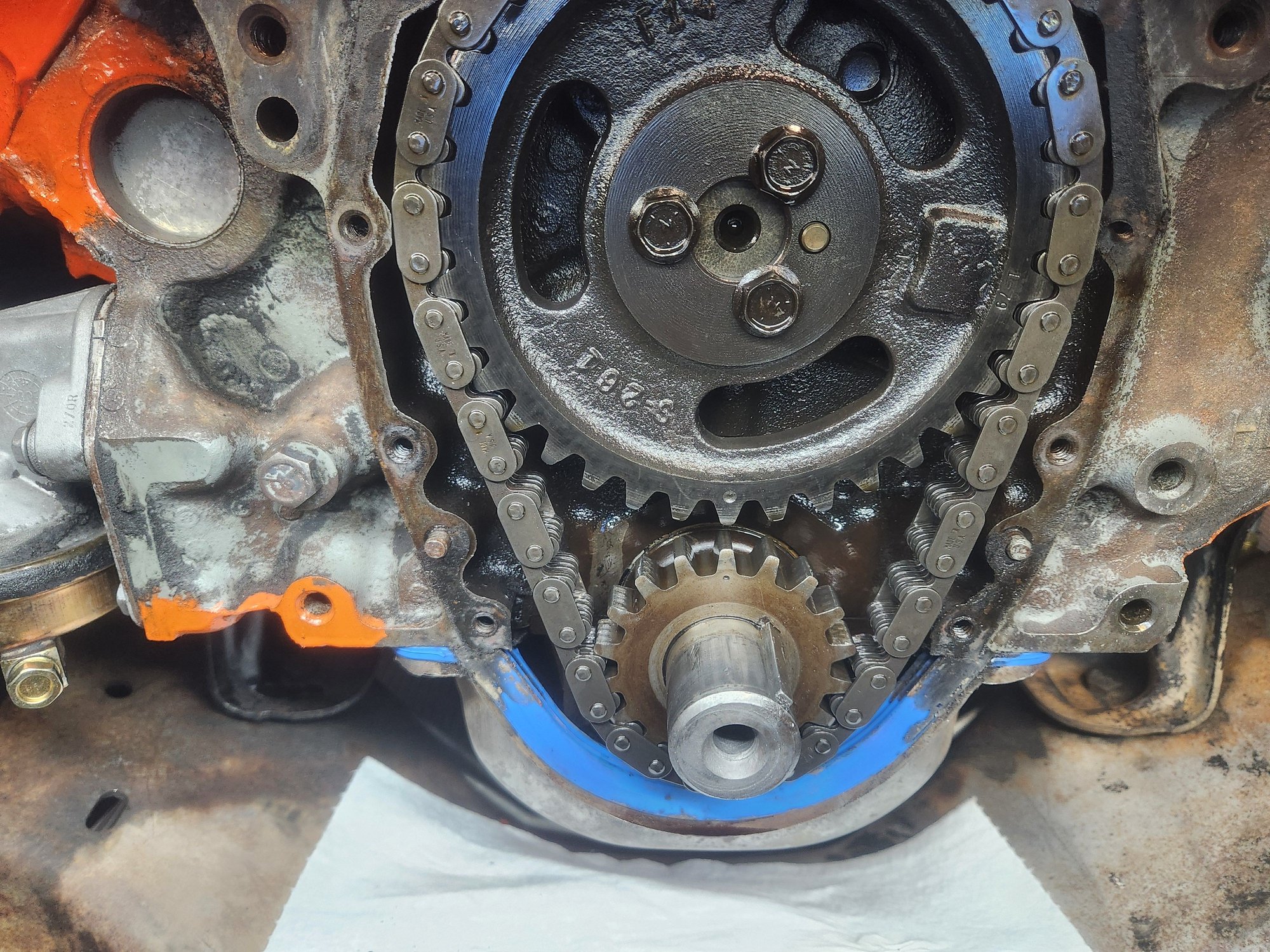

For a 283 220 HP looking for timing chain replacement. Current one not horrible but since it's apart drilling for balancer bolt figure just replace. Duke posted Cloyes C3023K about 6 years ago. So, any updated suggestions or is this still the best choice. Mild performance driver, looking for dependable quality.
Tks. DRC

Still looks pretty tight to me…….
I can flex the one side about half inch, other side very little flex, if you expand the picture the crank gear teeth are worn with deep grooves from the chain. So really quite a bit of wear.

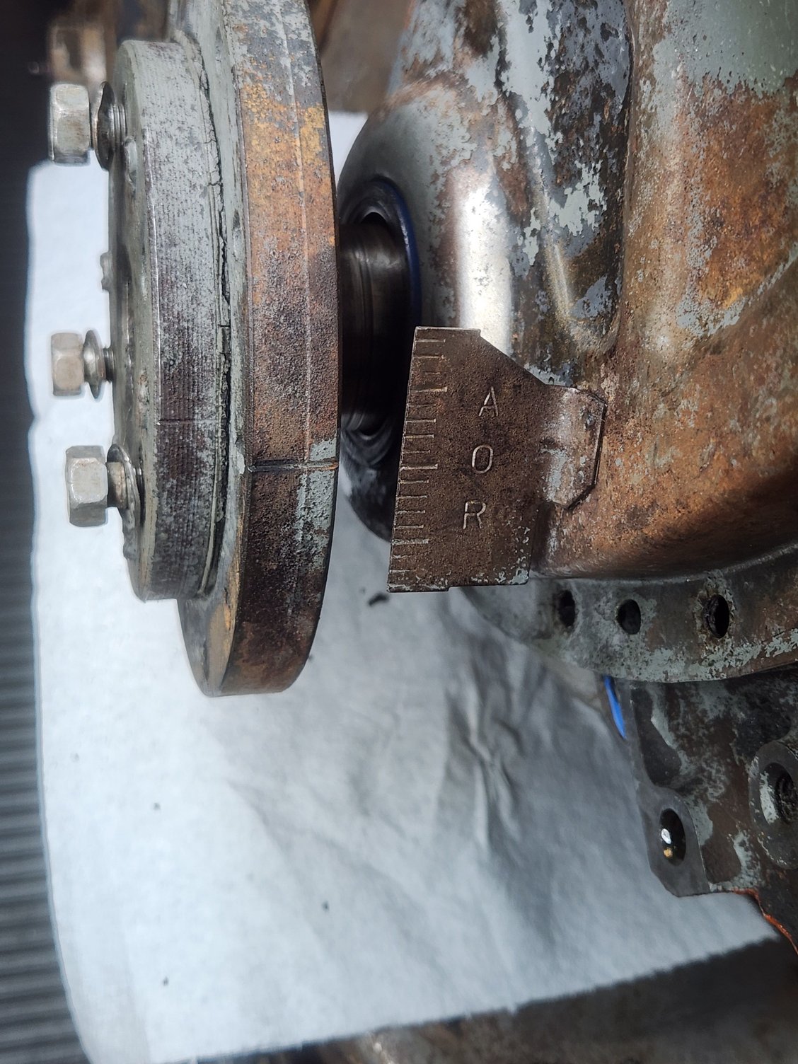

Ok, now after drilling
crank 1 3/4" deep and tapped 7/16 x 20 I need balancer bolt. Any thoughts on bolt length for the stepped stock balancer?
Tks. DRC
