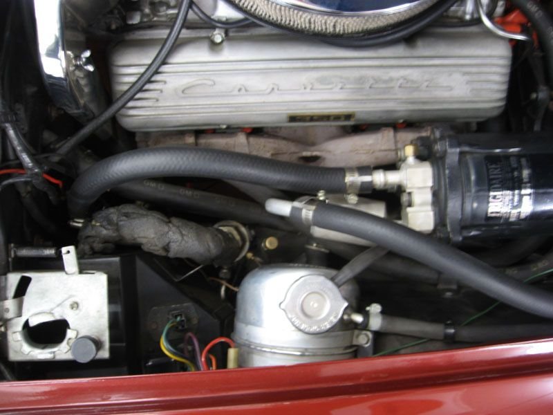

On my '66 coupe with factory A/C I've always removed the plugs from underneath the car. I never wanted to move the compressor. #2 and #4 are all done by feel, the plugs, even the shielding, you can't see a thing. Every time I've done it (just twice so far thankfully!) I've told my self, next time I should leave the shielding off, but I still re-install it. I'll definitely check out going through the wheel well next time. Thanks for that tip.
For those of you who don't know the joy we're talking about...
...somewhere beneath this morass are spark plugs and ignition shielding, oh and a fuel pump too!
