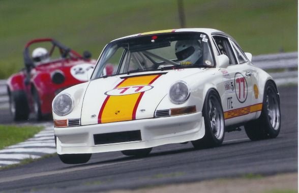

Originally Posted by 69427
You need to rethink that. Adding/increasing the bar size will reduce the traction on that axle (while increasing traction on the opposite axle). Increasing the front bar size will increase understeer, and increasing the rear bar size will increase oversteer. (Recall, that's why GM put rear sway bars on big block cars, Big block cars are front heavy, and will normally understeer. A rear bar will loosen up the rear, allowing a more neutral handling car.) A bar is used for tuning, not increasing traction. For amusement, go look at a picture of a 911 Porsche (with a big front bar installed) during cornering. Because the old 911s used to oversteer so bad, the front bar size was frequently increased to add understeer to the car. If the car was equipped with sticky tires, the body lean of the car, combined with the stiff front sway bar, would actually lift the inner front tire off the ground (I've seen Corvettes do this also when the front bar was too big.)
Cliff note: If the car is understeering, increase the rear bar size. If the car is oversteering, increase the front bar size.
You mean like this.....?
And this was going into a flat corner ie, turn one at Limerock, CT
