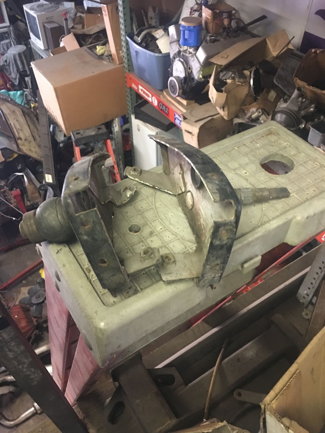

So, in this "flipped over" picture the side rails and horizontal pieces are bonded (not riveted) to the outer fiberglass "skin" and the 63 early vs late screw attachment feature is determined by the metal frame pieces, not the "skin" ? Right ?
Hey Frankie,
I'm pretty sure they're bonded on the early cars. Ours is a November '62 build. I still have mine off of the '63 so I'll go out and take a pic of the underside.
I can tell you they were a bear to get to fit the car nicely. It took me a lot of time glassing, and sanding to get them to where I was happy with the result.
Pat

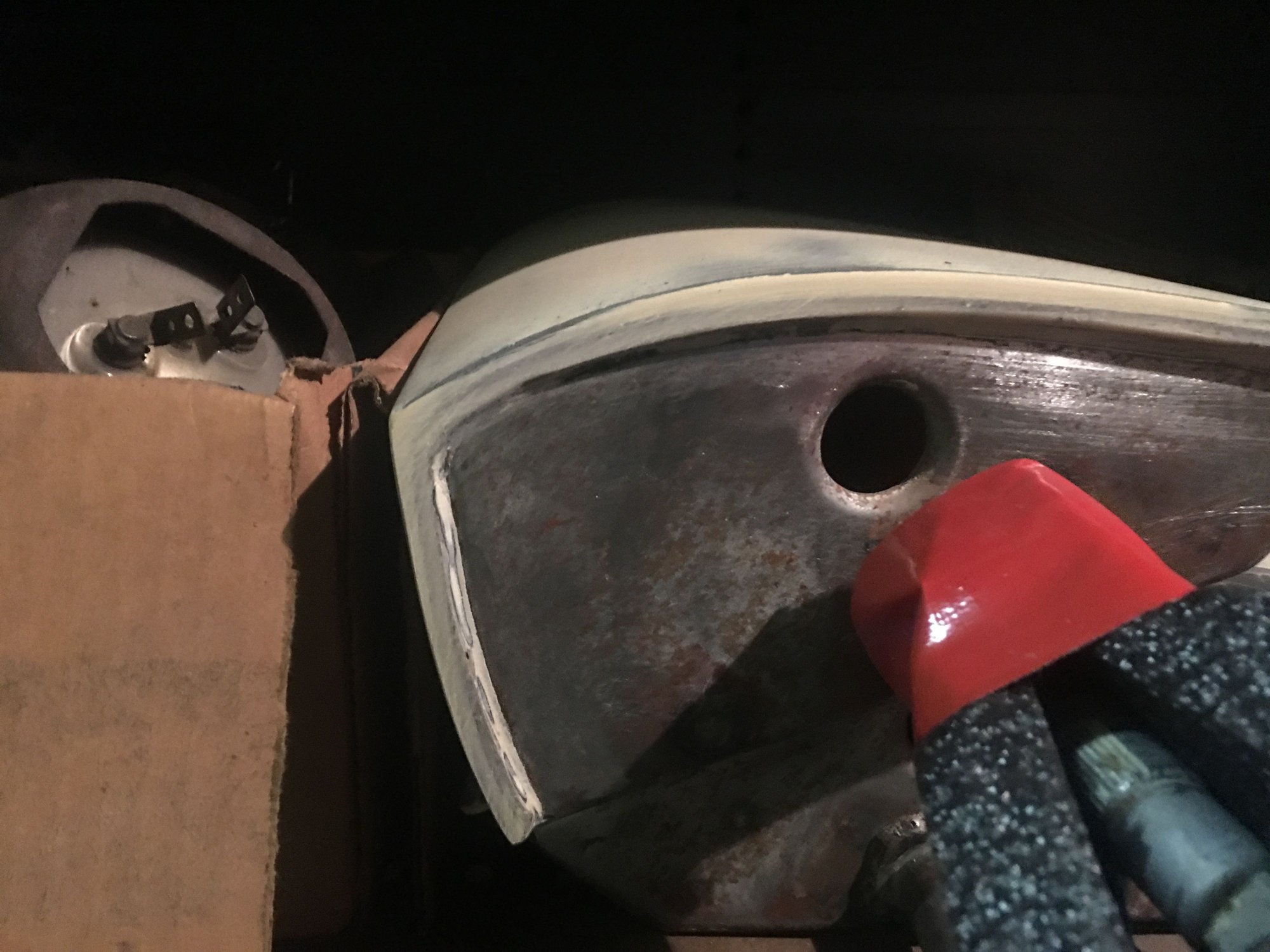

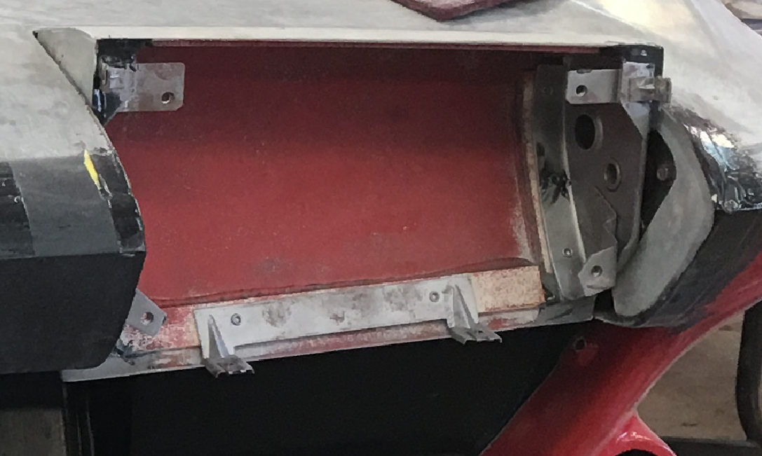

You can tell the early skin from the later skin by looking at the sides of it the early skin just gets bonded to the metal structures on each side of the bucket. The later 63 skins were stronger and rolled over the side of the metal structures to help support the bucket they also had extra bonding strips inside that hold the headlight rim on the bottom as seen in Frankie‘s picture.
Late 63 bucket
Early 63 bucket
Metal sides with no skins and bonding Strips removed

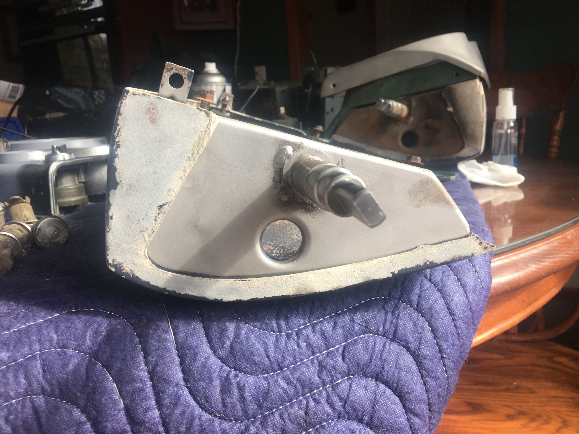

Don't know if this helps you or not Frankie.
Pat
To 1963 headlight buckets
