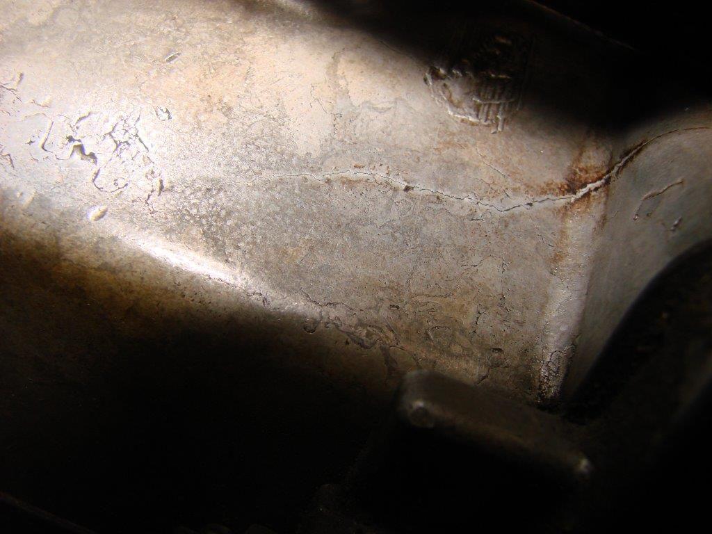

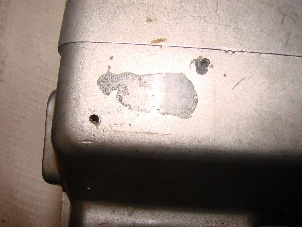

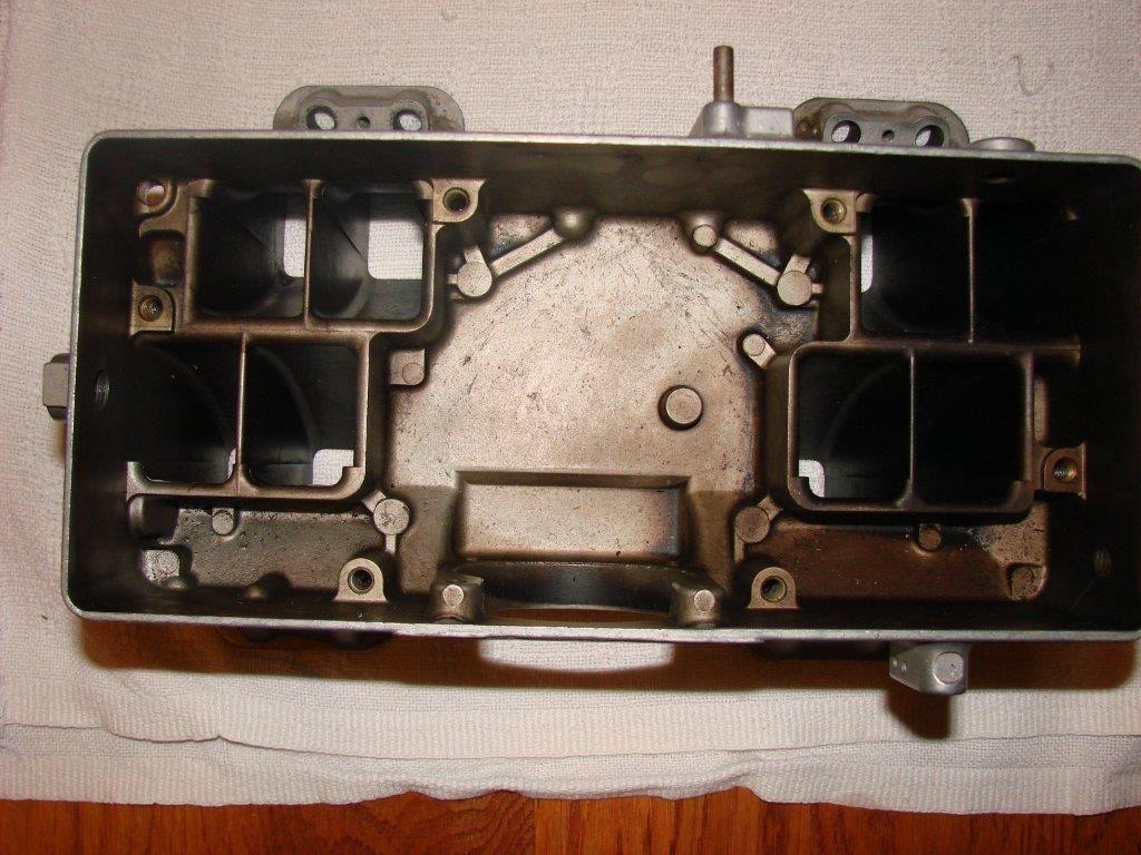

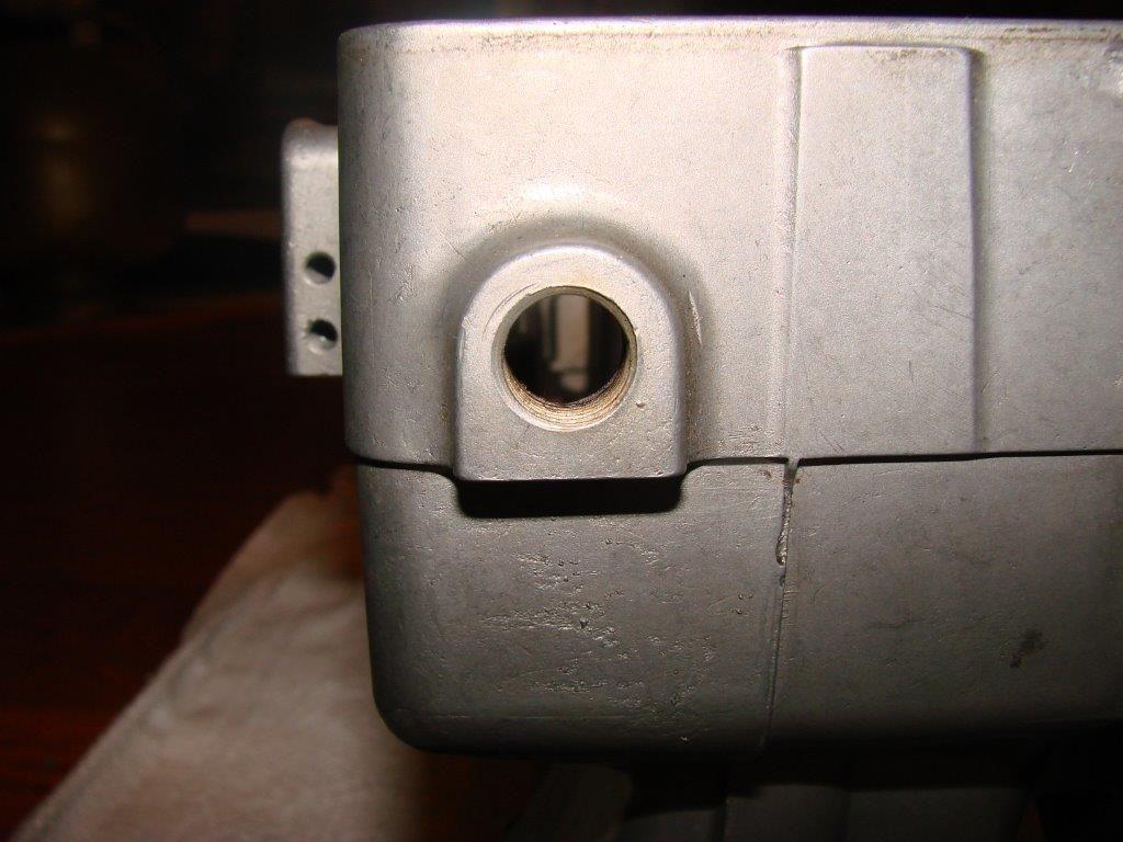

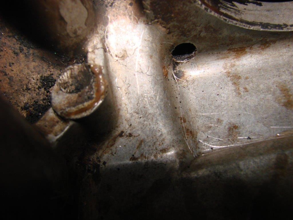

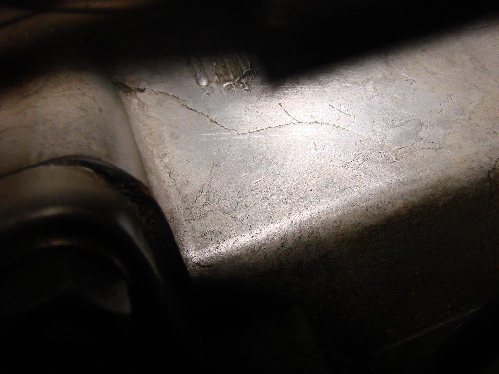

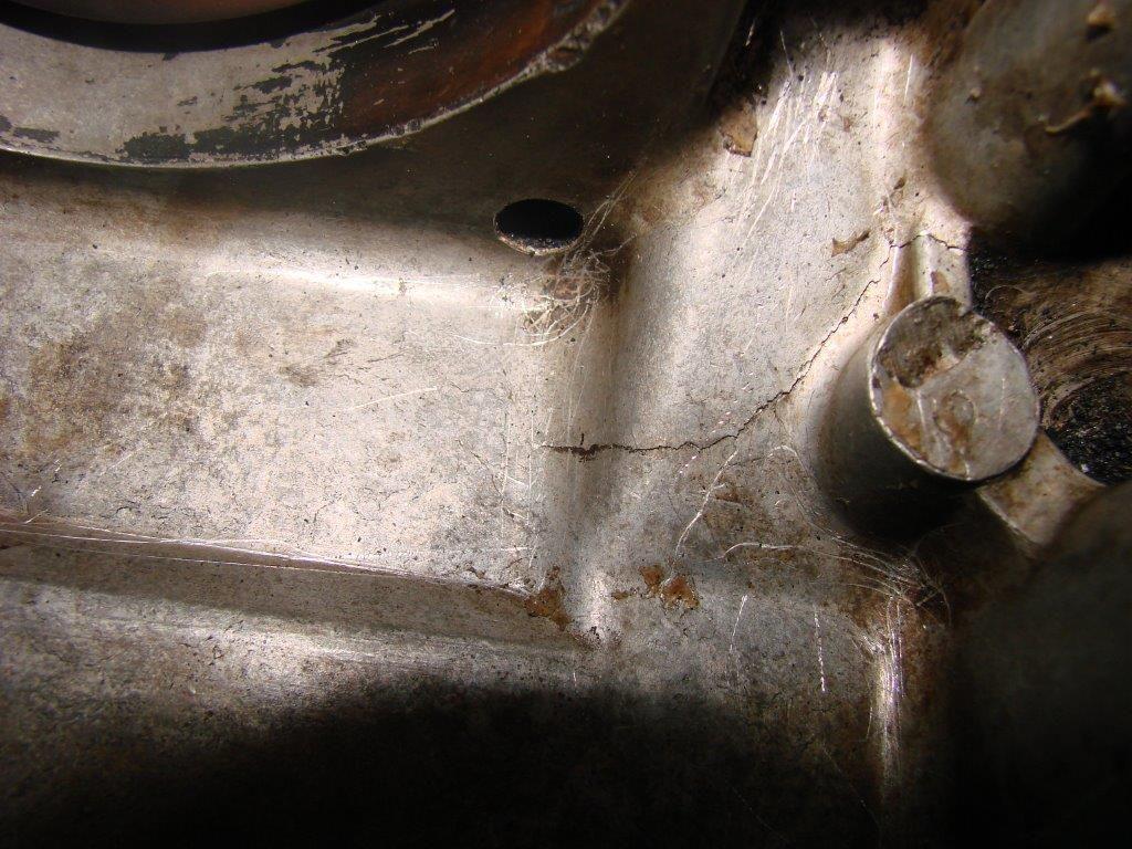

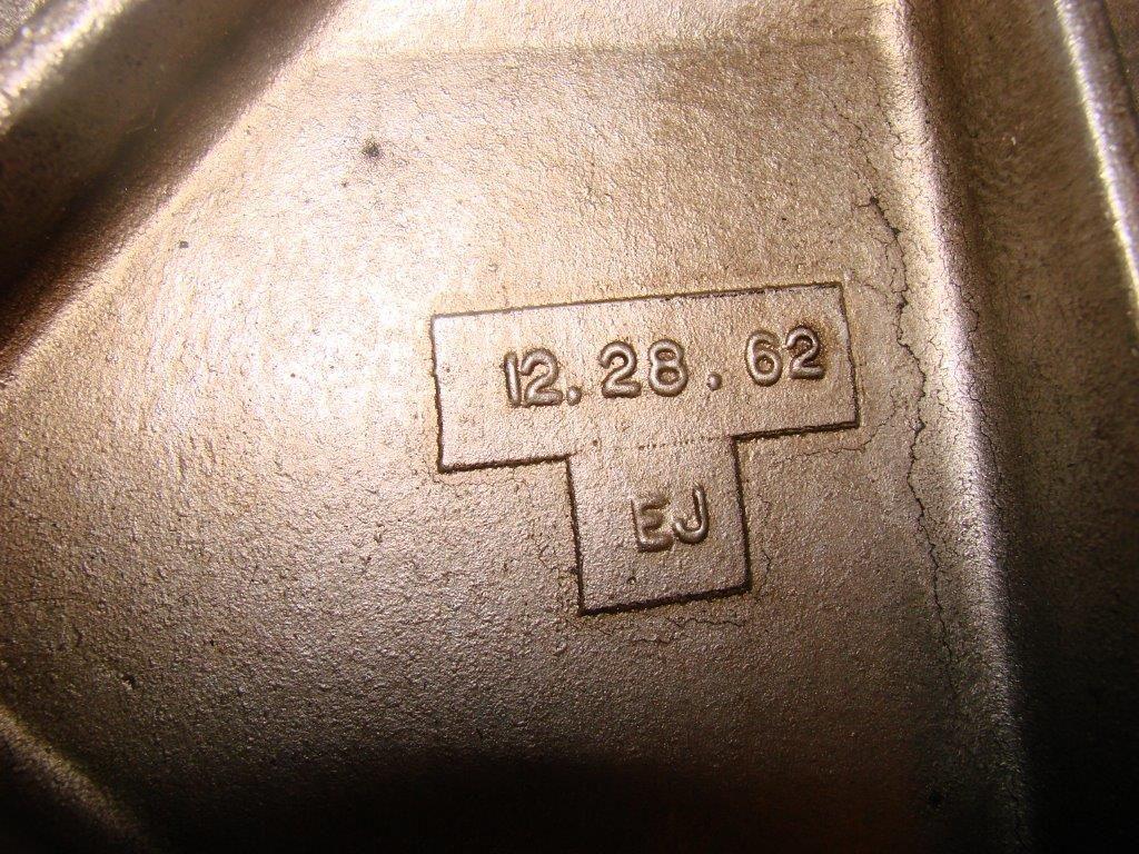

I have encountered the first issue with my new (at least to me) 1964 FI unit.
When I first removed the lid, I found two large lumps of silicone on the bottom of the plenum, near where the air meter attaches. I removed the silicone at that time, but did not check any further.
I went back in and cleaned the areas this morning.
I found two hairline cracks, each about 2 inches long, one on each side of the area where the air meter attaches at the bottom.
I can see the hairline cracks on both the inside and the outside of the plenum.
They both look like easy repairs by an decent aluminum welder.
But, I thought I would ask for suggestions on repairs.

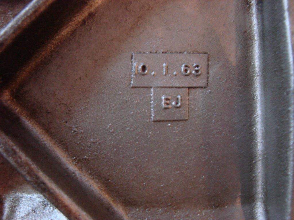

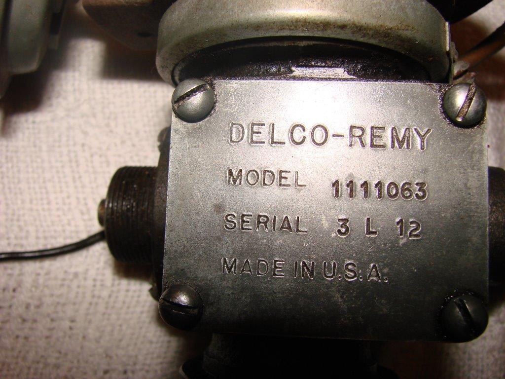

Also found this info...
Dated 10 1 63. Distributor is dated 3 L 12 (1963, December 12th). A late 63 built FI unit, going on a late January 64 car.

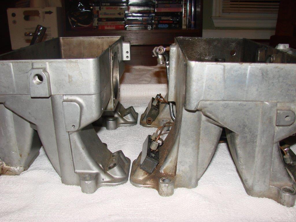

What are the differences (if any) between a 1963 7375 Plenum, and an early 1964 7380 Plenum?
I have a 7375 plenum with no damage or repairs (as best I can tell at this point).

One difference in the plenums is the 7380 has a vacuum tap in front for the PVC hose. The 7375 doesn't.
The '64 distributor has a faster mechanical advance curve than the '63. It may work better with your stock engine. Don't know. Try it.

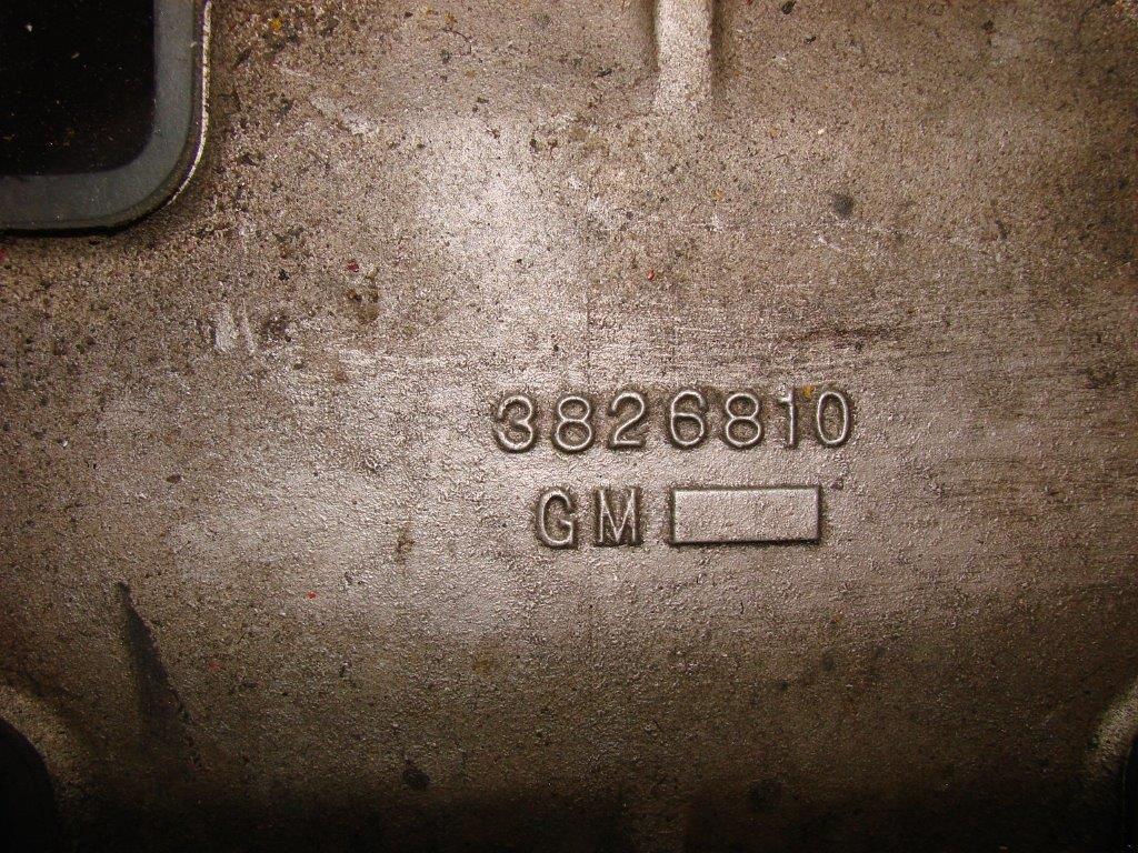

9. 1964 Complete Rochester FI unit with damaged (cracked) 7380 plenum, 1964 1111063 distributor, complete, appears to be fully functional, good condition base adapter (manifold) with 3826810 casting number and dated 10 1 63, complete and appears to be in good condition 1964 fuel meter assembly, complete and appears to be in good condition 1964 air meter assembly, fuel pump to fuel filter fuel line, 1957 air filter assembly, needs rechroming.

Those 'cracks' look more like casting flaws, and were probably there from day one. Other experts will hopefully chime in....but looking at the rest of the casting, it looks like they have always been there.
While I don't consider myself a castings expert, I've seen plenty of casting flaws and I agree that's what those look like to me.
If that plenum were mine, I'm not sure I'd do much about those flaws/cracks. They certainly don't affect the operation of the FI unit.

I think when they are showing on the inside, and on the outside of the part, they are cracks.

You can do a NDT on aluminum with dye check to determine if you've got got a crack.
Yes, and this will be done.
Old Mar 3, 2019 | 12:48 AM
emccomas's Avatar
emccomas
Joined: May 2005
Posts: 31,497
Likes: 1,313
From: Huntsville AL
A agree. The cracks follow the same line on the inside and the outside of the plenum.

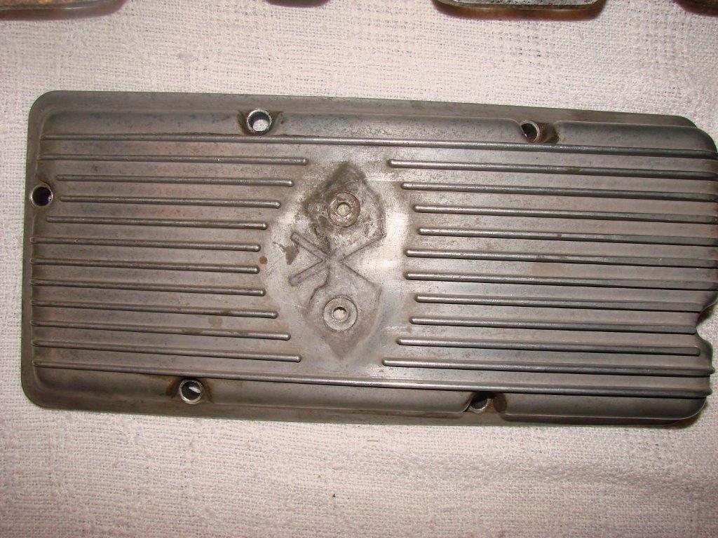

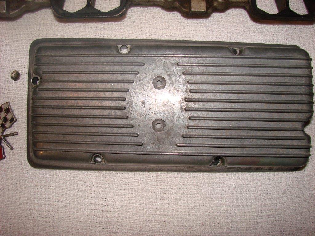

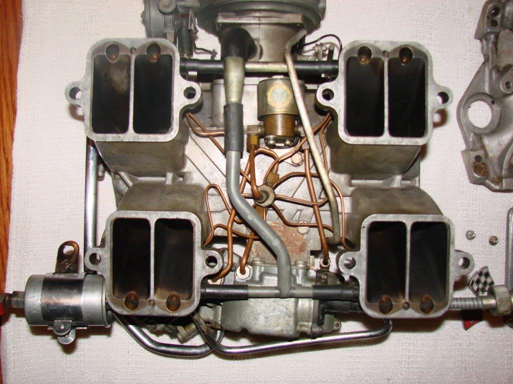

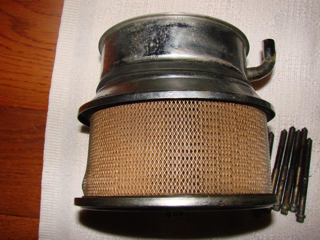

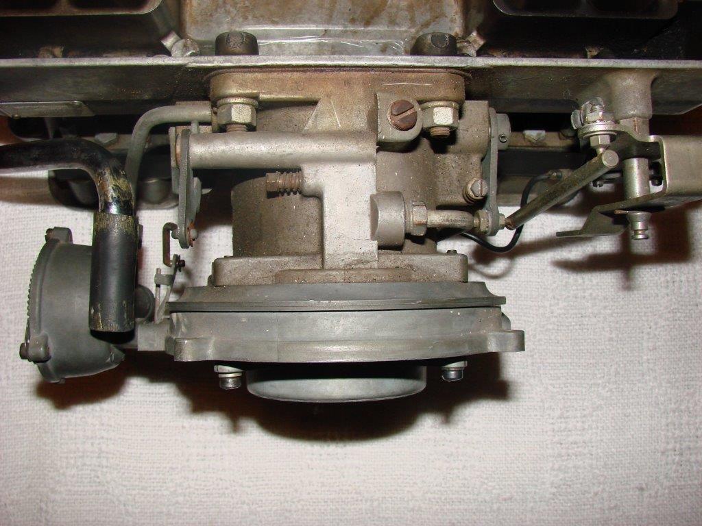

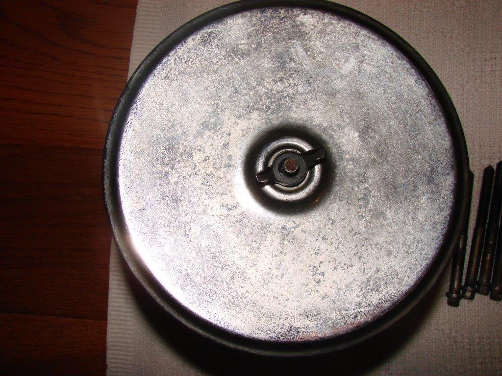

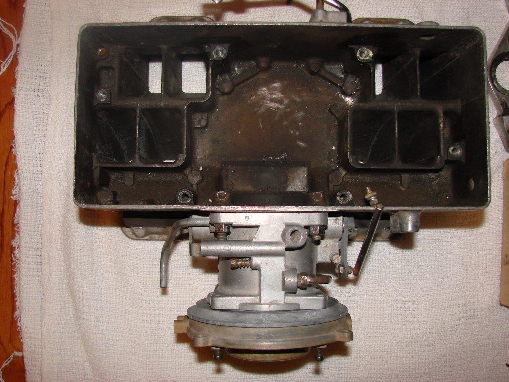

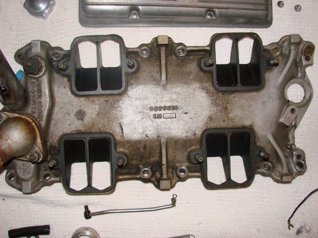

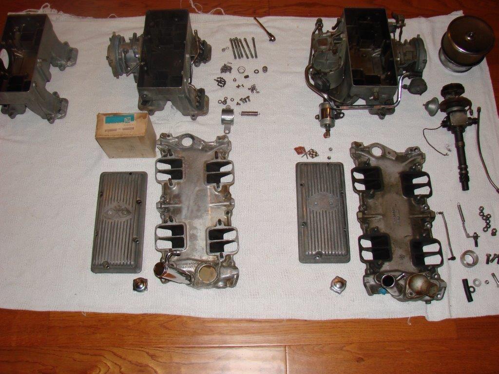

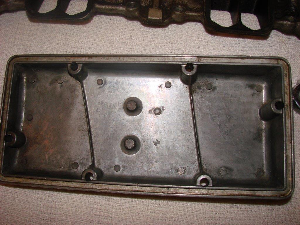

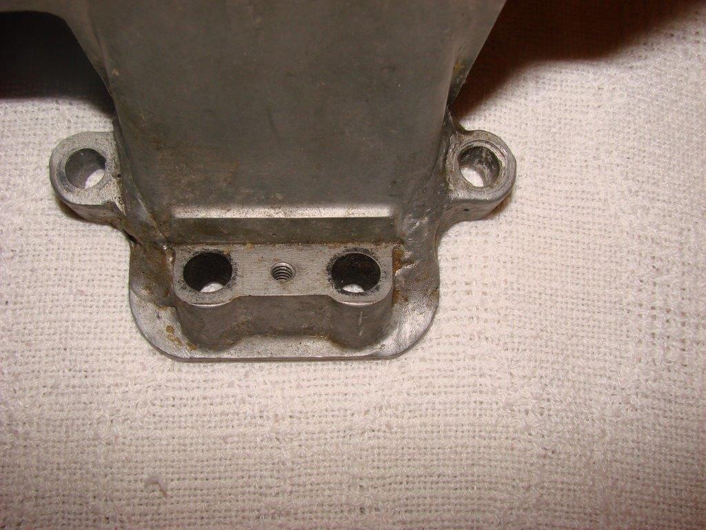

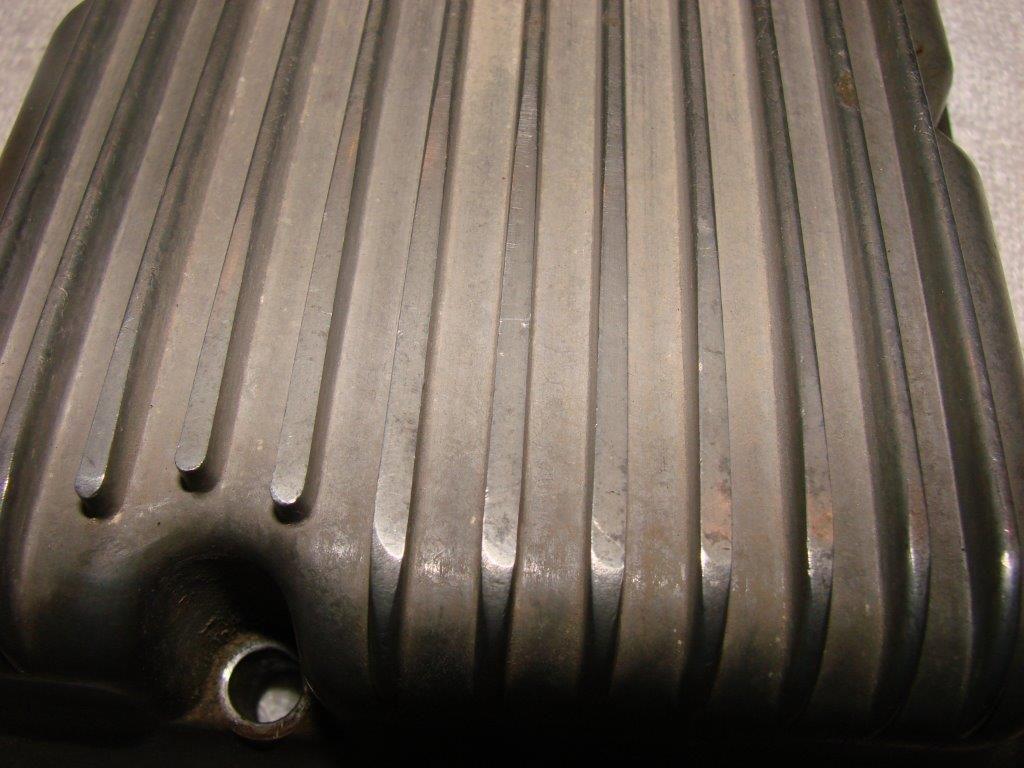

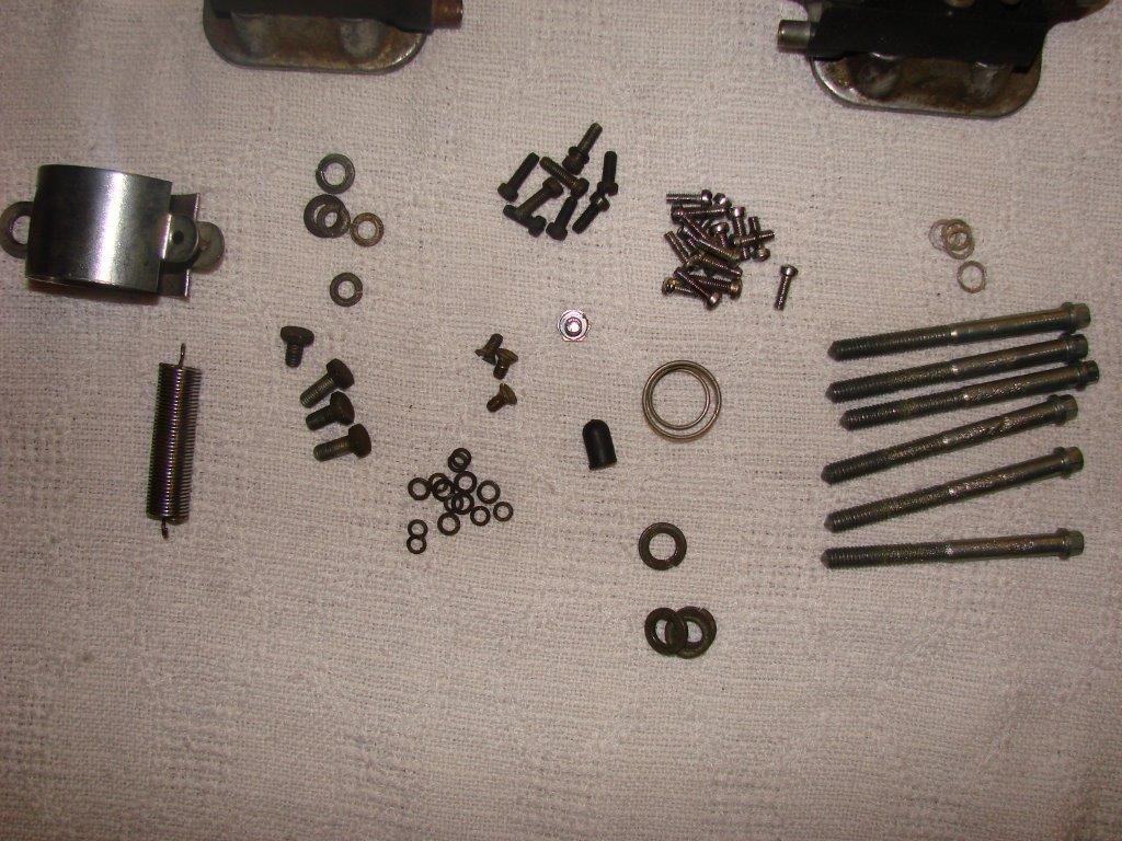

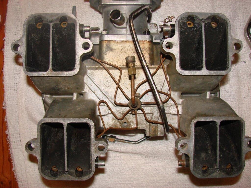

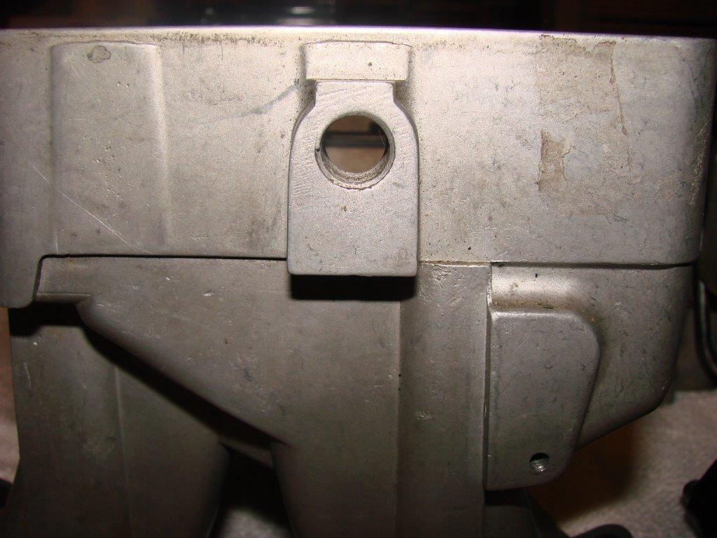

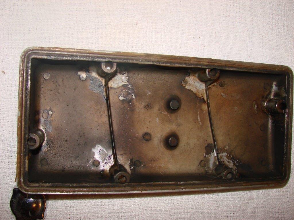

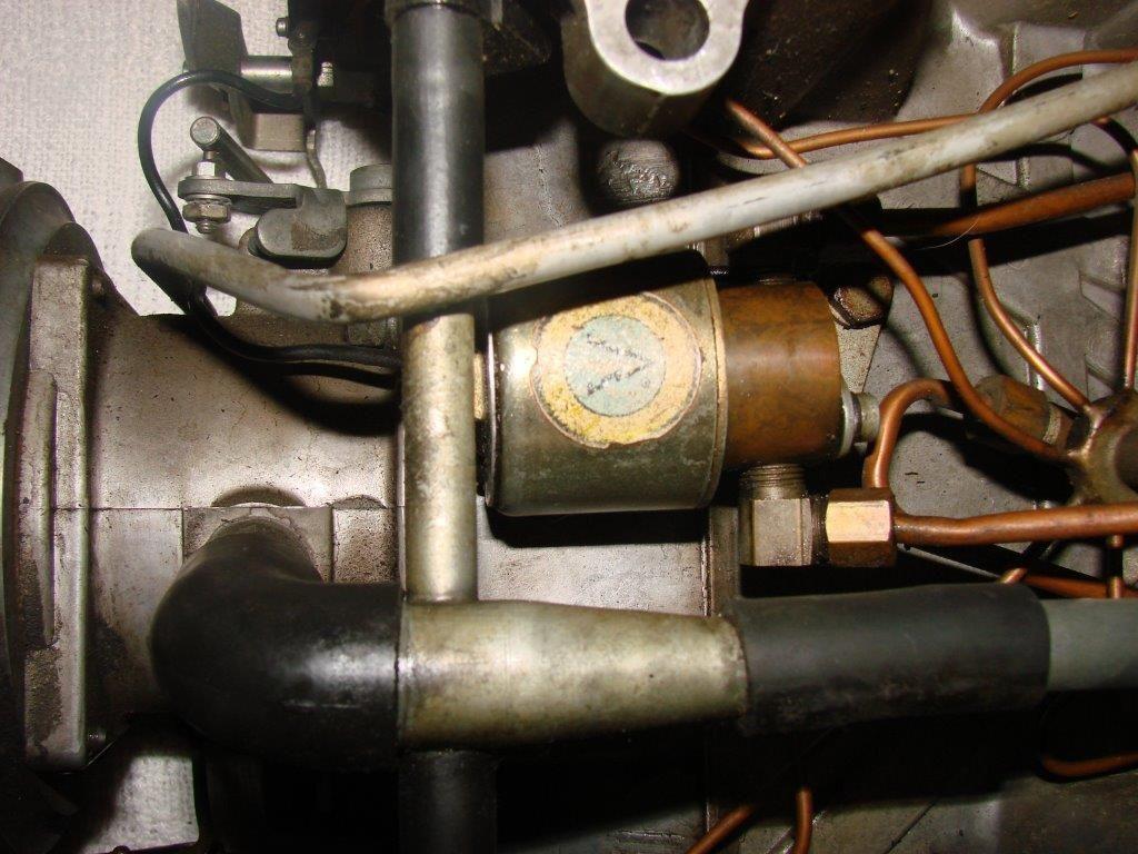

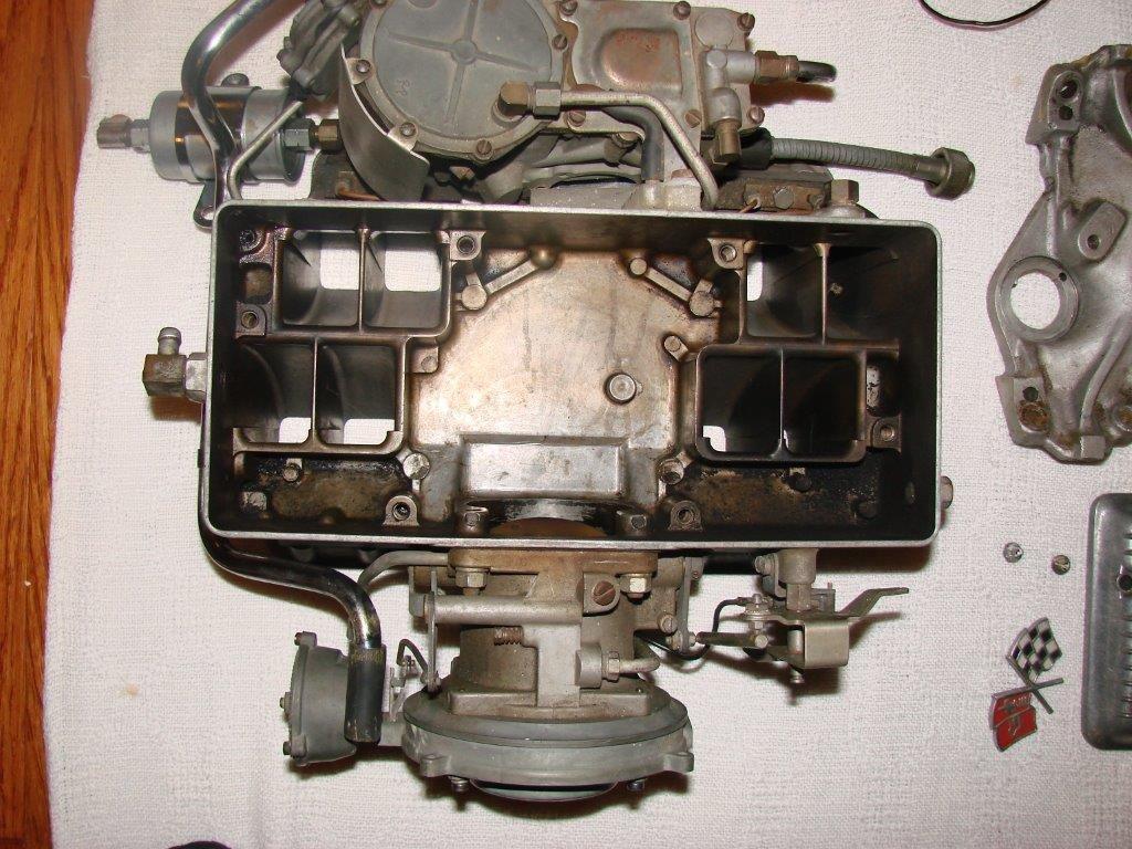

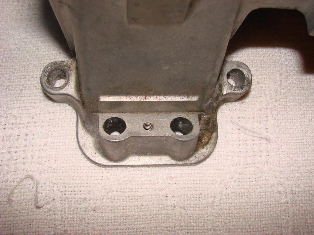

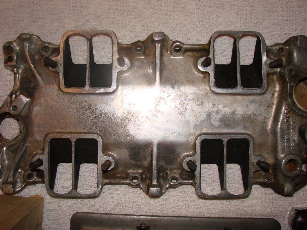

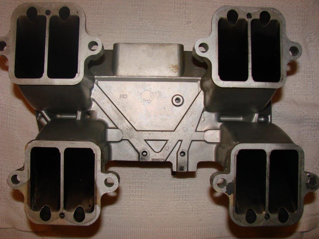

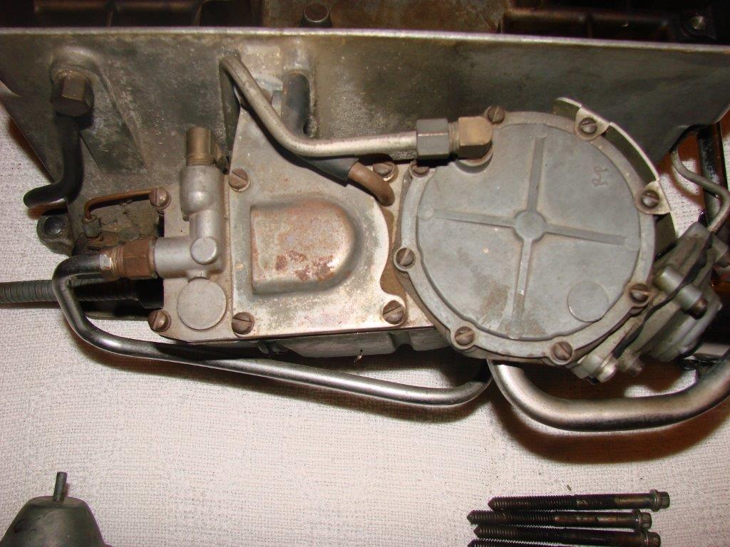

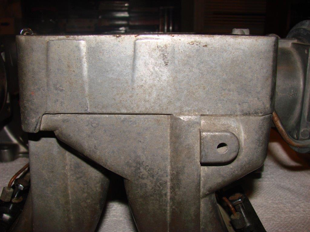

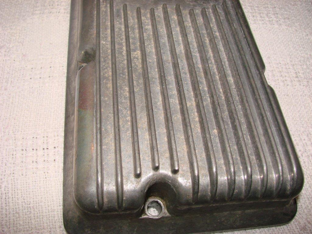

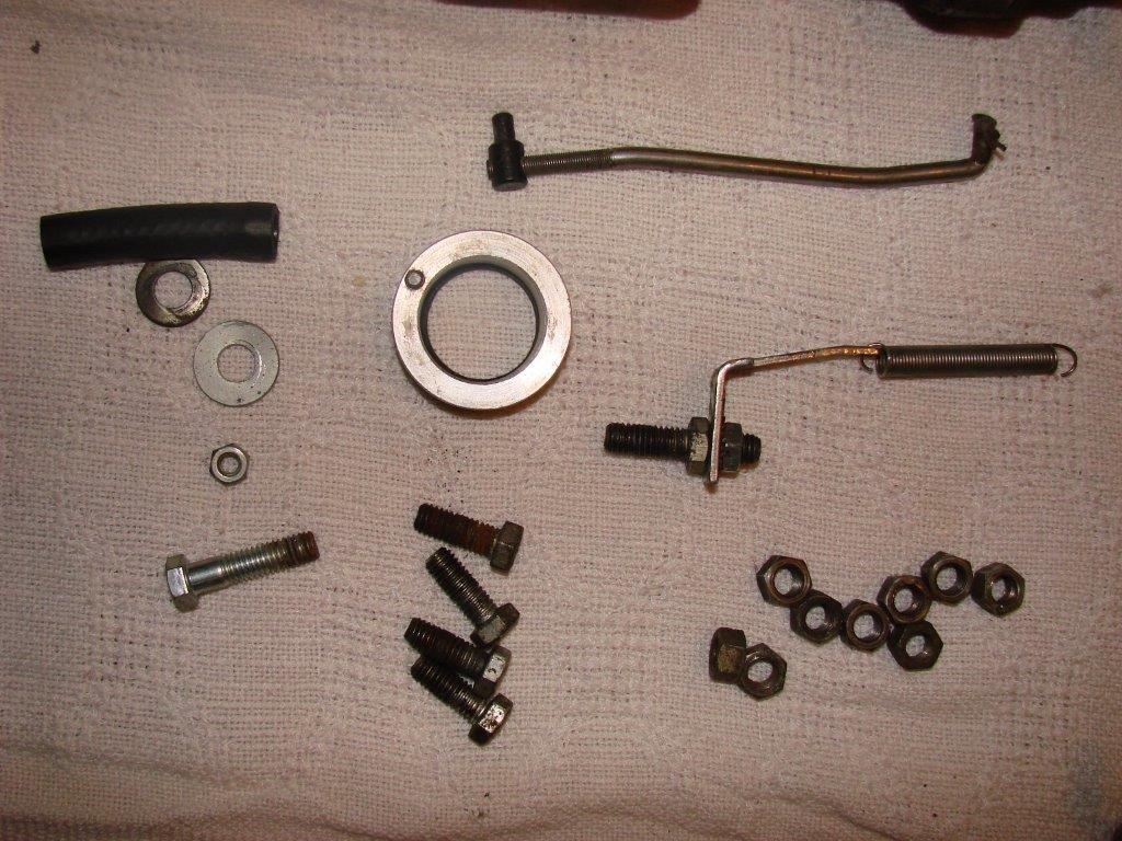

OK, here is everything that I have related to the three different Rochester FI systems that I have
1. A bare 1964-1965 plenum, with welded feet repairs.
2. A 1963 7375 unit with a polished manifold, nice air meter, nice plenum, nice lid, and a few assorted parts
3. A 1964 7380 unit complete (as best I can tell) with a 1111063 distributor and a 1957 vintage air cleaner
Here is a boatload of pictures of all of these systems.
Everything laid out
1964-1965 plenum with welded feet
Welded feet
More welded feet
No tag on this plenum
Bottom of this plenum
1963 7375 partial unit
Including an NOS Venturi
A very nice lid
A polished plenum with the casting numbers removed
And assorted parts
Nozzle blocks for the 63 unit
Air meter for the 63 unit
Bottom of the 63 unit with the spider
1964 complete unit
1964 Fuel Meter
1964 Air Meter
1964 1111063 distributor and fuel line
Distributor tag
Assorted parts included the distributor spacer
Nice 1964 manifold
1963 lid fins
Underside of the 1964 unit
Details of the underside
More details of the underside
Underside of air meter
1957 air cleaner
Date code on the 1964 manifold
bottom of lid from the 1964 unit
bottom of lid from the 1963 unit
flattened fins on the 64 lid
Nice 1963 lid
Back opening of the bare 1964 plenum
Back opening of the 1963 plenum
1964 on the left, 1963 on the right
1964 has hole for PVC
1963 does not have a hole for PVC
