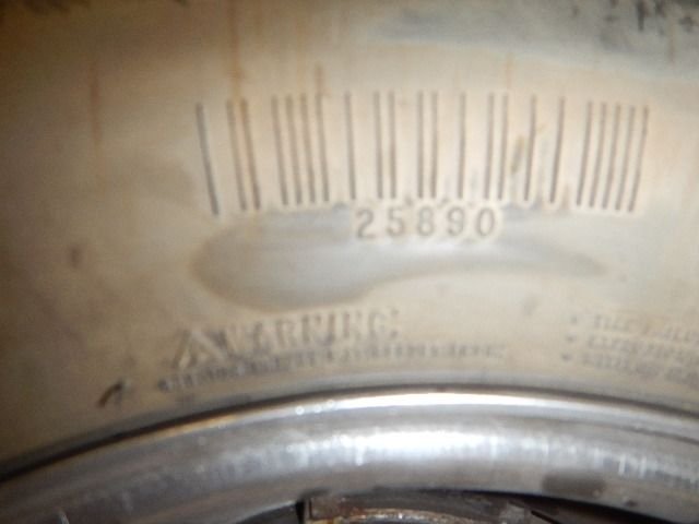

Here's what happens.... QUICKLY to old radials. This one let go on the front end of my 56 Chevy driving home from a local cruise. Started thumping about 2 miles from home. Nursed the car back at about 20 MPH..
