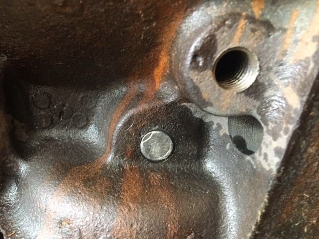

Just got my 327 back from the machine shop after a full rebuild. I was priming the engine for installation and noticed a leak from the galley plug directly above the oil filter. It is a 3/8 press in plug. Should it be? I figured this would be a threaded plug.
Pic of plug

Threaded pipe plug on later blocks. Early ones like this were press in.

If removed by the Rebuilder.......Have him pull, clean and replace.....While the block is accessible.......If that is not the case, IMO......I would remove, clean the galley, mud up the replacement plug with a high heat gasket maker and press in.......Remember....That is what I would do!!!!! I haven't removed and replaced a "Freeze Plug" for 50 years....(912 Porsche Engine rebuild).....LOL!
HELL, after looking at the picture.....It could be that the plug was put in backwards????
Others, Please chime in.............
Good Luck!!

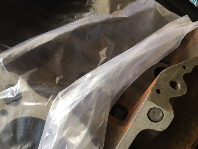

Pic from when the engine came out. Looks to be a screw in plug. Hard to tell. Maybe I should just pull the galley plug out and see if it is threaded behind it

Look at my edited statement......I believe the concave side of the plug should be facing out prior to being punched into the galley...I can't tell if that is the case from the picture......You would need to pull to see if it is threaded. If it is....then check to see if you can start a tap to check for thread damage.........

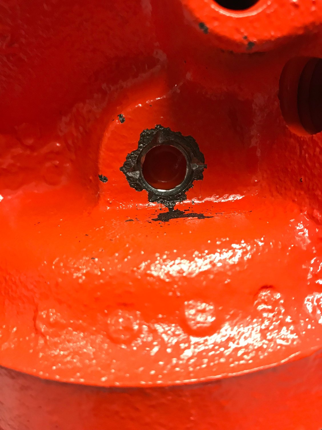

Thank you for the reply. I pulled the old plug out and bought a plug. I coated to with sealant and pressed it in to the step in the back of the hole. The one that was there was only pressed flush with the bore, so I am hoping the sealant and the fact it is pressed all the way to the step works. I am letting the sealant dry overnight to be sure.

You might want to put some JB weld on the outer side also as this is a high pressure port and you don't want it to blow out and lose oil pressure to the mains.
