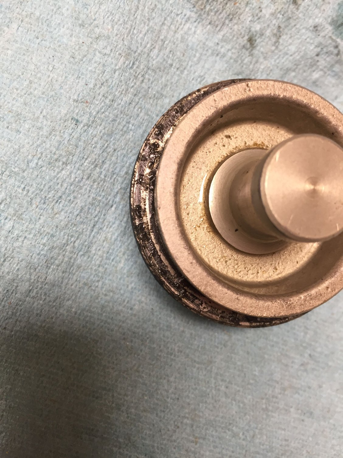

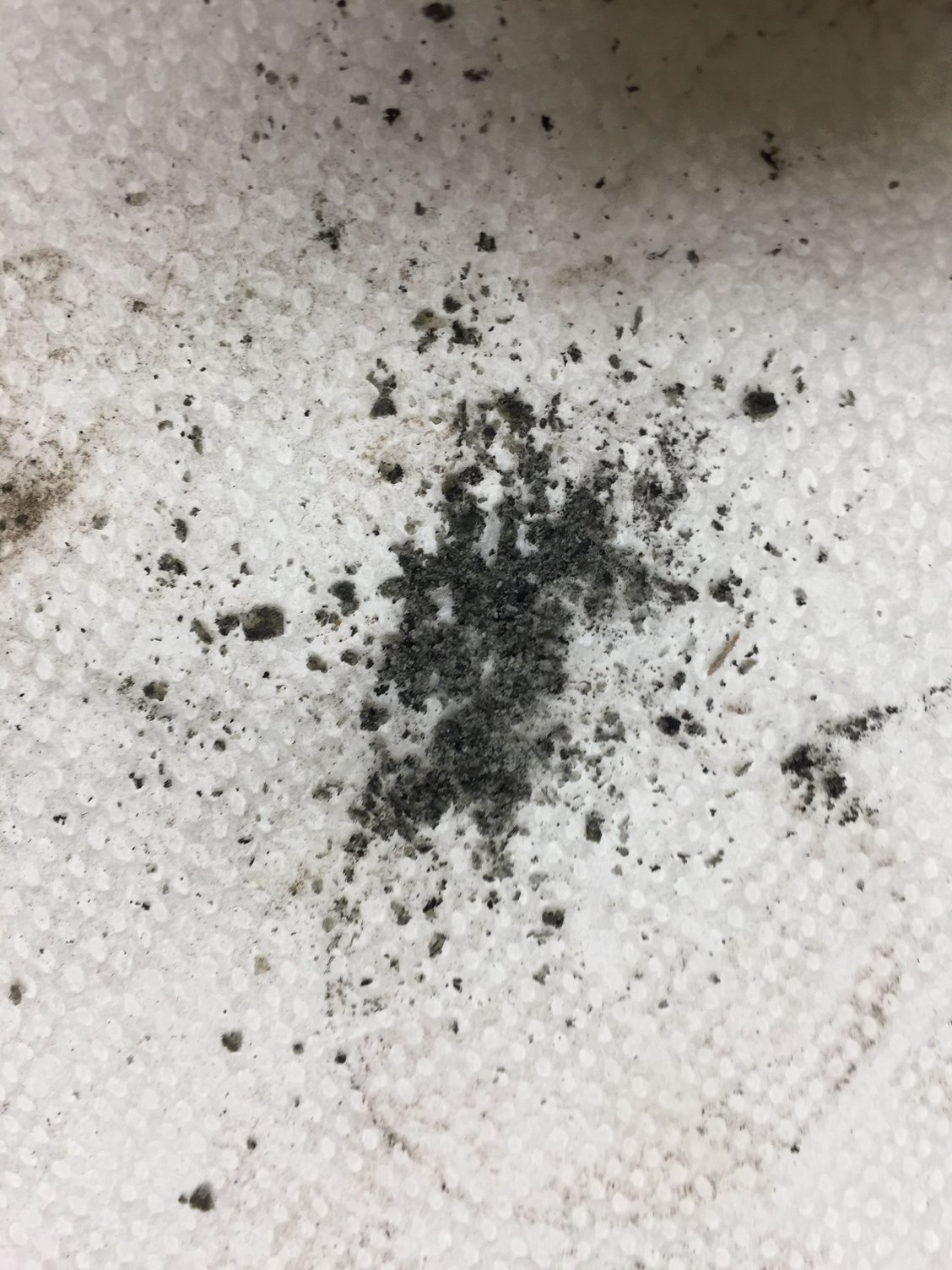

Many years ago...and I do mean MANY, I had my calipers sleeved and converted the system to silicone. I don't think it even had a DOT designation back then. Anyway I never liked the pedal feel and at some point probably 10-15 years later I converted to a dual M/C with booster and attempted to flush all the silicone out and use a DOT 3/4 synthetic.
I did NOT remove the calipers and only flushed the system copiously with new fluid but now another 10-15 years after that I believe I'm seeing the downside of not tearing the entire system apart. Over the last few years I've had the occasional leaking piston and each time what I've found is a buildup of some contaminant under the lip seals that allow fluid to seek past under pressure. There's no other trace of it anywhere else in the system other than what's trapped under the seals.
While I can't say for certain what it is, I suspect that flushing a system will not remove all traces of silicone and especially that trapped in such places and over time the result is what I'm experiencing. So to be absolutely safe, I'd advise anyone considering a change from one type of fluid to another, do it the right way and take everything apart and clean each and every piece with an appropriate solvent.

If you'd left the Dot 5 in there, likely you wouldn't have that problem.
What you see there looks like corrosion caused by water in the system. Silicone repels water.
What you see is typical of systems using Dot 3-4 fluid.
Yes, I realize silicone repels water but this isn't corrosion. What you can't see in the picture is that the buildup on the pistons is a bluish gray translucent material and it will flake off and the aluminum surface underneath is unblemished. The original pistons I replaced 40+ years ago all were corroded in various degrees but this isn't the same.
Perhaps it isn't a compound created by mixing the two fluids, I can't say for sure but I don't have any other explanation for it.

It didn't look like rust to me, more like some gasket/thread sealer or an internal "soft" component that the brake fluid attacked over time... You may never know for sure...

Originally Posted by 65air_coupe
BTW, I've been running synthetic DOT 4 for close to twenty years without issue until this which I believe is the result of doing a less than complete cleaning before changing over.
Could it be that what you see there is the normal sloughing off of lip seal material? The lip seals do wear.

I don't think so, the bigger pieces were under the inner surface of the seal and stuck pretty well. There are even impressions in the seal. The seal lips themselves look fine (there's joke in there somewhere, I'm sure) and it's easy to see how the fluid gets past the seal by going under it.
