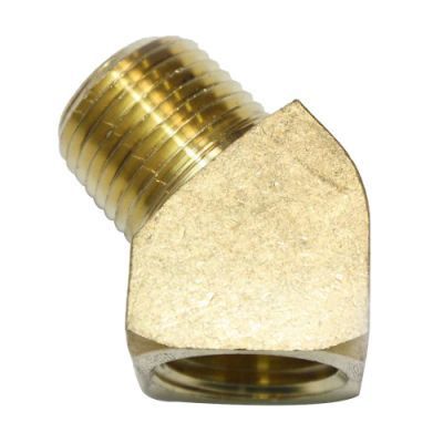

Try a 45 degree elbow. It’ll give a better angle.

Yep, that might be the best option and thank you Dan. Although the 45 might solve the issue, why does this kit come with a 90 degree adapter that won't work.
Also, that would be assuming the threaded portion on the hose is the same as a brass fitting.

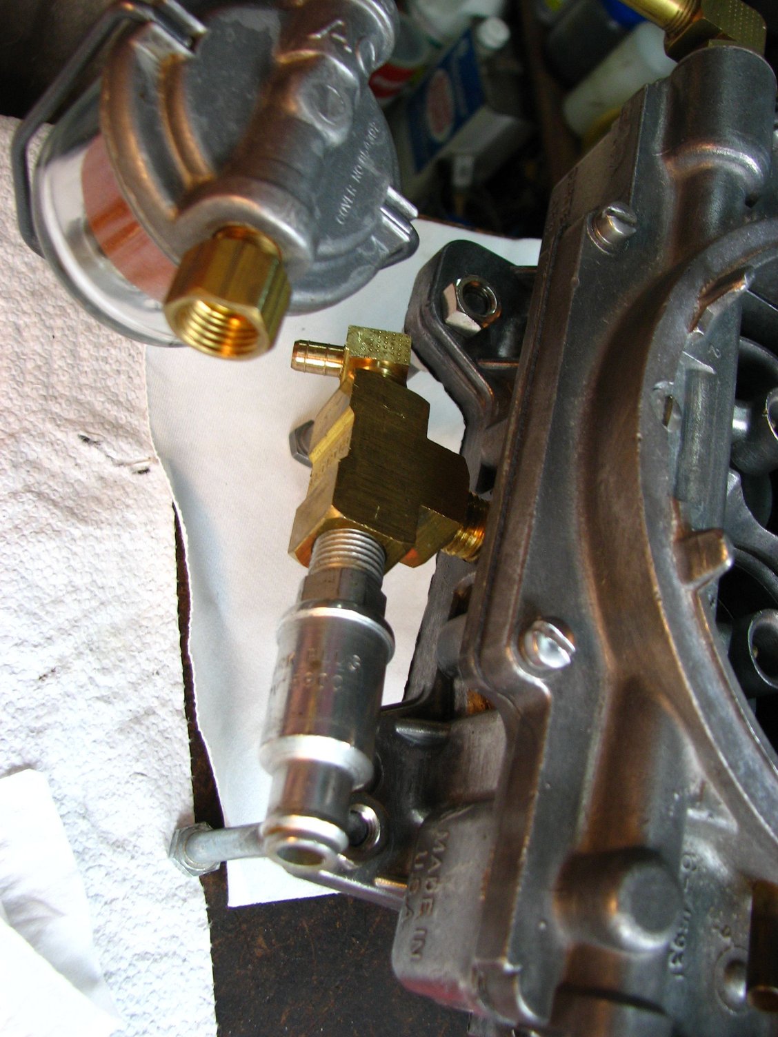

Not to be critical, but with that extension your PCV and hose are a lot further outboard than typical. Maybe you could try a set-up like this, using a Tee with FM 1/4 pipe threads. I added a bushing where it goes into the rear of the carb to move it out. The 1/4" hose fitting is for a vacuum gauge I'm using, so it could either be plugged or used if you had power brakes.
Don't be confused by the fuel filter location. The carb I'm using has a rear fuel inlet and it's plumbed correctly for the application.

Glad it worked out. My vote would have been to replace those long, long studs with stock carb studs, or even use a bolt on the one flange instead of a stud. Those are about the longest carb studs I've ever seen!

Yes, I thought so too. I just wanted to get it back together and check it out for leaks, but shorter studs are on the "do" list. The close nipple only put the PCV line out another 1/2" and doesn't interfere with anything........so far.
