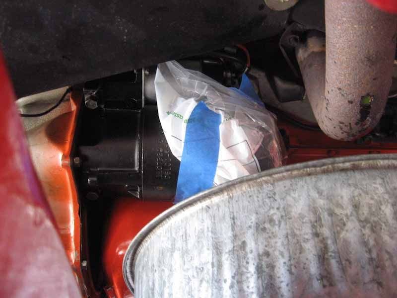

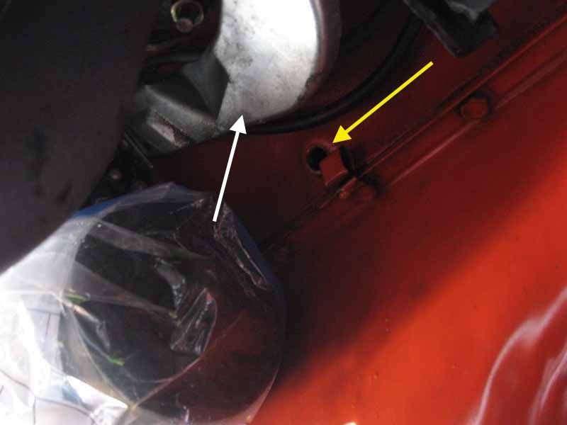

It really isn't all that bad moving the shields. The shield above the coolant plug just needs to be pushed up to give you access to the plug, yellow arrow. Note I put a plastic bag over the starter to keep fluid out of it when the plug was removed.
Here's a view from the side. The bag only needs to go over the nose of the starter. Blue tape sealed the bag to the starter. Good luck with it.
Thomas
