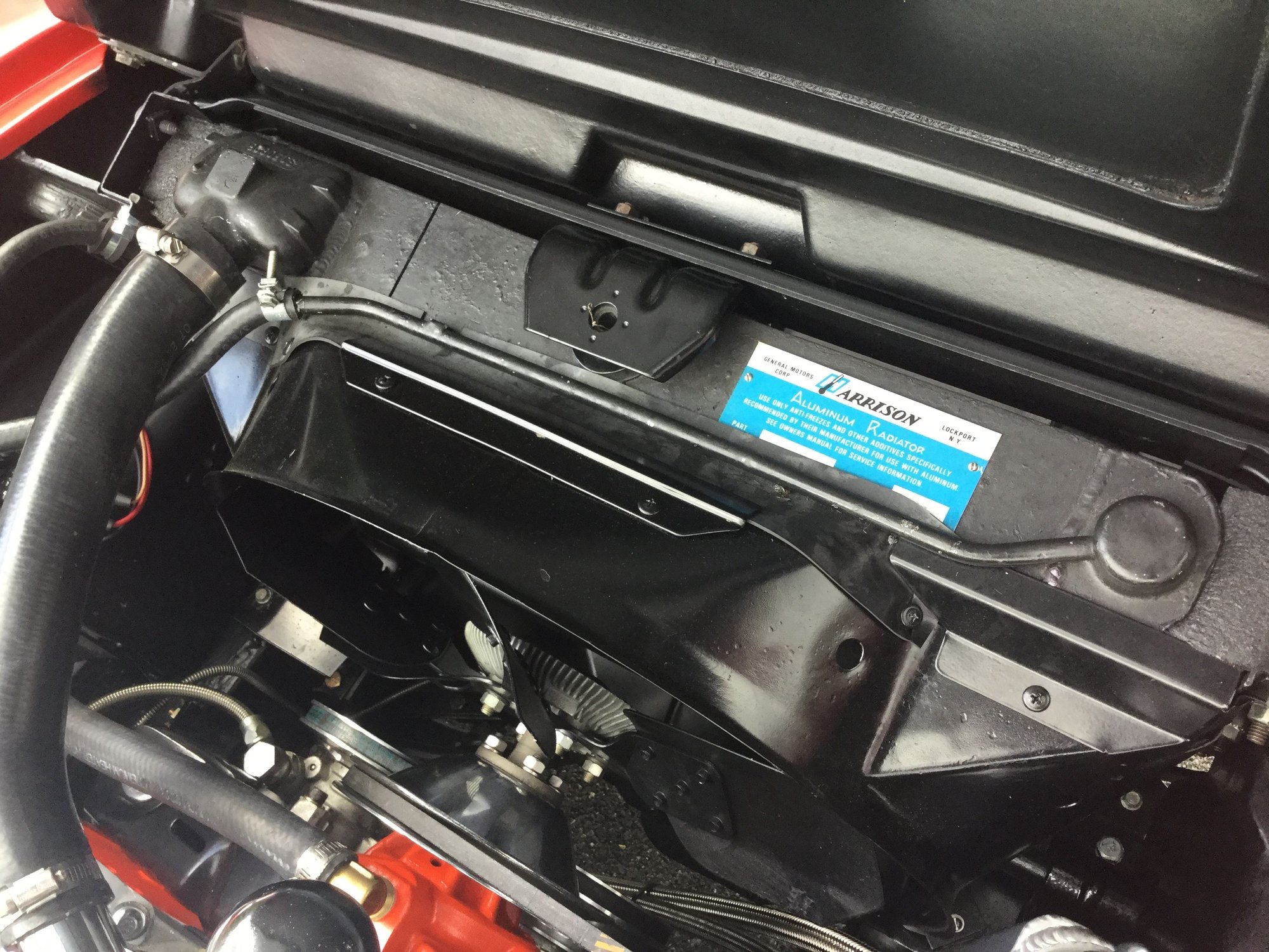

Does it look like you ahve factory GM water pump? Those pump fine at idle. Some of teh aftermarket whiz bang pumps don't pump anything at idle as they are designed to not over pump at high RPM.
Make sure the gaps between the fan shroud and the radiator are all closed.
I dropped pieces of black foam pipe insulation down the sides,and made something to seal the gap at the top. Your fan should also be half in/out of the shroud.

For max cooling at idle, you need to "seal" any gaps between the radiator and shroud. The air will take the path of least resistance, sometimes bypassing the radiator.
Some aftermarket radiators leave large gaps. Post a photo of your configuration..
Also, make sure your fan blades are positioned "1/2 in - 1/2 out" of the shroud"

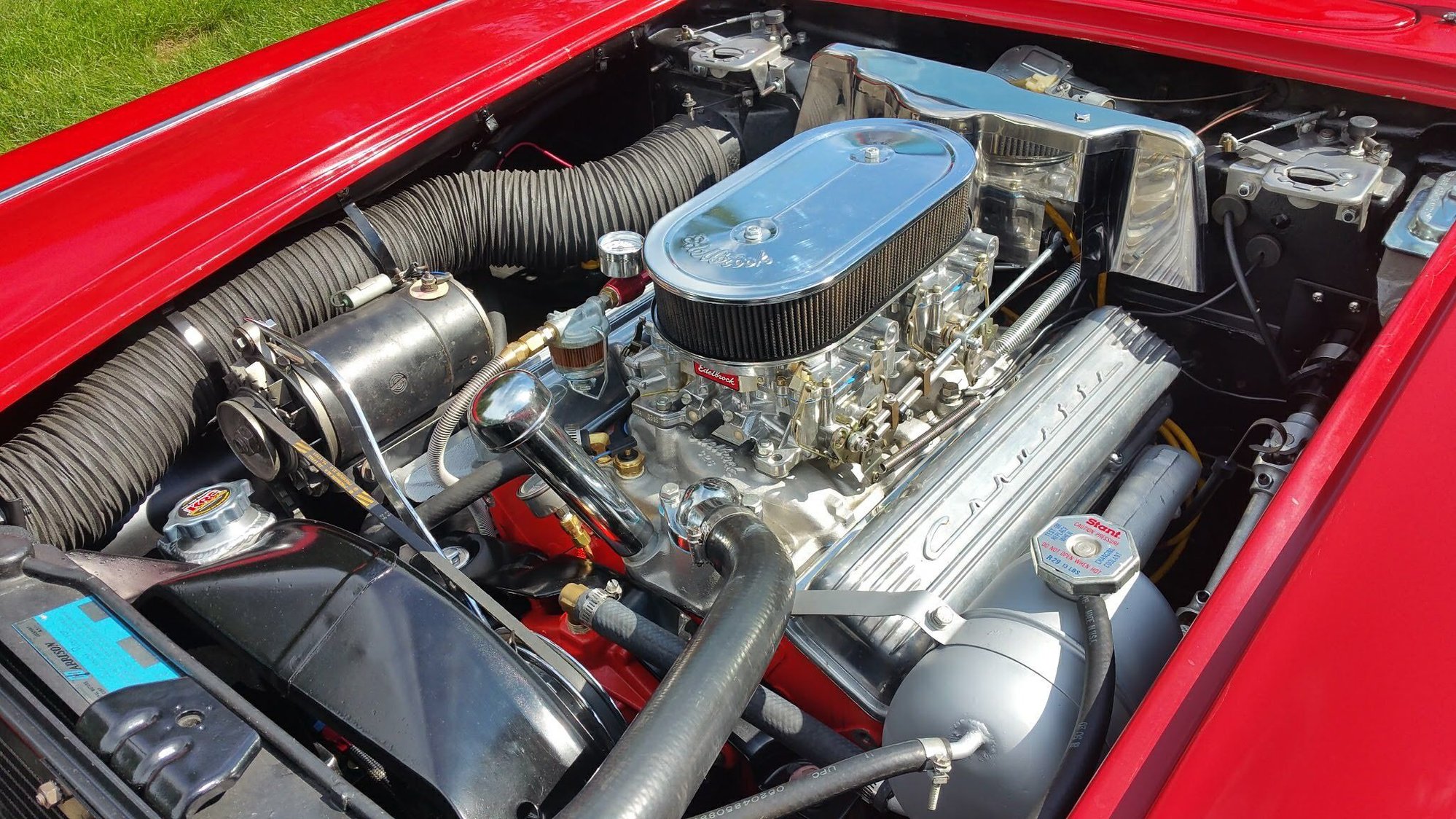

Originally Posted by Drothgeb
Mine rarely goes above 180, even when idling in traffic. This is with a 450hp 383. I give most of the credit to sealing it all the way around the fan shroud.
The block off panels on the top of the radiator: Are these parts that can be purchased or did you fabricate them?
Also, would you please post a picture of your engine. If I rebuild my 350, I've been thinking of going to a 383.

Originally Posted by 62 C1 Owner
The block off panels on the top of the radiator: Are the parts that can be purchased or did you fabricate them?
Thank you,
Mike
The rubber strips are the same material that the factory used to seal at the sides and bottom of the radiator. I just trimmed it to fit. I fabicated the metal strips holding the rubber in place from some Home Depot sheet metal. There’s also some foam rubber at the ends of the radiator.
Here’s a picture of the engine just before I sealed around the radiator. You can see how big of a gap there was.
