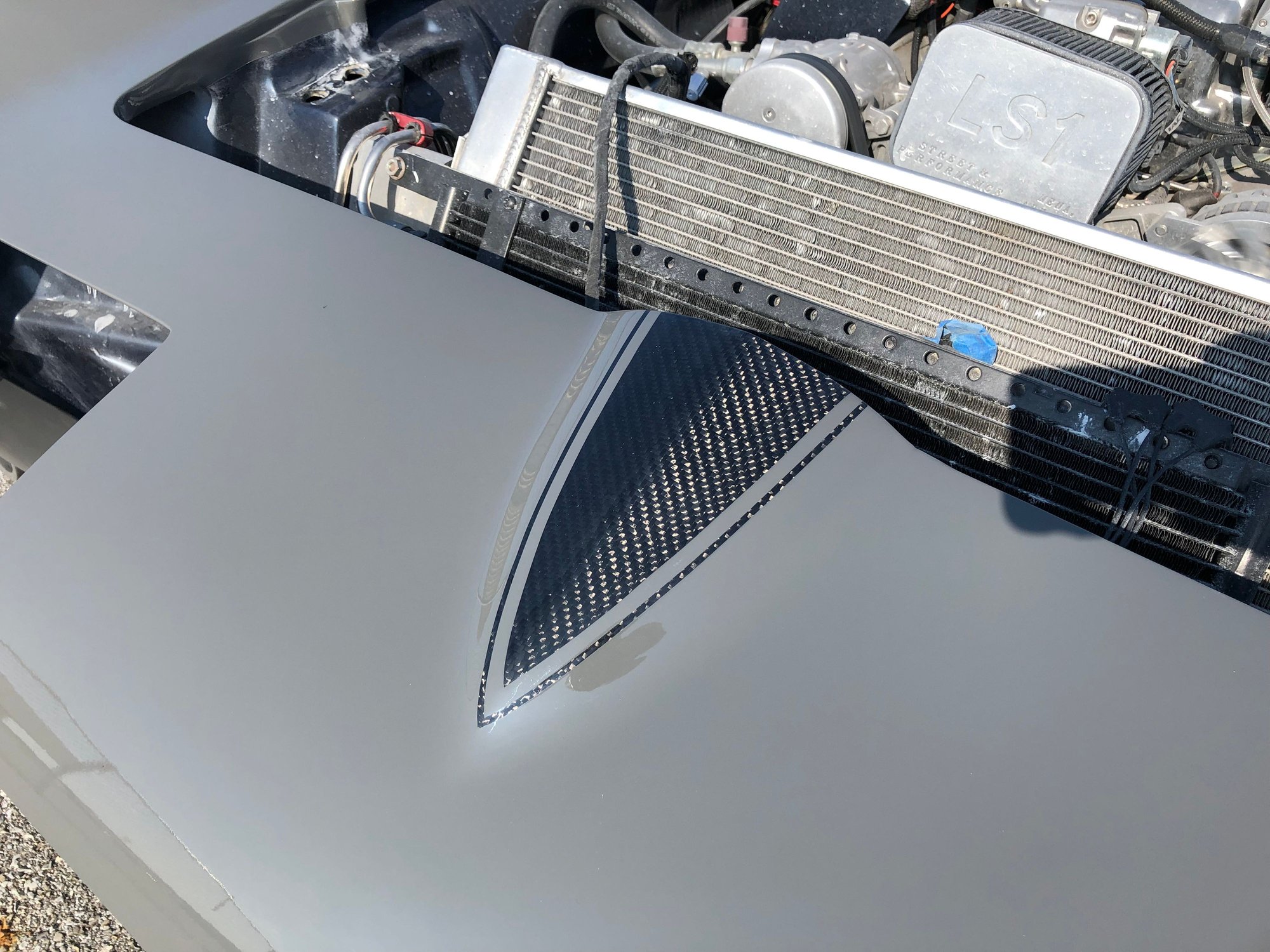

Quick update on the Carbon Fiber stinger, it’s laid and coated with resin, next up blocking the resin and prepping for paint and everything will get buried in clear.
The rear spoiler is also in process, I should have some updated pics in a couple days of the fiberglass spoiler we will be using to make the carbon part from.

Originally Posted by Not Red Rob
No senior moment on the gel coat, we have done it for years, sprays on like a sealer and blocks the same.
As for the color, its going to be polarizing some will love, some will hate, I’m willing to gamble on it.
I think the term gel-coat is throwing him off. It looks like you're using a polyester like Slick Sand or Feather fill. I did mine in Feather Fill 3 times. Great product.

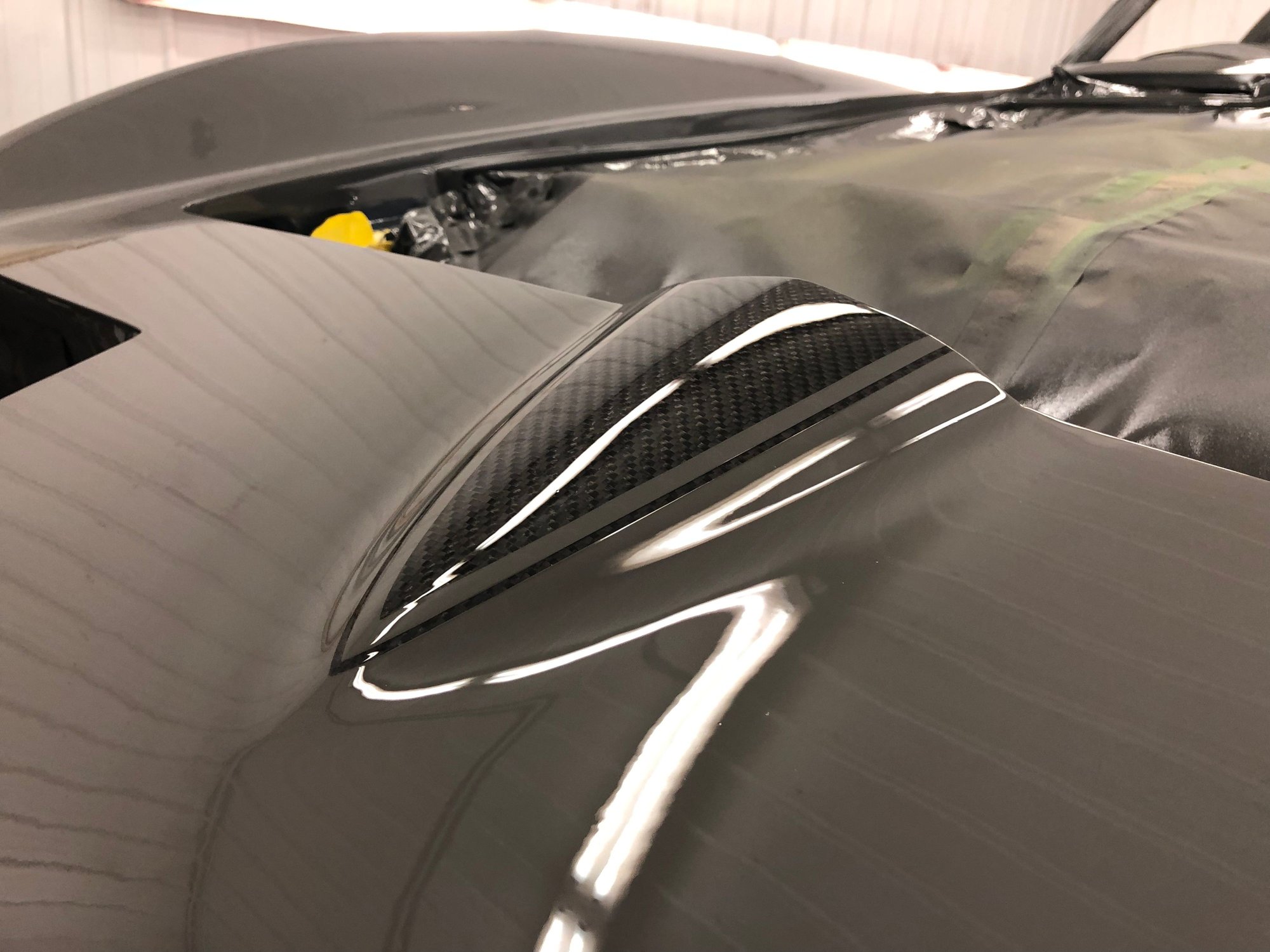

Finally in the booth to get painted tomorrow, the carbon fiber was a lot of work, hope the result is worth it. Can’t wait to see it painted.

Finally in paint!!! The Carbon fiber looks amazing, defiantly worth the effort.

for the carbon fiber, did your team bag it and pull a vacuum on it? did they use 2 part epoxy or did they use polyester resin or ?
They did a great job.
At Good-Guys in Columbus there was a Charger that the entire body was done with carbon fiber....they did a nice job matching up the various parts (hood, doors, deck lid, etc) across the body and weave. A lot of work went into it for sure...

I saw the Charger at Goodguys, it was incredible! We overlaid dry carbon fiber with epoxy resin for a total of 4 coats blocking between 3rd and 4th coats followed by wet sanding down to 400 before clear coat.
The hood still needs a little prep and finish sanding, hope to have it in paint early next week. I could not be happier with the finished product.
