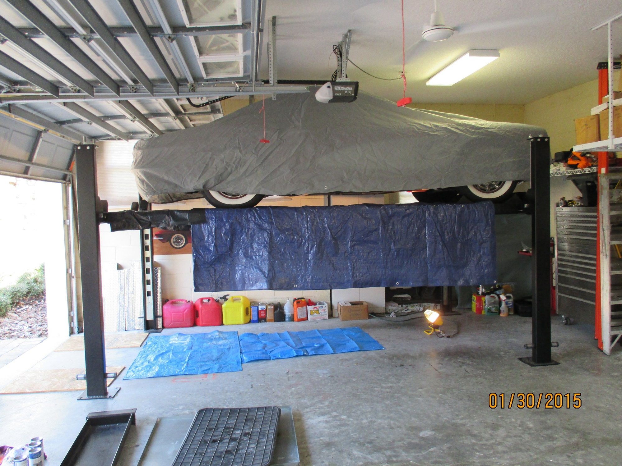

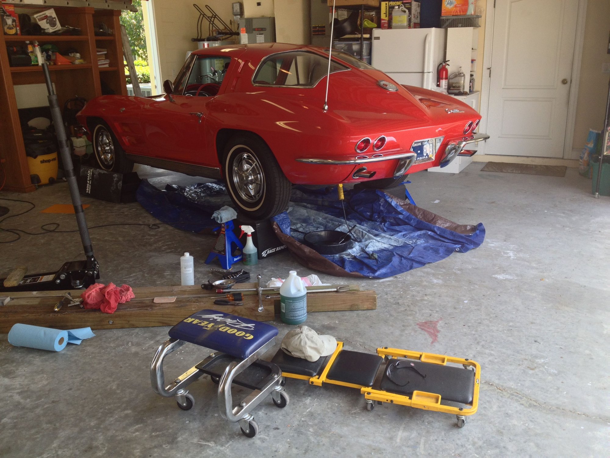

Absolutely - I've done it on two cars...one on a lift and one on ramps:
You can coat about 98% of the frame internals - maybe more.... Draw a line about 6" from the end of the spray nozzle with a black Sharpee so you'll know when you're close to withdrawing it from the frame. STOP PRESSING THE BUTTON when you see the mark as the stuff will still flow for a few seconds after you release pressure...
This will keep you from jerking the brass spray tip out and shooting that green, sticky goo all over the place...
There are Youtube videos on the proper technique, but a extending the spray tube into the frame as far as possible and holding the button down while stroking the nozzle back and forth gradually moving closer and closer to the exit is basically it.
