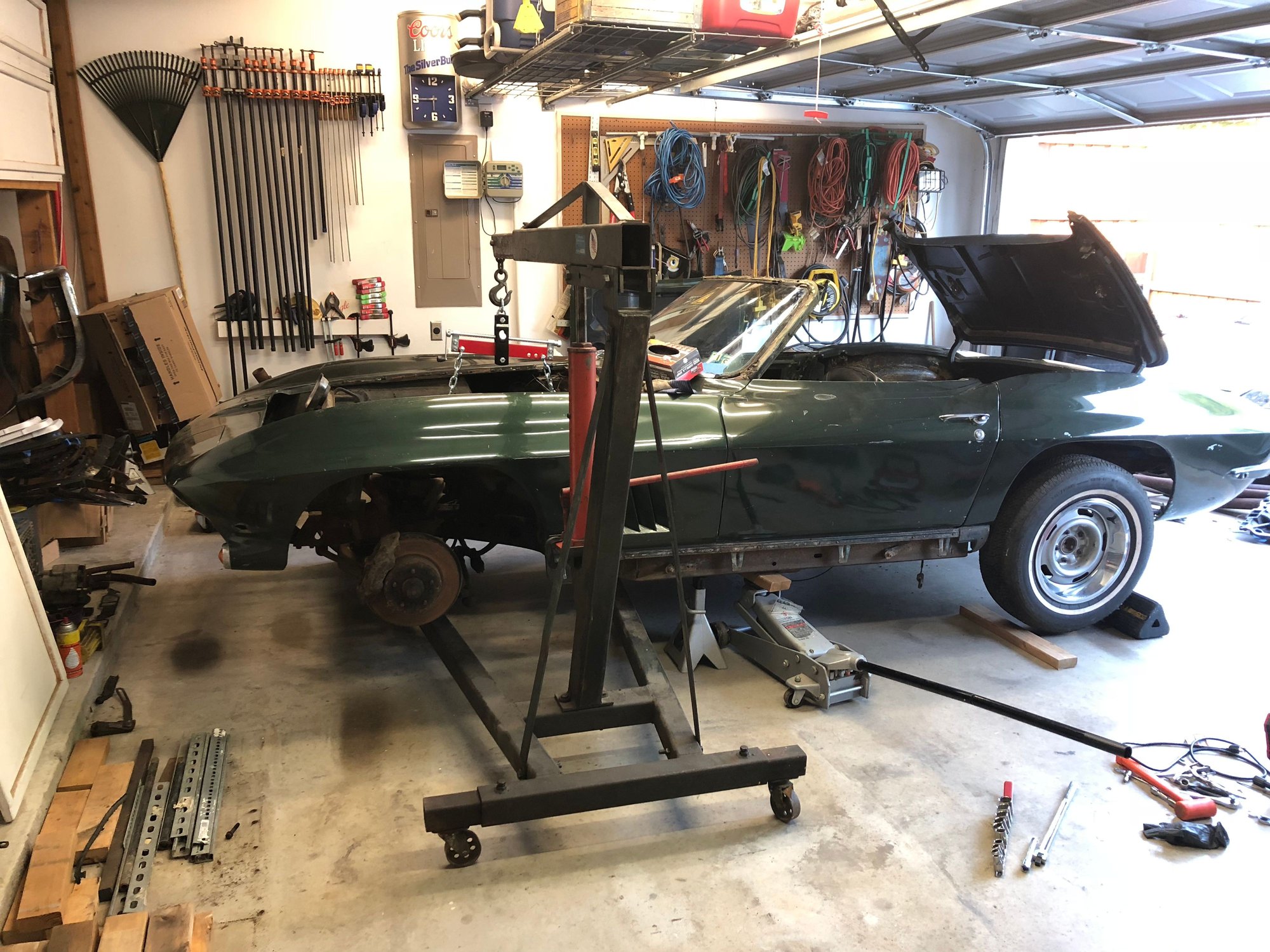

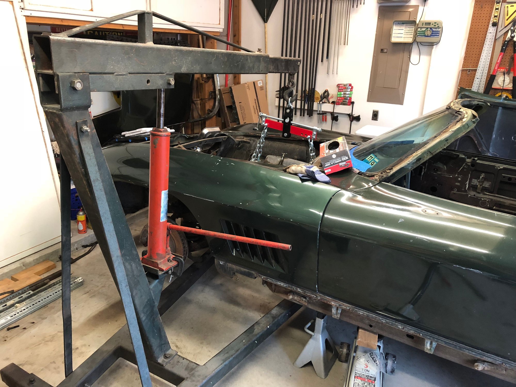

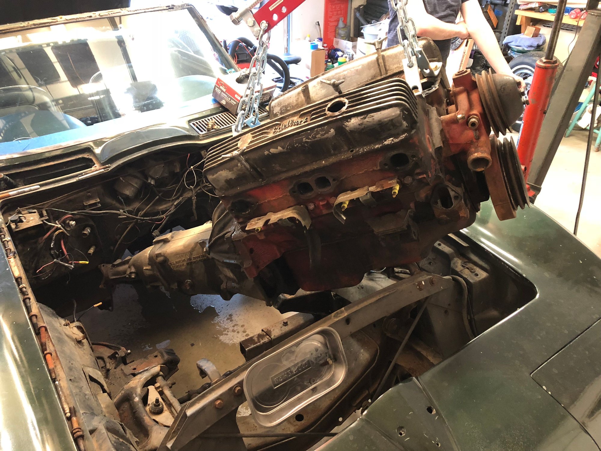

I jacked up the driver side, removed the front tire and went from that side. I didn’t do anything else.

After looking at the pictures, I may have jacked the whole front up and took off both front tires. I can’t remember now. I guess sometimers is setting in.
