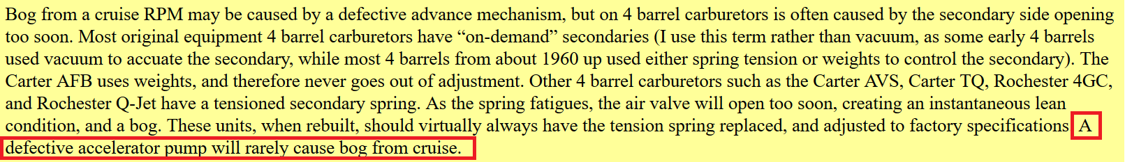

A bog from cruise is a faulty advance mechanism or secondaries opening too soon. If the carb is an original WCFB with the proper weights and springs and the car's vacuum is to spec the secondaries shouldn't be a problem. I would check the vacuum advance...
From "The Carburetor Shop" - they've only been doing this stuff for 45 years.
