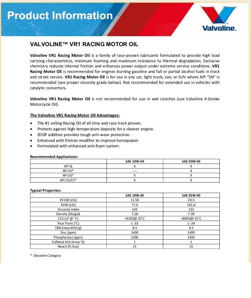

Old Aug 31, 2019 | 09:25 AM
SWCDuke's Avatar
SWCDuke
Posts: 12,712
Likes: 2,271
I haven't looked at the VR-1 spec sheet for awhile. It's online, so if you are considering using - look it up and post it here. I recall it's rated SN, but as I pointed out in the oil article, if the winter viscosity rating is higher than 10W, the S-category P limit does not apply.
A true "racing oil", meant exclusively for racing engines that are torn down for inspection frequently lacks the detergent and dispersant additives required for long term use, so they cannot have an API rating of any kind.
I don't think the CK-4 rating has reduced the P limit, but some manufacturers have chosen to do so with the addition of the boron-based anti-wear additive. You have to review the spec sheets, which are online for the major national brand and maybe some of the dozens of house and private label brands.
Duke
Old Aug 31, 2019 | 12:41 PM
SDVette's Avatar
SDVette
Joined: Jan 2000
Posts: 5,074
Likes: 1,558
From: Poway CA
2025 C1 of the Year - Unmodified Finalist
2022 C1 of the Year Finalist - Unmodified
2019 C1 of Year Finalist (stock)
2016 C1 of Year Finalist
Here is the VR-1 spec sheet.
It seems the VR-1 multi-weight oils (10w-30, 20w-50) have "SL", not SN.
Looking at a bottle, I don't see ANY rating on it.
Not sure if it's internet rumor or not, but I heard that California was not allowing VR-1 to be sold, and some stores can't get it. Might be because of the lack of rating?
Healthy amounts of P and Z though!
Fred
