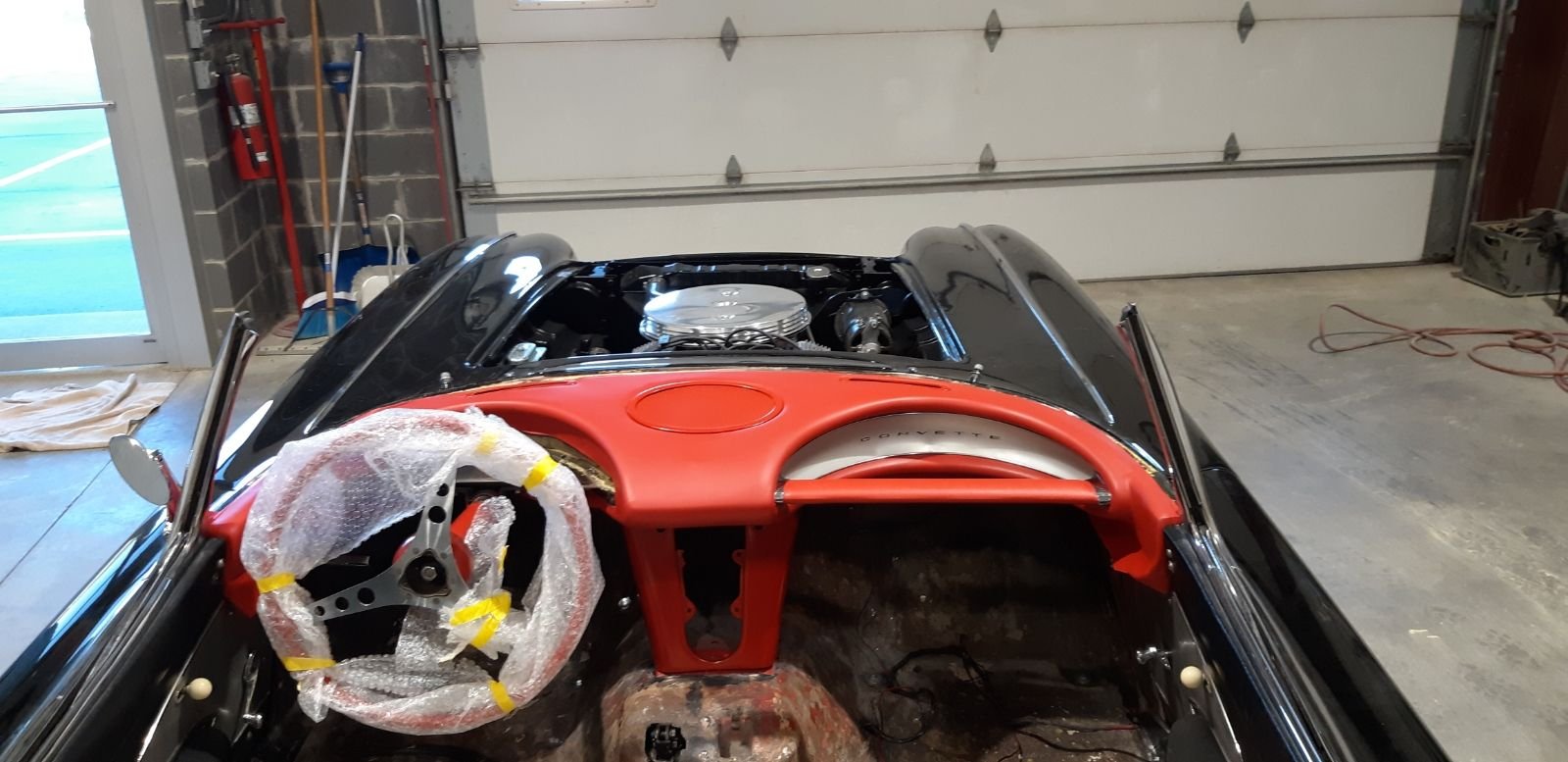

[C1] Almost done

Default Almost done

Very nice. Someday I hope to be able to say the same.

That is looking seriously sweet. Great work! Looking forward to seeing it when it's completed.

wow stunning
gives me some inspiration to work on mine a bit more

Chopper, did you use the yellow weatherstrip adhesive to glue down the dash pad?

No I sent it out to be done so not sure what they used for adhesive
Chip
I would certainly not use 'yellow death' anywhere on my car! Especially not on the dash pad. There are multiple things that help hold it in place,like the rear view mirror, dash vents, radio speaker bezel, passenger side 'boomerang', and the instrument cluster, where you dont need a lot of glue. Mostly where it rolls over into the windshield channel is where you need something like contact cement. And of course underneath. I was surprised how little adhesive I used.

Already did my dash and used a vinyl safe cement, it looks yellow in the windshield area and I was just curious.
