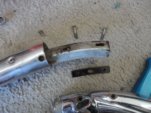

I worked the rubber and the header back down on the glass and now trying to "fish" the nut plates to start the two machine screws back into position.
There must be a trick to get them aligned with the holes in the corner post, short of removing the WS and starting over!

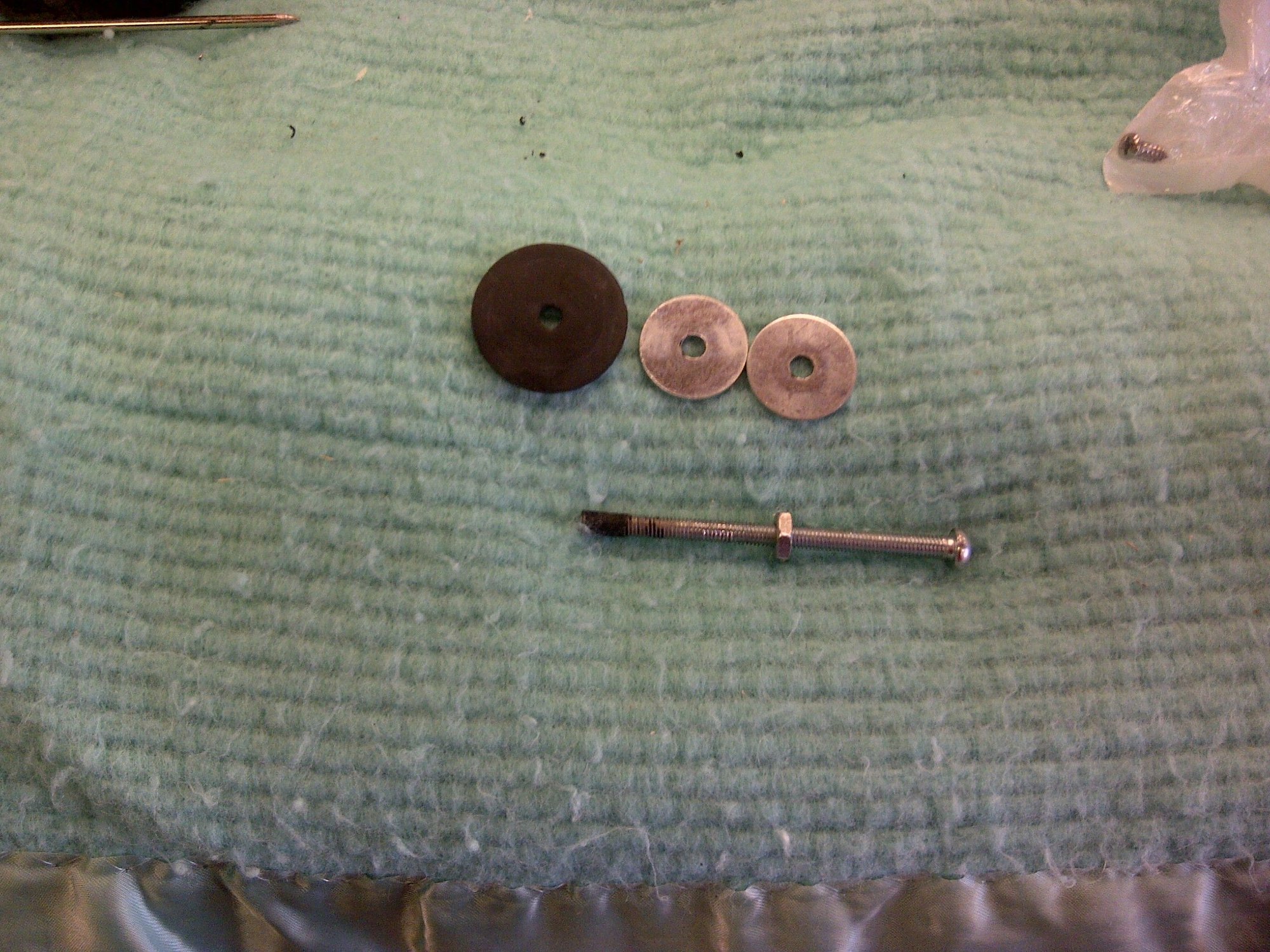

Get a good, bright, pen light, and shine it into the post holes. You should be able to see the plate, and if you're lucky, part of the hole. Assuming that the nut plates were installed tightly with strip caulk, you can use a sharpened "pick" to slide the plate to a point where you can see one of the holes. Put the end of the sharpened pick, into the threaded hole (don't push down too hard, or you'll chip the glass). Wiggle it into position. If you can't see either of the threaded holes, you'll need to slide the plate with the end of the pick. You're only going to be able to move it about 1/16" at a time, but it can be done. Once you get a hole "lined up", use a long screw (10X32 thread), to catch the plate, and pull it tight into the channel. DO NOT SCREW IT IT, OR YOU'LL BREAK THE GLASS. ONCE THE THREAD IS STARTED, PULL IT UP WITH YOUR HAND, AND START THE CORRECT SCREW INTO THE OTHER HOLE.

I tried the ice pick and wire to find the threaded holes in the plate, no luck, that was the reason for assistance

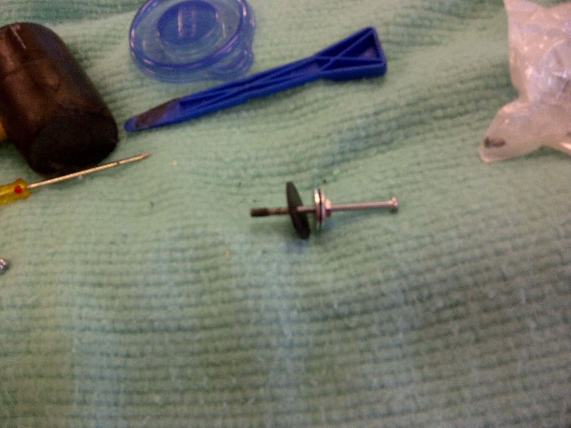

The screw Mike is talking about will look similar to this. If you put a couple of wider flat washers on the screw it will give you a little leverage to move around and to pull up once the threads catch. I also used a rubber flat washer so as not to scratch the stainless. Sometimes takes multiple attempts but it works. Once you get the first mounting screw set things should go better. Good Luck

Thanks for the pics CANDA
I have fished for the nut plates on and off for three days.
I unbolted the windshield today so it is going back to the glass shop
I want to see where those nut plates are hiding1
