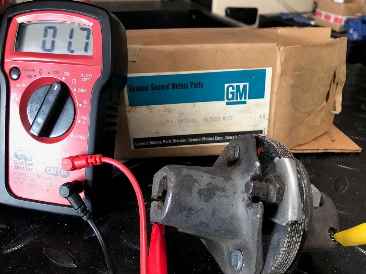

Does this look like the right material?
No. Look at the pic. above. Yours has 4 layers of cloth fiber, originals have 7.
