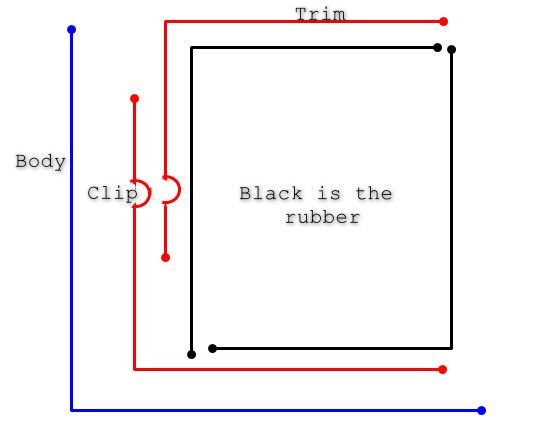

Here is a diagram of side view of the trim and how the clip interacts with the trim.

That is the strangest drawing I've ever seen - I can deduce nothing from it
But then I'm old...
Pretend you are looking at the setup end on. So if you were to take a chain saw and cut through the entire thing and look at the exposed end
You would see the Window Recess (Blue) The Clip which is tight to the window recess (Red) Then the Trim which is also Red sitting in the clip bubble.
Then the Rubber holding the window, which is Black
Capiche?

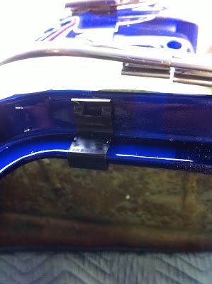

Take a look at LIC 57-12 clips. You can see the clamping portion that slips over the fiberglass lip. I believe it’s the same clip used on the hardtop rear window upper reveal.
Capiche?
Ok. I get it now.

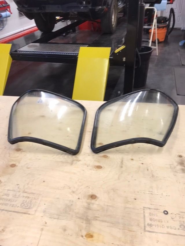

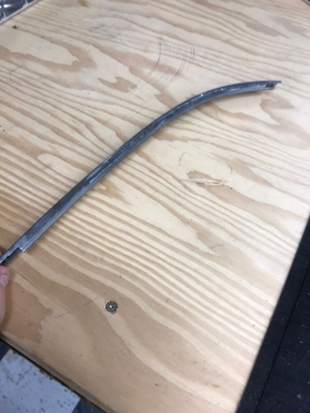

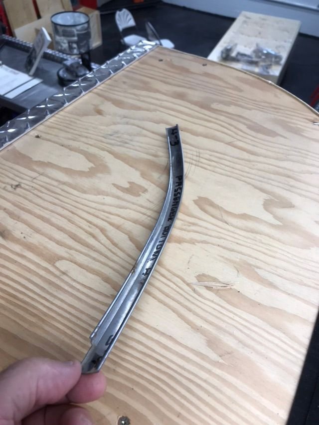

Old Sep 15, 2019 | 11:25 AM
TC233's Avatar
TC233
CF Senior Fox Bat
Joined: Aug 2011
Posts: 3,818
Likes: 619

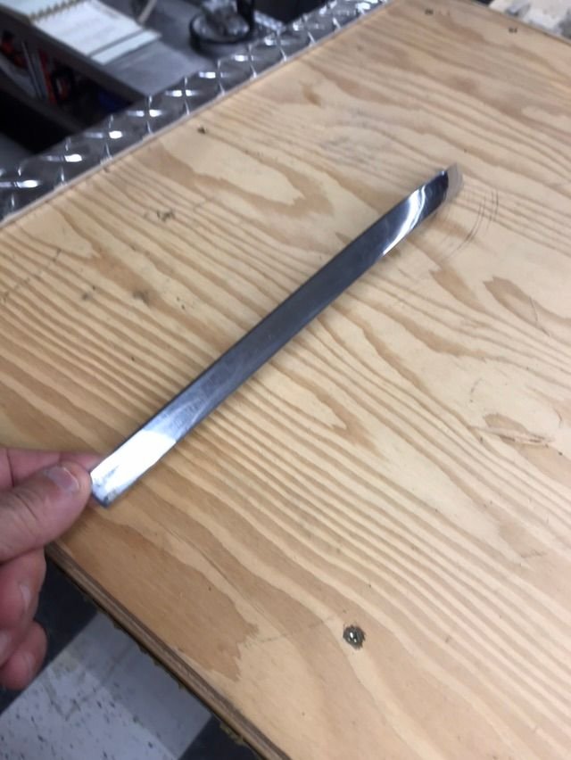

Here is some pictures of my trim. This trim piece is the piece with a slight bend that is closest to the tail lights. on both windows. between the lower corner pieces. Now the nice thing about the 63L cars with this trim is you can see where at the ends the trim clip ceases to exist. Thats because the corners snap into the body clip at these points and hold the trim ends down. So talking the corner pieces off first is imperative which gives you access to the individual pieces. Then assuming you were lucky like I was and the trim is between the rubber and clip then it pops out with ease. So in my case, because I have trim clip the entire length of the pieces, the body clip exact positions are not as critical, although important, and its likely why they changed the trim, so the assembly line guy did not have to be exact on his clip placement.
