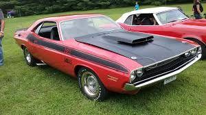

They say the '70 Challenger T/A scoop was one of few that got above the boundary layer.
Exactly. That and the 69 440 six pack car's hood. Even those with the ram air effect did little to effect the h.p.
