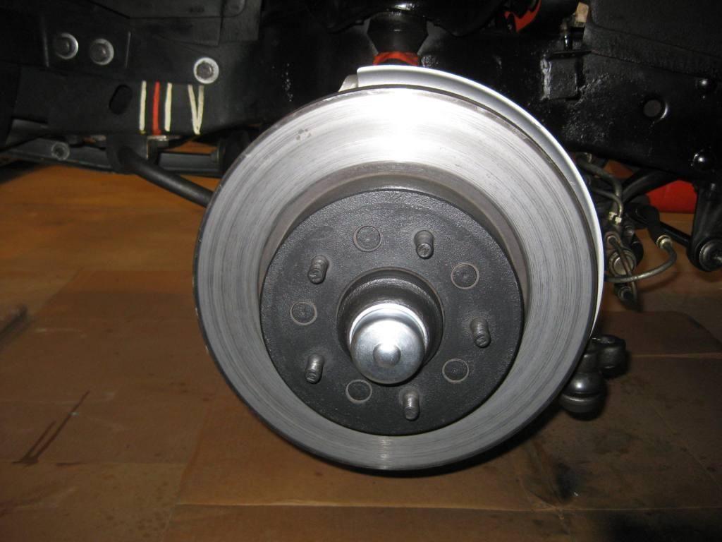

A photo or two of your interference/contact points would help. Perhaps the "tie rod end bracket" you describe is the steering knuckle arm? If so, maybe it's articulated incorrectly upon reassembly. Photos below. Should have a good 3/8-1/2" clearance all around, all symmetric.

Okay , okay, I was just to embarrassed to admit my stupidity. The skinny of it is that I had the bottom hole of the caliper bracket installed against the spindle instead of the steering Knuckle arm against the spindle and the caliper bracket against the steering Knuckle arm as it should have been. I looked at the driver side that I had just installed correctly a bunch of times but just overlooked the position of the caliper bracket. When I looked at the posted pictures I saw immediately that my caliper bracket was incorrectly installed and that was causing the dust shield to be misaligned. Thanks to all who posted responses and my apologies for failing to post the problem solution due to my embarrassment.
