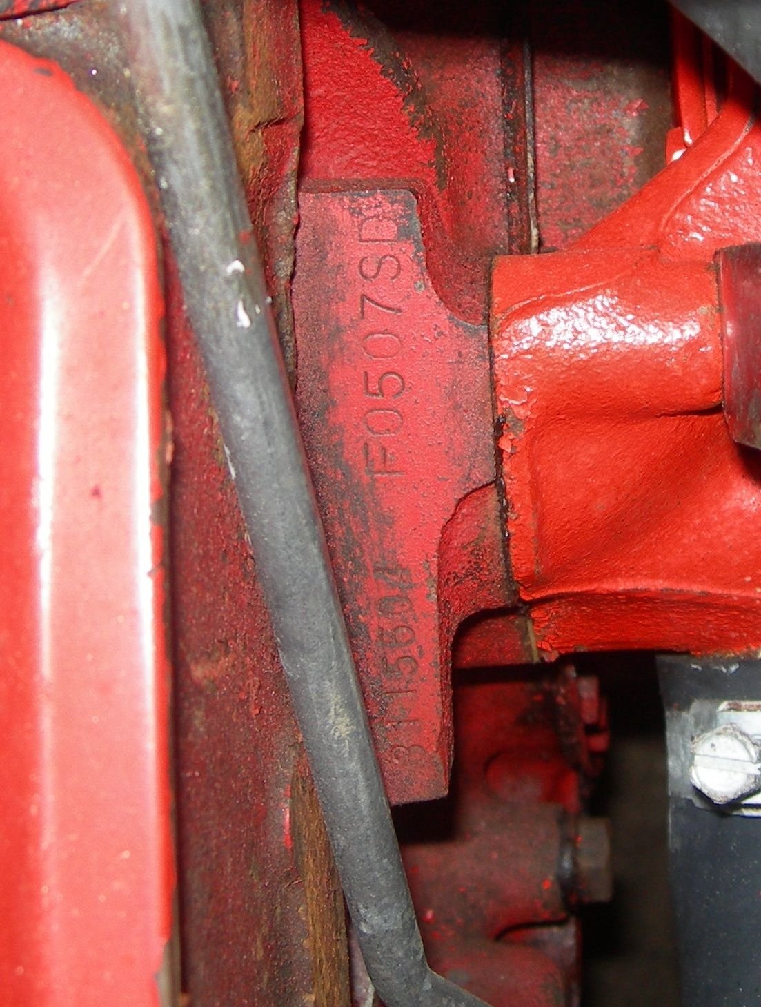

Hey Guys - Been meaning to post this for some time. Pls advise thoughts on this engine pad.With some effort, can locate additional photos if it would help. This does match the vin on the Borg-Warner T-10 4 speed. Thanks ya'll!

My vote is honest old pad....

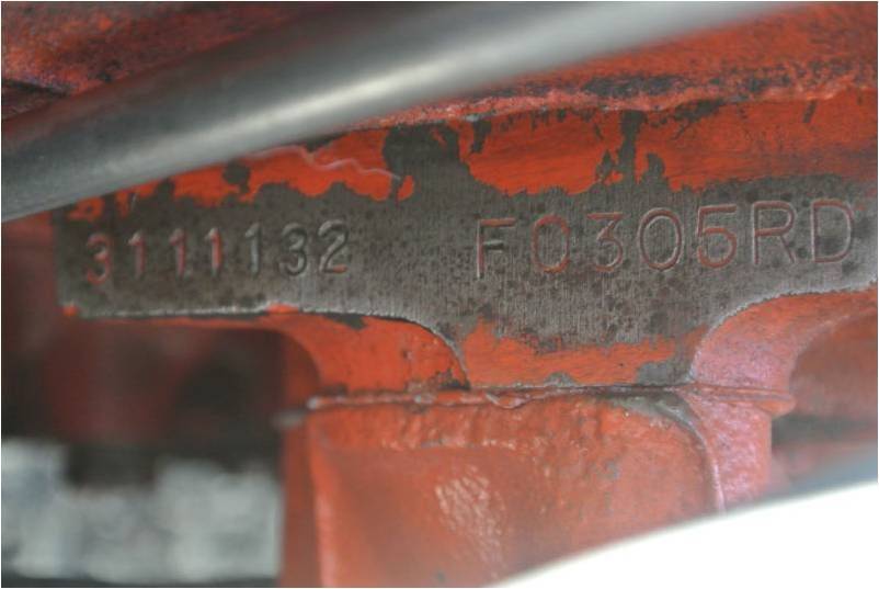

Here's mine-ur's looks good

Another example that looks identical...
Good luck... GUSTO

Solid pad, no issues.

I like this one.

Looks nice to me. Funny how the 300 HP cars tend to have nice original stamps, while the hipo
cars are shaky. The 340 and 360 HP cars must have all been built on Friday afternoons after the guys returned from the bar...

The pad is fine, font looks correct and crisp; the letter "I" in place of the digit "1" and the text is all aligned and no "double stamps"; clearly the result of a factory gang stamp.
That would help. The angle of that picture isn't all that great

Why bother with more pictures. It's OK. Move on.

I agree. Nothing wrong with that pad....it's the real deal. It's obvious the block has not been surfaced.

The stamp looks okay. Can't say that for the rest of it because you can't see it.
Let's put it this way, if what I can see on that pad was costing me more than a blank, smooth pad, I'd want to see more and better pictures.
