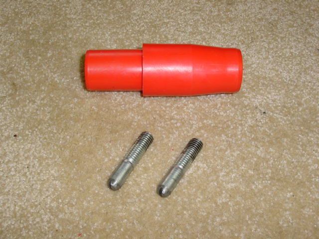

Here's what I use when installing a transmission - the two guide studs for the two upper trans-to-bellhousing holes are 1/2" x 13 bolts with the heads cut off, rounded, and a saw cut added to help remove them with a flat-bladed screwdriver. The orange plastic plug seals the output shaft at the seal to prevent dribbling any of that smelly gear lube while you're wrestling with the transmission.

I've done it your way in the past with a homemade transmission jack and long bolts. I'll do it again if I can't mate my new engine up with the bellhousing attached to the transmission. I just was looking for a different way without taking all the bull off the transmission The shop manual also mentions leaving the tranny in. I'm 70 years old and the garage floor gets a little cold for this old boy. Thank you for posting friend
