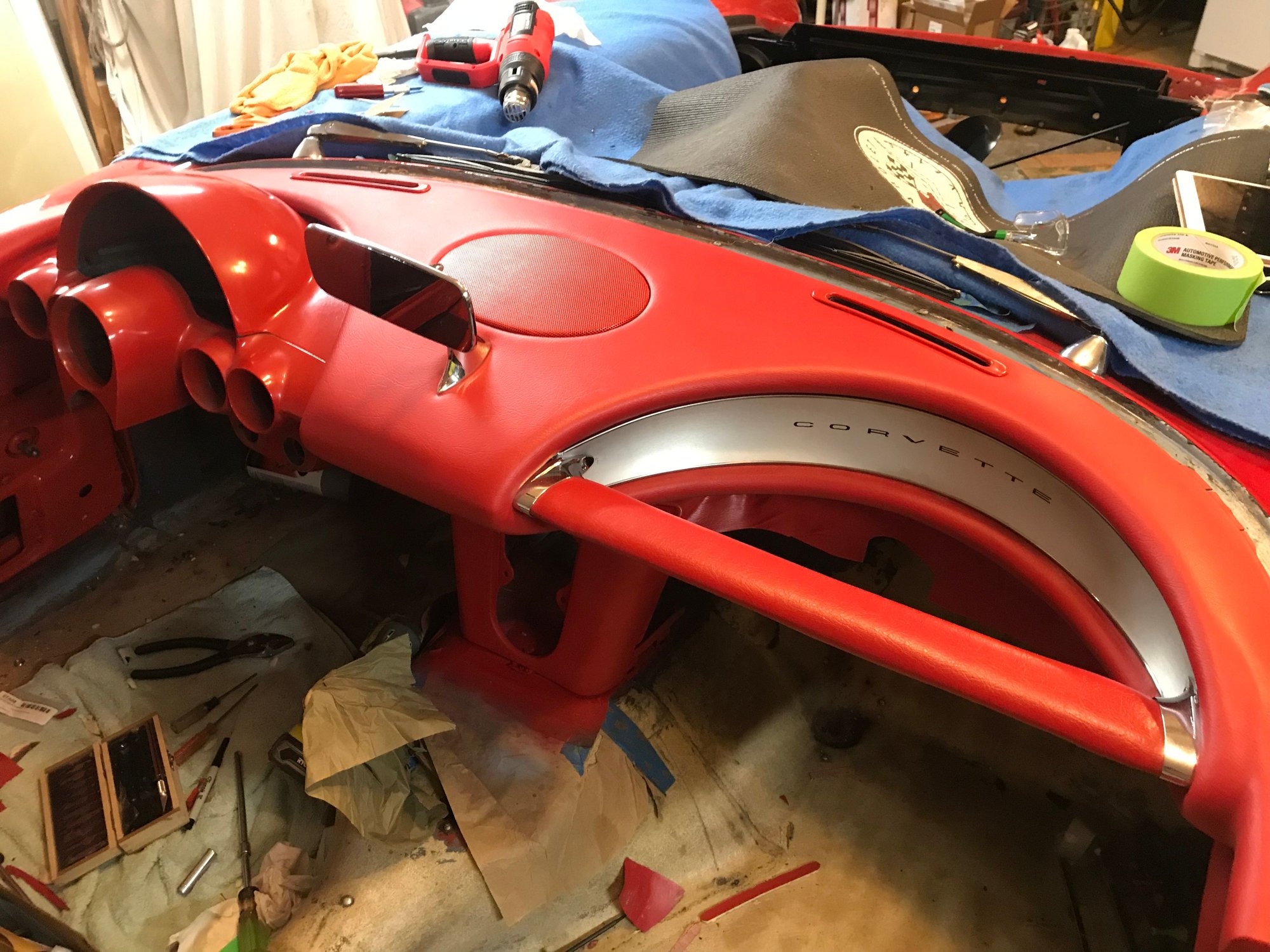

Here is my recently completed 59 without the bezel. Rich Mozzetta (Rich5962) has some very informative posts and PDF instructional documents that help guide the way. Rich advised to bond the speaker bolts to the dash and mount the speaker screen Between the dash and dash pad which is what I did. Here is a thread with the reference.
https://www.corvetteforum.com/forums...s-my-mess.html
