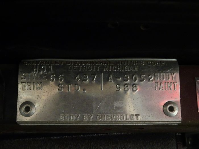

There is no mythical registry that holds all the answers your seeking. The price is fair for what it is as long as the frame and bird cage is rust free. If the car has a real 66 427 block that is closely dated to the car then you can feel a little better about it.
Old Jan 4, 2020 | 06:41 PM
856666's Avatar
856666
Joined: Jan 2013
Posts: 1,772
Likes: 196
From: Asheville NC
I agree and a professional should inspect the car before completing the purchase.

Aurel's Avatar
Aurel
Joined: Jan 2020
Posts: 16
There was an expertise for the auction, please send pictures below
Thks a lot !
