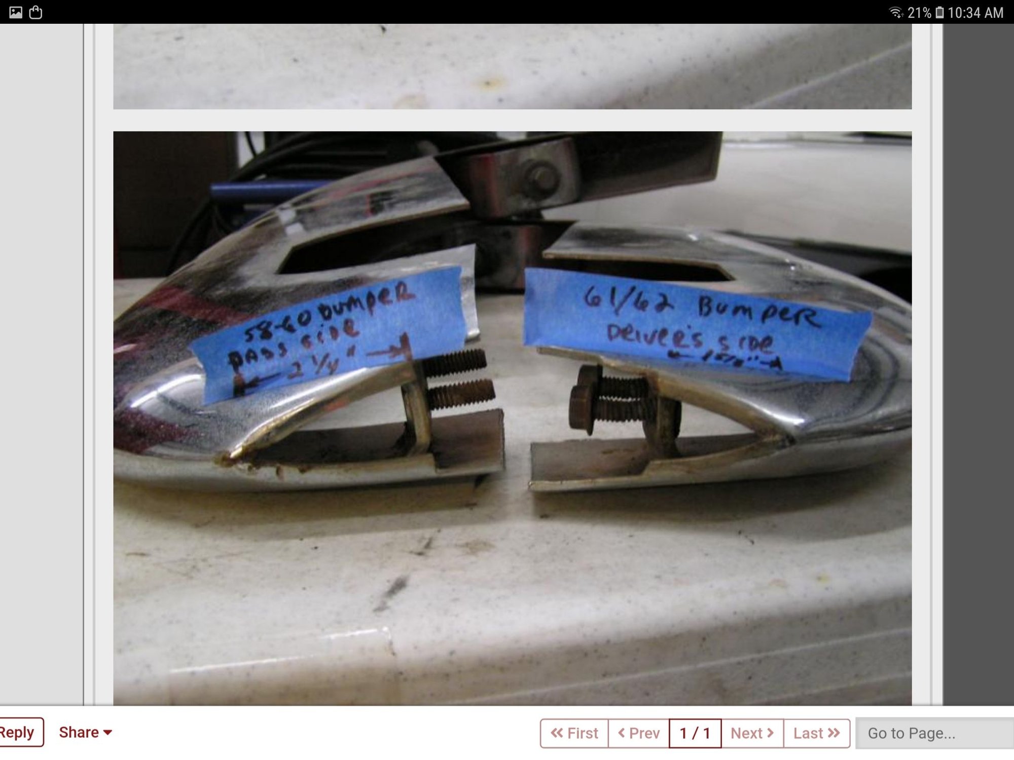

The difference I can see between these two bumpers is pretty slight.... almost not enough to notice:

The welded on bracket for attaching the grill bar is located about 3/4" more forward on the '61/'62 bumpers.
If one were to install '61/'62 bumpers on a '58-'60, the grill bar and teeth would stick out of the surrounding chrome rather prominently.
This is correct. There is NO difference in the side angle. The bumpers came from the same molds, with the difference being the welding of the cross bar brace. The wheel wells on a 58-60 are exactly the same

I accidently posted to the old thread while reading this thread. I posted that the 58-60 tapered edge profile is the quickest way to recognize the difference. I have one of each and no way they came from the same mold to me? And, yes, the offset is about 3/4".
Could you please post a pic.

Photos within the hour.

First, I am not going to argue with Mike who is always right. So, it might have been same mold but they maybe machined top edge out to the end resulting in the 58-60 being a little more tapered. But, this very slight taper will identify an original 58-60 bumper very quickly. And, the only other difference would have been where GM welded the grille bar support bracket. which turns out to be about 3/4" different between the 58-60 and 61-62. Like all other part changes, it might be possible that some very early 60 cars were built with 58-60 bumpers or some very late 60 cars were built with 61-62 style bumpers. Doubt that they ever mixed having one of each them though!

I think what Doug is talking about is the angle of the end of the bumper when you look at the car from the side following the wheel well. The wheel well on a 58 through 60 car is exactly the same size dimensionally as a 61 through 62 car. The circumference is the same, therefore the bumper end would have the same finish, or angle. I just went through all of my judging manuals, all of my restoration books, and I did a search on the NCRS site for C1 Bumpers and can’t find any differences other than the weld position of the license bar. I think it’s a myth.

A sideways view of the first pic would show the bulge quite distinctly. You can see it's there in the pic you showed, by the light reflection, but i know what i am looking for. I got my old LF bumper off a wrecked '58 car in 1974, and never paid much attention to the diffs until I went to put center cross bar on circa 2005 and noticed the diffs, then saw the end diffs as others pointed them out to me at that time. I can spot an ORIGINAL '58-'60 bumper from 30 feet at a car show. There are LOT of early cars with service replacement bumpers that have teh later profile that are touted as original.
Edit, that flat angled edge is not flat on original early bumpers, it has a curve in it. You can see it in the light reflection in the pic above. Maybe it was '58 only, maybe it was all '58-'60, but it is different.

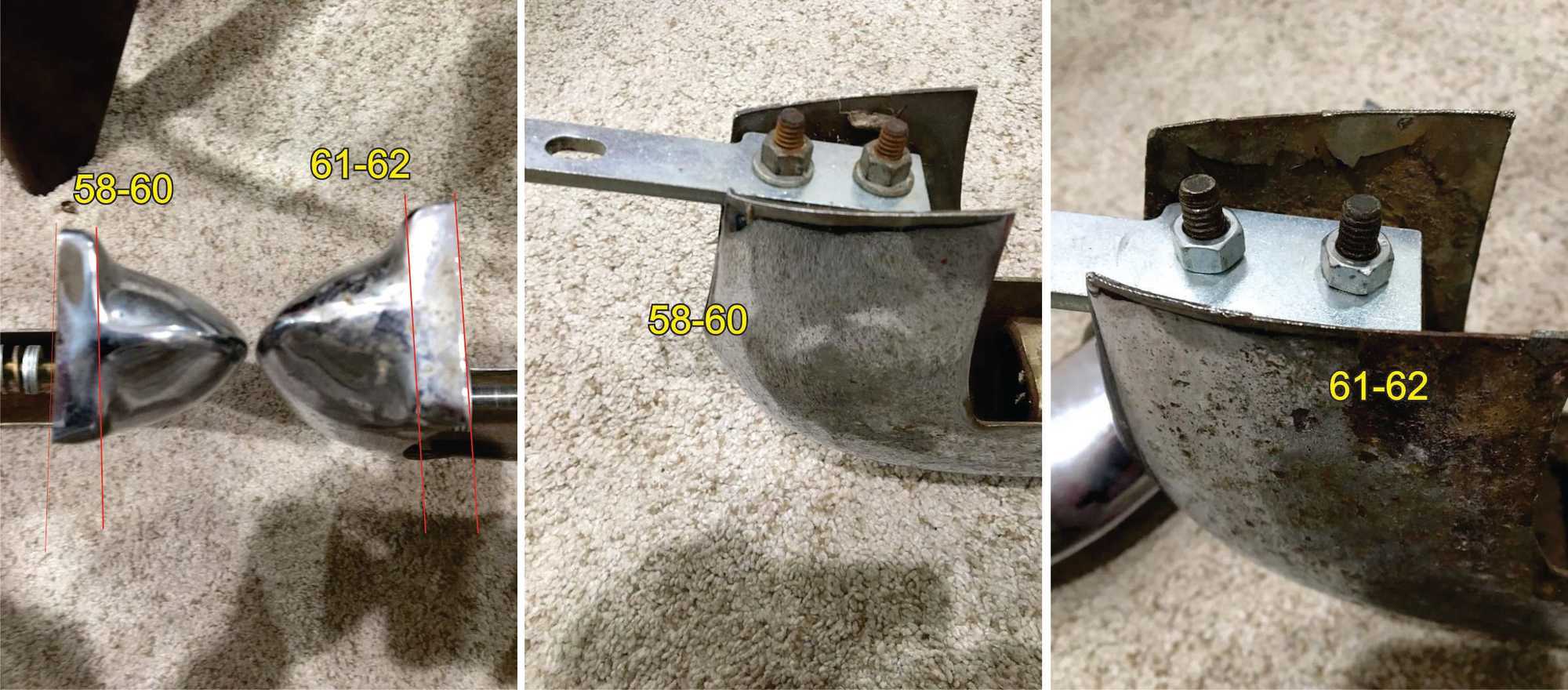

I do not remember who posted this but it clearly shows the difference between them.
Joe
