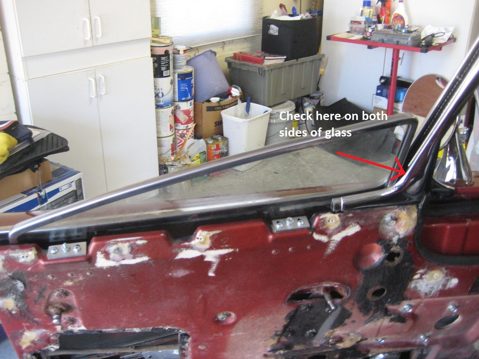

The window "stops" are dime sized metal round, adjustable, "stand offs" with a rubber cap....C1 windows are pretty famous for catching on those when operating the window if they aren't adjusted precisely... Windows can also "grab" on the front garnish tubing if its folding into the channel. Finally there is a felt "runner" down the back channel of each window that can "roll up" and cause flaky operation.
The pinch point discussed above along with the two metal brackets that hold the window stops on the horizontal upper ledge of the door are show here..without the rubber caps...
Most times its the rearmost stop that causes problems.
