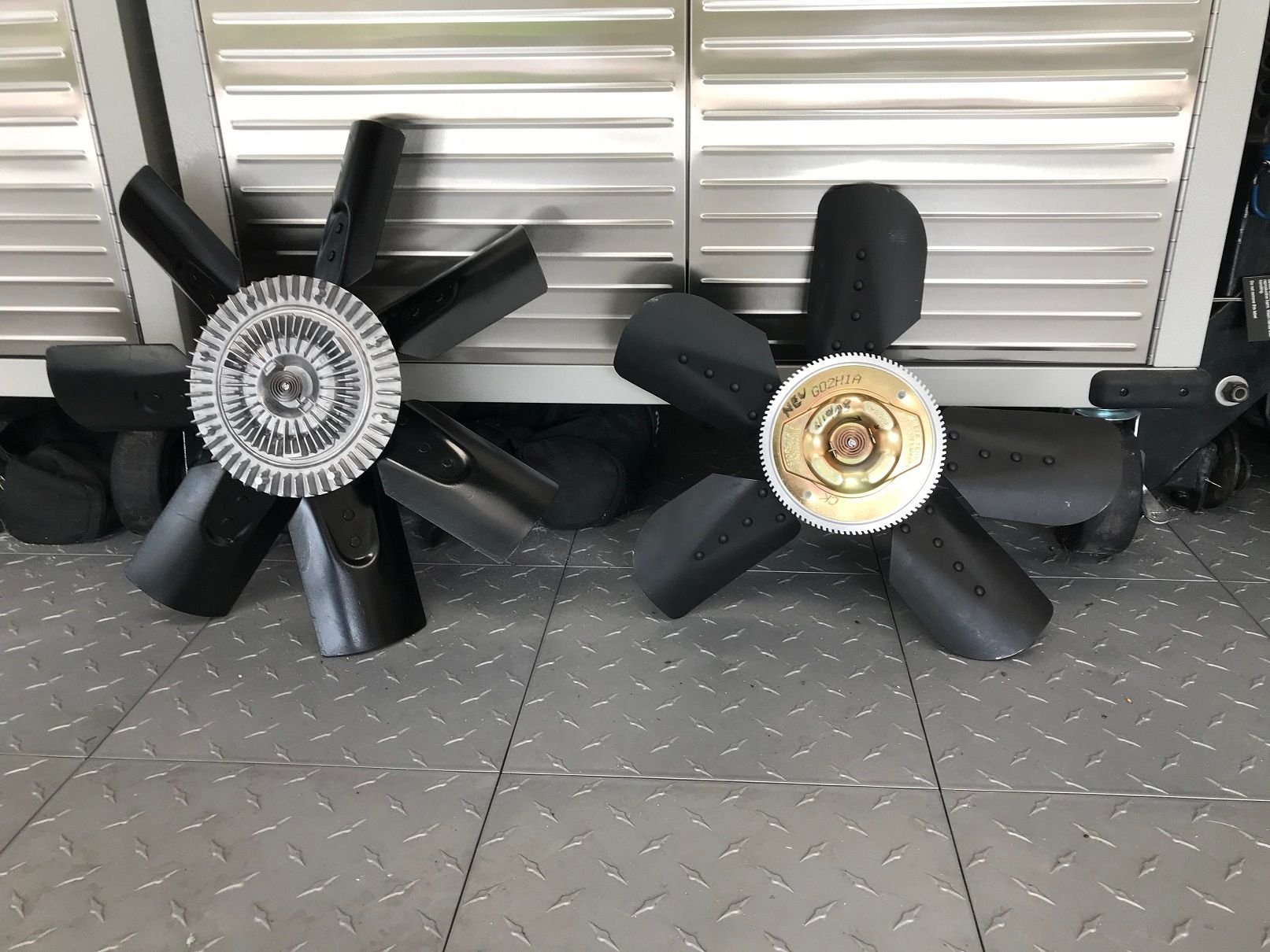

Well - for one thing your fan clutch is shot; per the top rebuilder of fan clutches:
I run a 63 with Vintage Air that I added withOUT electric fans and the car never hits 190*...completely stock engine with an original "608" water pump
I don't know what a "cold case" radiator is, I have a DeWitts but had the original radiator for a while and neither was a problem...

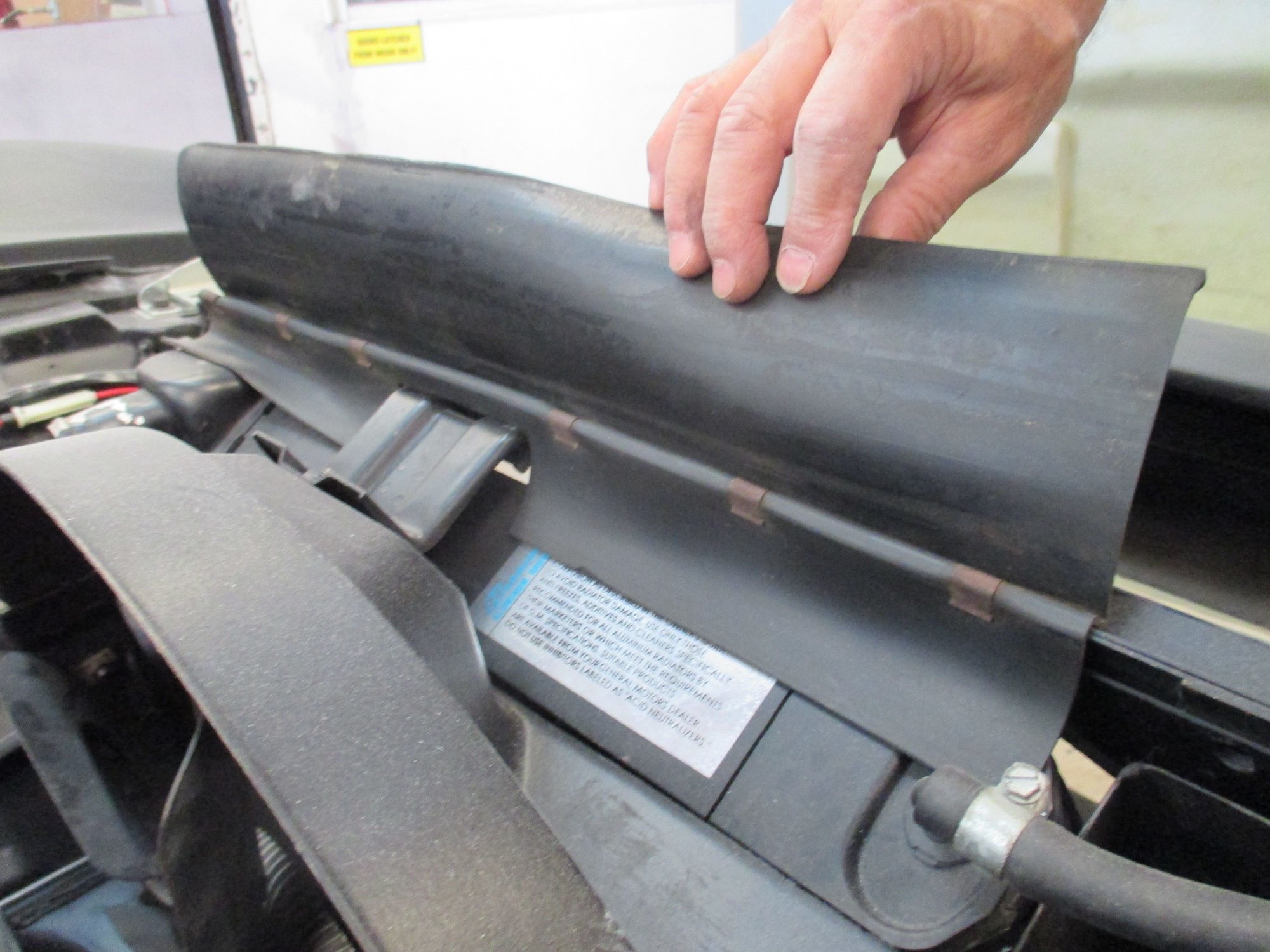

I run a 2747 Hayden heavy duty fan clutch and a BB 7-blade fan (on the left in the picture) and also have the '67 A/C rubber flap along the top of the radiator which helps direct air flow...it'll fit on any midyear with some trimming.

The clutch is a new one from K&B. I haven't called them yet because its late Saturday, tomorrow Sunday. Probably have to start there. Also I have the flap on the top of the radiator. Its pretty well sealed.. To Frankie........I have an Old Air Ac with the OEM A6 compressor

Radiator needs bottom seal as well. Also a lower fan shroud extension. Both were furnished with factory AC cars.

Get a better fan clutch that works. Frankie's Hayden clutch and 7 blade fan is a great setup.

Large 7 blade fans for the Hayden are around. Classic Industries and others have them. Prob Summit and Jegs too.

Use Frankie's combination of clutch and blade. You NEED maximum air flow at low RPM or idle. So find a way to get it. Another fan blade won't be the end of the world regarding $$.
