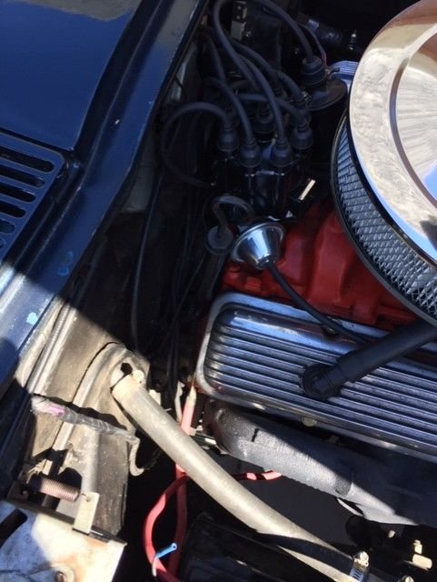

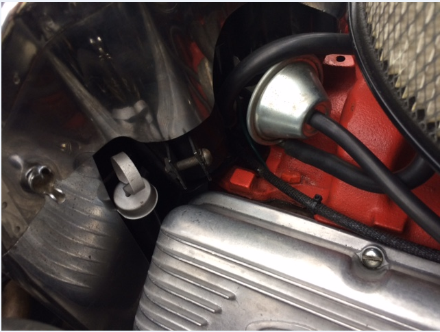

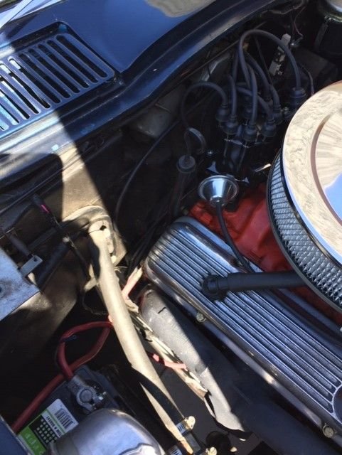

Old Apr 27, 2020 | 09:32 AM
  #44
Zanny1's Avatar
Zanny1
Joined: May 2019
Posts: 560
Likes: 261
From: Fountain Hills (Phoenix) AZ
Here's a picture of the dipstick location on my '65. I can't give you a part number as I don't have that information.
Nothing fancy about this setup.... and no clearance problems at all.
Old Apr 27, 2020 | 03:09 PM
  #45
3154tm's Avatar
3154tm
Joined: Nov 2017
Posts: 779
Likes: 112
From: Redneck Riviera, FL
thanks mr. P, i've ordered this one and have fingers crossed.
https://www.assaultracing.com/item/4...dipstick-black
