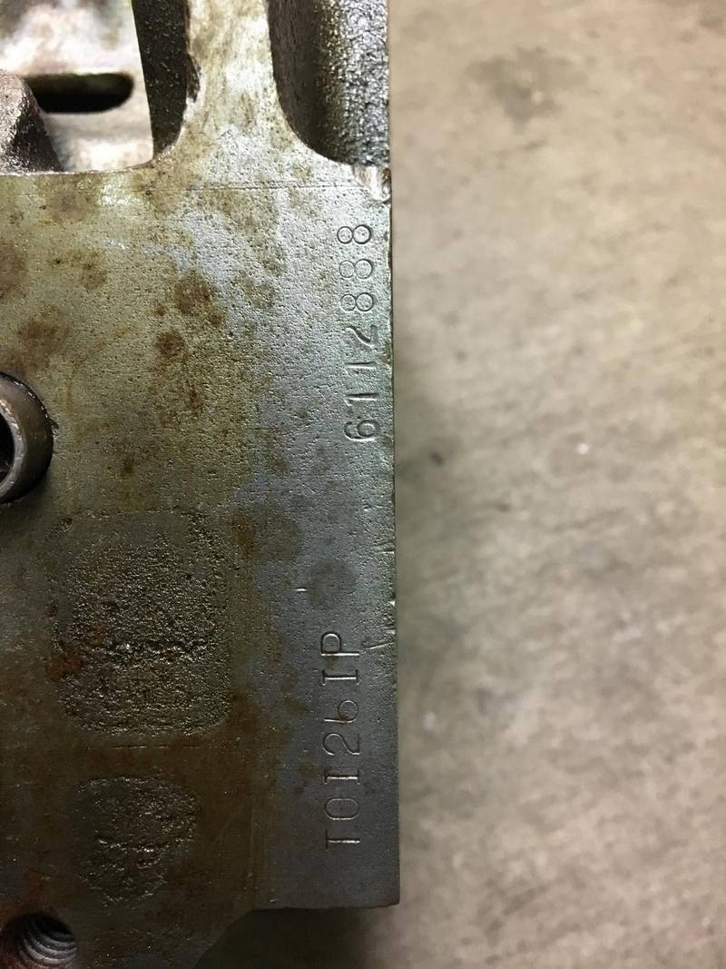

A couple of interesting findings when searching for something to buy.
I find this '66 block for sale on Hemmings website.
As you can see it has a vin# on it.
So with not much to do this afternoon I google the vin# and find this on the C2 Registry

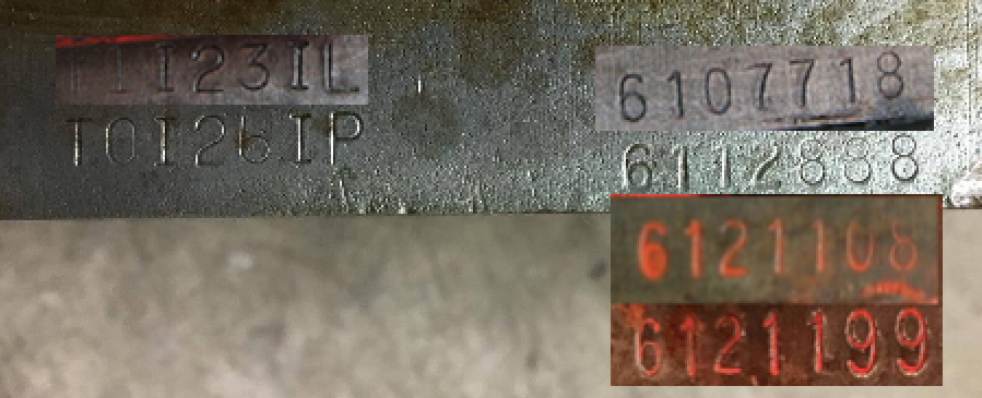

Something a little strange there. The total length of the VIN stamp group of characters is just about the same as the length of the engine Tonawanda stamp characters.
Using math, the Tonawanda package should be just under 1 1/4". (1.228") The VIN package should be just a bit over one inch. (1.015")
The image in the AD is much larger than the real dimension so the difference would be even greater.
Maybe it's just the angle of the camera that makes it look that way because it does look real other than the length. There's even rust in the characters of the VIN stamp.

This block might be the fake one. It looks like the 6 1 1 & 2 were stamped individually and then the 888 together which tails away. 6 and 2 are crooked. I’m not an expert, just curious and trying to figure out why a fake block would appear.
Who would go through the trouble to fake this block? The angles of the pictures are not the same and my attempt to resize the stamps to approximate the same size is not perfect admittedly but this stamp's characters looks pretty good to me. I'd like to see the stamp that is on the engine in the '66 in question.

Originally Posted by KingRat
Who would go through the trouble to fake this block? The angles of the pictures are not the same and my trying to resize the stamps to approximate the same size is not perfect admittedly but this stamp's characters looks pretty good to me. I'd like to see the stamp that is on the engine in the '66 in question.
Pretty convincing to me. I bet the stamp that's in it now bears no resemblance to your examples.
